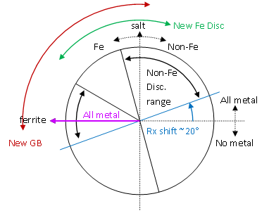

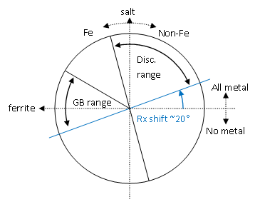

          • I intend to make one more run on the IGSL mods to make this rig capable of beach hunting. It requires separation of all-metal and ground balance functions. As there are 2 GB channels in IGSL, of which each one can assume one of this functions, the only thing to worry about are phase shifters.
            I already played with some advanced phase shifting approaches and posted results at LF project topic. Yesterday I revisited the phase shifting circuitry of IGSL to find that Fe channel lacks regulation span to make it more meaningful. I'm using Fe discrimination at almost the end-position of a potentiometer, and currently it is the position that makes most sense.
            Current ranges of regulation are shown in the picture. Both Non-Fe and Fe discrimination ranges share the same span. Many things rely on a phase shift that is achieved in Rx front end that is tuned such that Rx coil resonance is above Tx.
Name:	IGSL phases.png
            By looking at the picture it is almost obvious that for proper Fe channel operation a tuning range for Fe discrimination must go more to the left, and certainly not that deep into non-Fe range.
            It is also almost obvious that the current solution for GB can't possibly reach salts phase, and the lower side is dependent upon the Rx phase shift.
            Good news is that all of these shortcomings are possible to fix using the existing chips, and their current layout, with only a few components added on the solder side of PCB-s. For that purpose I'll have to re-introduce the U12 chip (LF351), but with no major changes on it's PCB layout.
            The following picture shows my intentions:
            a) The existing GB will turn into an all metal channel to provide accurate reference for discrimination. It must remain aligned to the ferrites regardless of ground conditions. violet
            b) Next, the Fe discrimination will get rotated to the left where it belongs. It will enable notching of stainless steel, foil and nickels as well. green
            c) And the most important, new GB that spans between ferrites and salts to make this rig perform well on all terrains. red
Name:	IGSL phases new.png

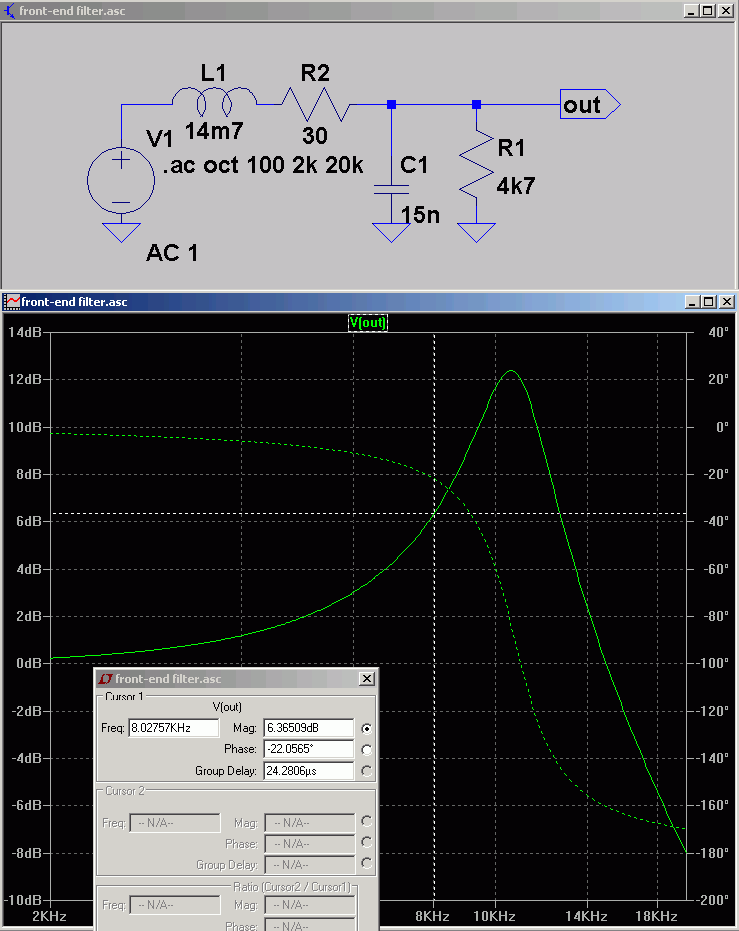

                        • Hi,
                          as preamplifier I use LM833N ( input noise (~4.5nV/sqrt(Hz)). My IGSL Musketeer looks very sensitive to 50 Hz interference. I did not understand it. I thought, that Rx parallel LC ( 15nF II 14.7mH )is band pass filter 10.8 kHz, which damps 50Hz and some higher frequencies ( higher than 10.8 kHz ) . For me, it is little bit difficult to understand, that it is not band pass. Can you draw equivalent circuit of parallel LC tank ? Is the solution to add notch filter after Rx preamplifier ?
                          This night I will connect Tx coil directly to clear sine external oscillator and than I will measure Rx preamflifier output.
                          • When drawn properly, it becomes quite obvious. L-topology transforms input impedance, and in this particular example you have twice the input voltage and in effect half the noise. Only trouble is that 4k7 gives twice the noise of a LM833/NE5532 4nV/sqrt(Hz) op amp, which in effect defeats whole purpose of the exercise.
                            Draw your own conclusions. Here is a simulation...
