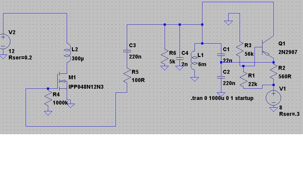

        • Also, has anybody boosted the Tx with a linear amplifer.
          Or pulsed a coil using the Tx oxc as a clock source,, a bit like this..
                Check the thread where Habitbraker and I were discussing simple circuits for driving the Tx coil by pulsing it with some kind of oscillator.
                My list of unfinished projects includes one attempting to use a Texas Instruments MSP430 microcontroller to generate the oscillator pulse and maybe do some primitive detection, trying to use as little analog components as possible.
                Our preliminary tests seemed to show that with a good resonant circuit, the Tx coil could be driven to much higher voltages/currents than with the TGSL oscillator.
                However, that doesn't necessarily make it more useful for a metal detector, but seems promising. One of the drawbacks may be that the voltage/current in the coil will be more easily affected by soil conditions and make a less stable reference.
                Hope to get back to the project soon. The TI Launchpad is a neat, cheap experimenter board from TI.
                -SB

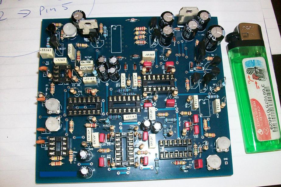

                            • after 6 hours of cooking :-)
                              Tnx to Silverdog sorry for the mix up ;-)
                              All to do is coils and housing and test test test tweak tweak tweak
                              To all who make this PCB and schematics and post it here CHEERS,keep up the good work.
                              Regarts Tepro
