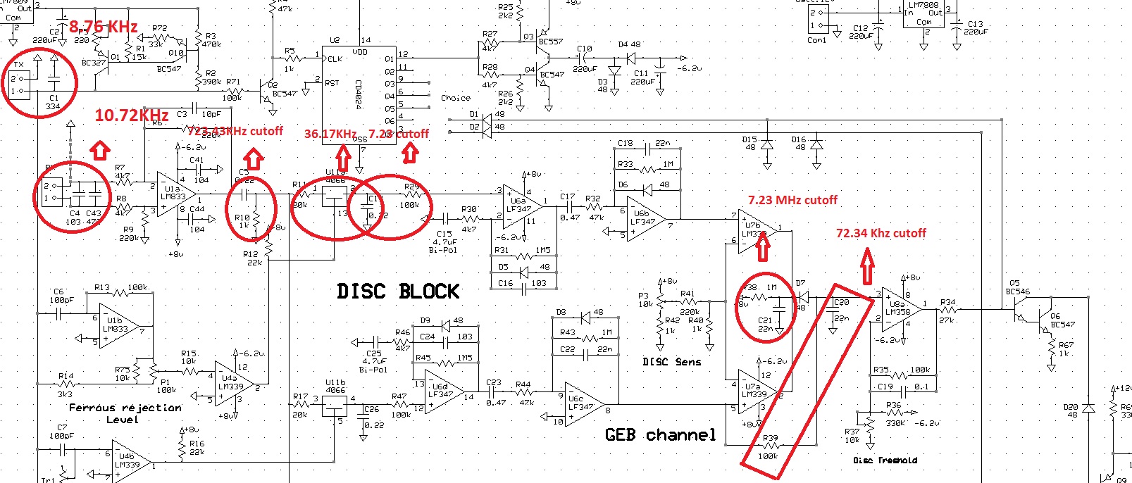

    • Last night i look a little in IGSL lowpass and highpass filters, and get some unexpected answers. This is just for one chanel for second is the same. I used this RC filter calculator http://www.ekswai.com/en_lowpass.htm
      Opinion? Answer? Conclusion?

        Tell us what you are thinking -- what is your intuition?
        I cannot easily think of those filters separately, but you have to think of the switch as a diode partly. When the switch is closed, all the filters combine; when opened, then just the combined filter on the left side is working.
        Don't pay any attention to R29 - it goes to high impedance input and is essentially infinite. When the switch is open, the capacitor holds its charge steady.
        -SB

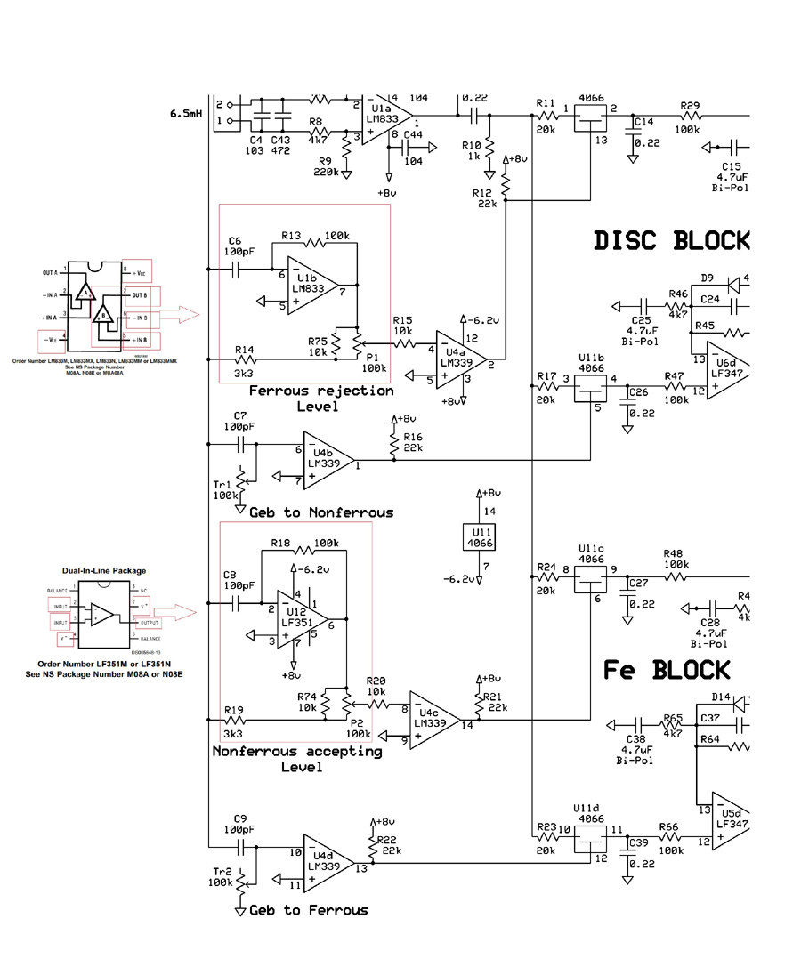

        • Hi guys,I looked at datasheets for LM833 and LF351 (U12) and noticed some differences, so i think that is better to use one more LM833 instead LF351. Of course pins have to be connected properly, take a look on a picture below. I planing to do this tomorrow so i would like the hear some opinions about this.
          Marko.
          • Originally posted by wallker View Post
            Marko.
            Would you tell us what the differences are between the LM833 and the LF351 that you think are important?
            -SB
            (attached picture easier for me to see)

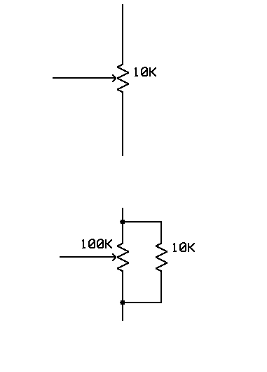

            • pot circuit question
              Is there any important difference between the two pot configurations shown?
              -SB
                -SB
                Take a look on both datasheets : http://www.ti.com/lit/ds/snosbh2/snosbh2.pdf http://www.ti.com/lit/ds/symlink/lm833-n.pdf
                Also i did notice slightly different sensitivity of ferrous channel (more sensitivity on non-ferrous channel) which I think is caused with LF351 (other parts are the same for both channels).
                Marko.
                  -SB
                  There is difference, look on picture. If you want to make sure yourself measure resistance with ohm meter.
                  Also you will get different output steps on middle pin of pot (I have had experience with this in practice).
                    -SB
                    Theoretically, there is a difference,.. total resistance will drop to (approx) 9 Kohms,.......
                    I find it hard to believe it will have any practical difference, {unless the wiper/slider connection was having to supply any appreciable level of current, which would be limited by the higher resistance of the track to wiper section,.....) As most feeds of this type are to high impedance FET or OPAMP inputs, I doubt if, in practice, you will notice any problems,........ but,maybe, buy a 10K pot???? Cheap enough from Silverdog!!
                    Cheers, Fred
                    • Originally posted by Comp View Post
                      Cheers, Fred
                      Yes, I was thinking why not just use a 10K pot in the IGSL circuits. (Main reason would be if you only have 100K pots handy I guess!) I like to get rid of any unnecessary parts on the board if possible.
                      -SB
                        As Fred says, as long as there is no load on the wiper, the voltage should vary same as a 9.1K pot. Should be same linearity, etc. I think a 10K pot would do fine in the IGSL circuit.
                        -SB
                          -SB
                          You are right about everything, except about linearity.

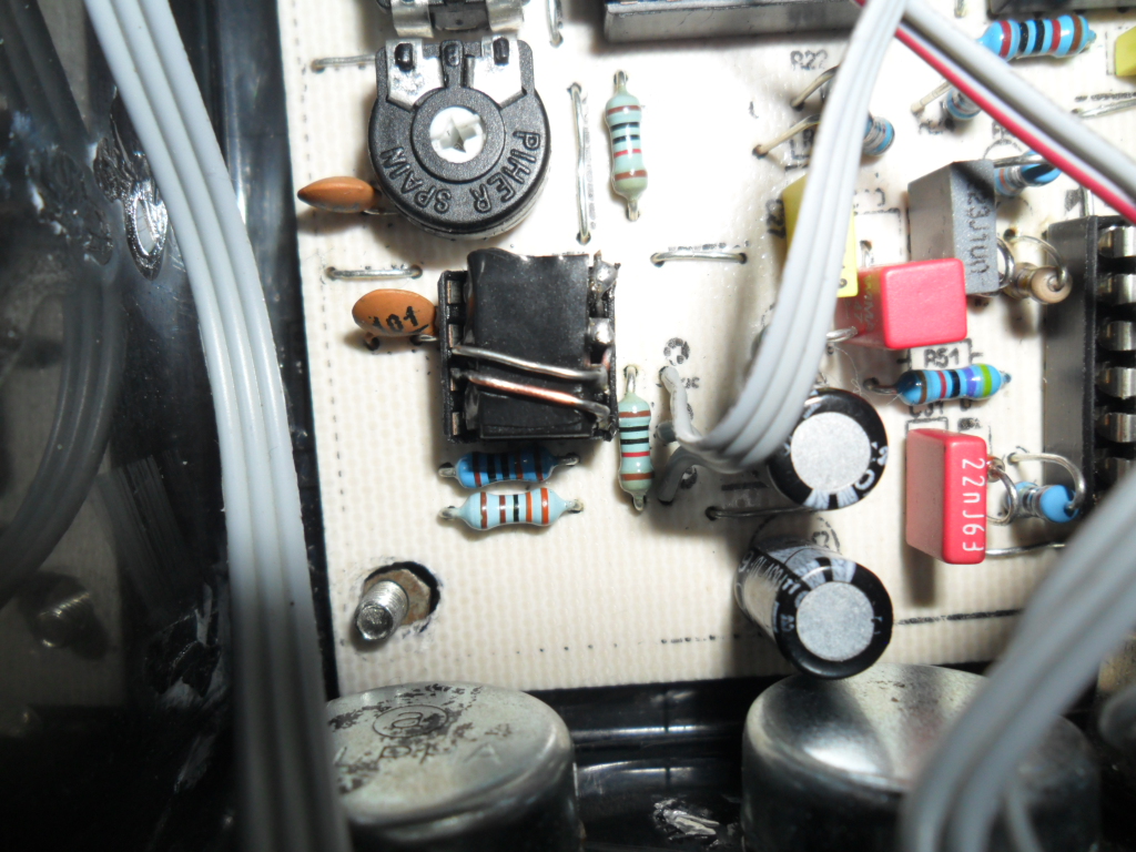

                          • Improvement
                            I just replaced LF351 with LM833 as i mentioned before, and i got improvement on sensitivity on Fe channel.
                            Also Disc. on this channel works better and both channels now have same amplification, which was my intension at first.
                            Picture in attachment shows connected LM833 without changing anything on PCB.
                            Regards Marko.
                              Why not linearity (assuming no significant current goes out the wiper)?
                              Can you explain?
                              -SB

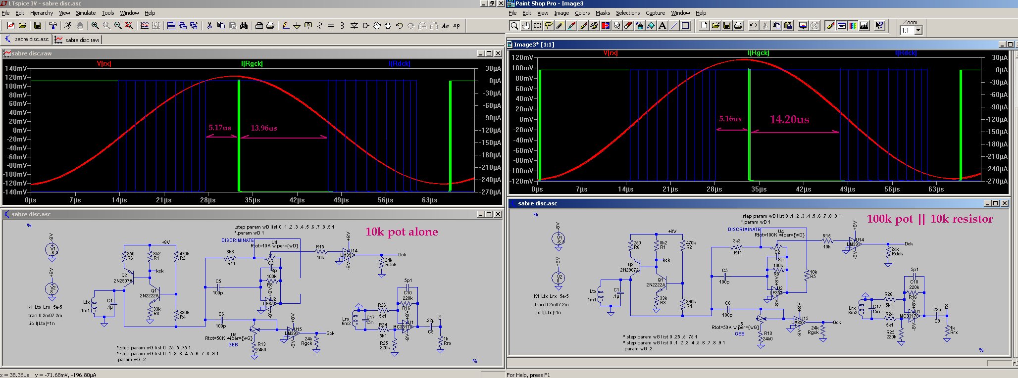

                              • Whether to use 10k pot, or parallel 10k fixed res with 100k pot? There is a very slight difference in overall response - oh about 2 degrees at the CW end but either way
                                looks like very good linearity.
                                You might say my simulation is invalid because as you can see I added a 3pF capacitor in the circuit. I don't think that having the inherent instability that is otherwise encountered
                                is a good idea. I think that using 3pF adds about one~two degrees of range at the CW end. In my experience, the disc ZCD waveform can be very erratic without that capacitor.
                                What I did is to use a linear potentiometer model and step the wiper position in eleven 10% increments, from 0% to 100%. These sims ran at ~15kHz.
