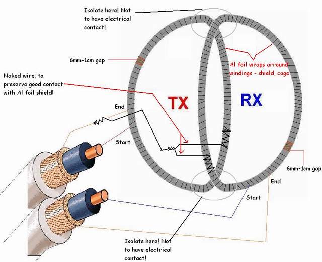

    Both "D" shaped coils are shielded with Faraday cage. Both cages are connected together to TX ground lead (in coil) .
    Cable from coil to detector is double coaxial (as on original TS coils).
    Rx leads are "hot" and "shield" - but that "shield" is not connected with main GND (shields) in coil housing.
    Also RX "shield" is not connected on pcb gnd - it is connected just to inverting input of LM833.

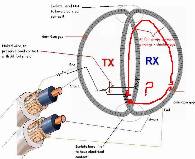

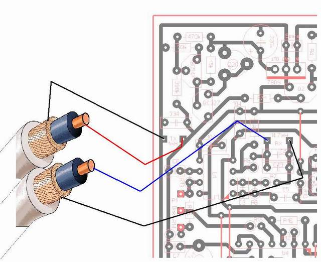

      if the decision falls to musketeer coil- is anyone able to post guide for coil wiring
      (like tgsl coil making) with nice shematic (picture) ? plz
        hello
        Something like this...
        • And; PCB side....
          • nice drawings many thanks

                    Good day Ivkoni. I want to ask does it matter where you turn on the monitor and had to symmetrical to the Faraday shield. Faraday shield the receiving coil is not symmetrical with inclusion. Thank you! Good day Sorry for bad English
                    • Originally posted by nejdet View Post
                      It doesn't matter. You may place inclusion, gaps and naked wire wherever you want. Wherever is convenient to you - you place it. It will not affect performances...

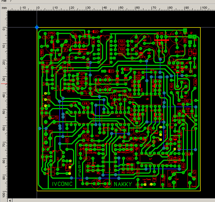

                          • My 2 cents.
                            Because Ivconic is back on the Forum.
                            10x10 cm.
                            Not checked.
                            • Hi Nakky,
                              firstly it looks very, very good. Thanks.
                              May I ask you a couple of questions?
                              1) I always feel its a good idea to put a version number on each and every PCB I ever made. In this case its a "Nakky", but if further changes are made, then I personally do see the need to add a version, "Nakky 2.0" for example for the next one etc.. This was something I was going to mention to any of us here making changes and corrections to Ivconics PCBs, but neglected to say up to now.....
                              It also helps dramatically when trying to help someone to fault find online when you cannot see which PCB they are using....
                              2) How were you able to do this as as far as I am aware, Ivconic has not yet published the final versions of the schematic (either one and I know from personal experience that the one available online is way out of date, or did you just take one up to date PCB and move stuff around till it fitted? (Been there done that!!)
                              3) Which version of the two current ones is this? Or should I say, for which coils? Or have you taken up my idea for a dual PCB with places for either components, which appeals to me personally as "why should I be forced to one or another coil when populating the PCB?" or even we should think to spare Silverdog the need to make two versions, but I think I am the only one who has any interest in that direction - sadly! But I hope SilverDog picks up on my idea!!
                              HEY SILVERDOG SAY SOMETHING!!!
                              4) My compliments on achieving the size of 10 x 10 cm PCB, that is very important (I am told by S-D) for the price that he will need to charge, so that was a very important fix. Sadly I don't have the Abacom software as I prefer and have Eagle from Cadsoft which is not compatible at all.
                              5) I would also like to point out that probably the names "Nakky" and "Ivconic" on the PCB are probably spelt backwards as they are on the green layer (copper), which is the bottom copper layer and when viewed from the top, should be reversed. ISGL on the same layer appears correctly backwards and is also in Green. I cannot prove that completely as you have not posted a PCB, but an image of the PCB only. I would imagine its designed as a single sided one as there are wire links usually....
                              Nakky, we don't know each other well (I hope that that will change!), but as with most people on the "trail" of the Ivconic Metal Detectors here, you are a great asset. From me personally, to you and all the rest, many, many thanks!
                              Andy
                              • I just also noticed that it appears that you didn't correct the various "Yellow" solder pads that should be changed to the lower (green) level either, you probably didn't notice them, but they are on the same level as the wire links if I remember correctly....
                                Perhaps Ivconic has some special reason to have them where they are?
