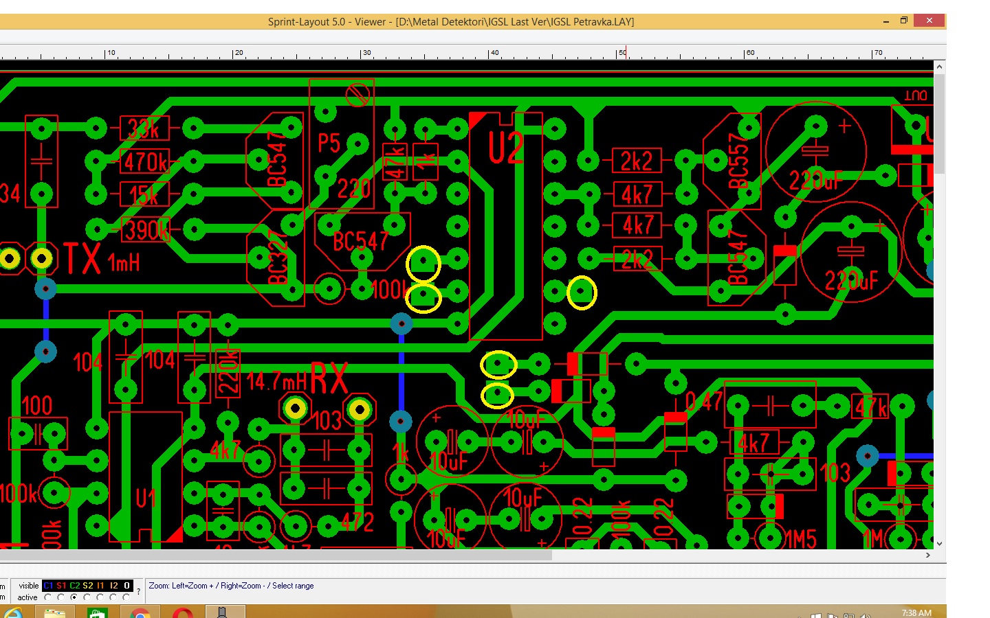

        • Can somebody explain me connection for those yelow marked holes? Thank's
          • it is for tone selection
            one channel for low tone (iron)
            second mid or high tone - youn can choose which (non-iron)
            if you learn how to adjust you can swith tone for every type of metal
              https://www.youtube.com/watch?v=3SPuarDiRds

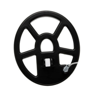

                      I can't tell for sure, because i never had chance to test it with one of those coils.
                      But i think that smaller diameter coil shall give better results, em flux is "condensed" and more "focused" through the smaller diameter, especially at "low power" detector as IGSL is.
                      I know TS1000 is obsolete and hard to obtain; pity, it was most versatile coil that i have seen so far. I have used it on several different detectors with great success. It is also pretty tolerant.
                      Smaller "sister" of TS1000 is TS800, maybe it will also give good results on such targets.
                      And third one i used is Tesoro Delta 9x8 concentric coil, usually coming with Tesoro Tejon and Vaquero, this one
