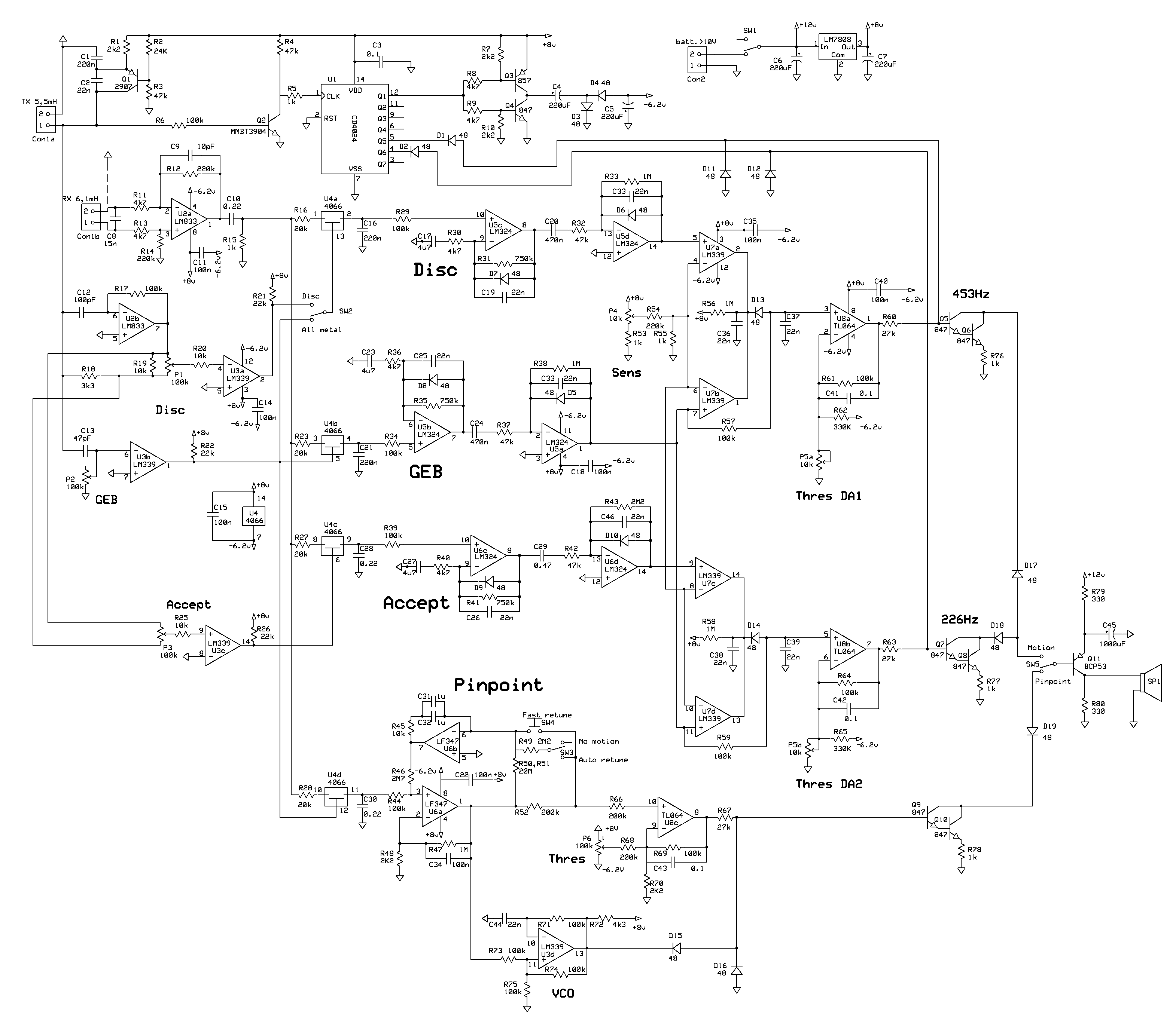

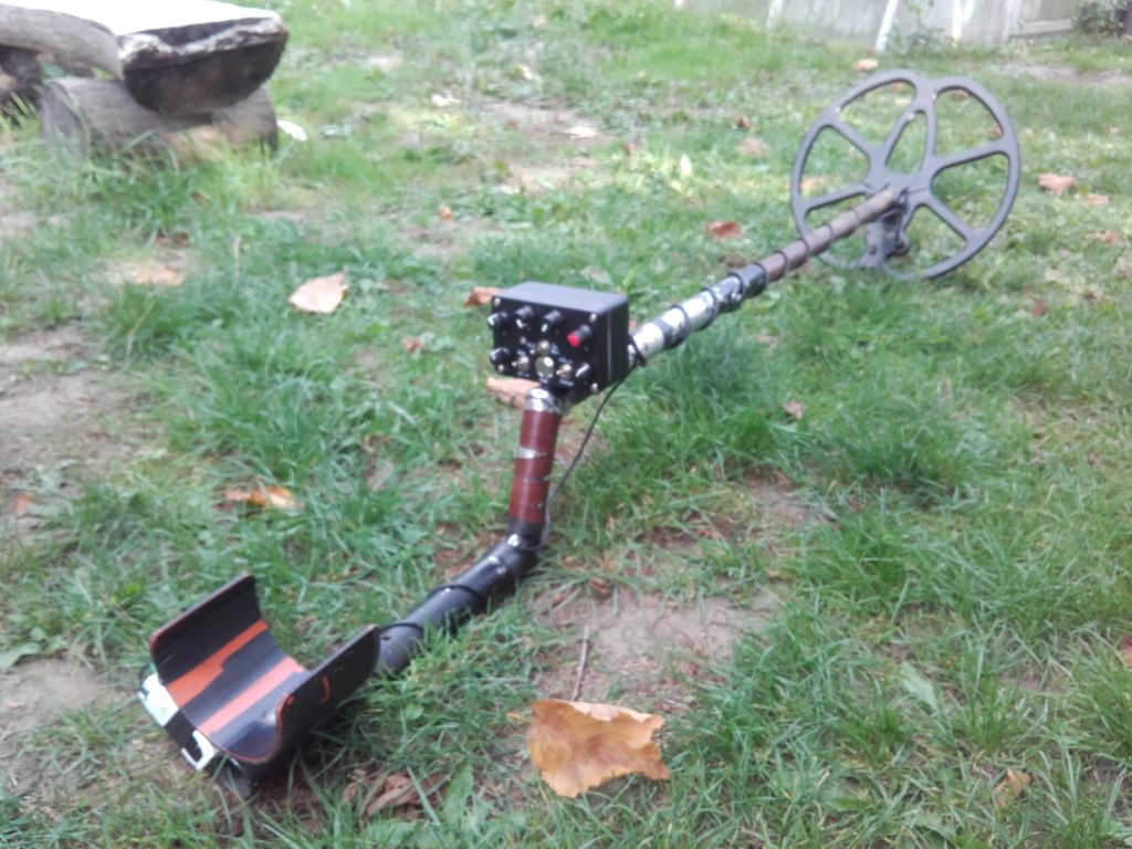

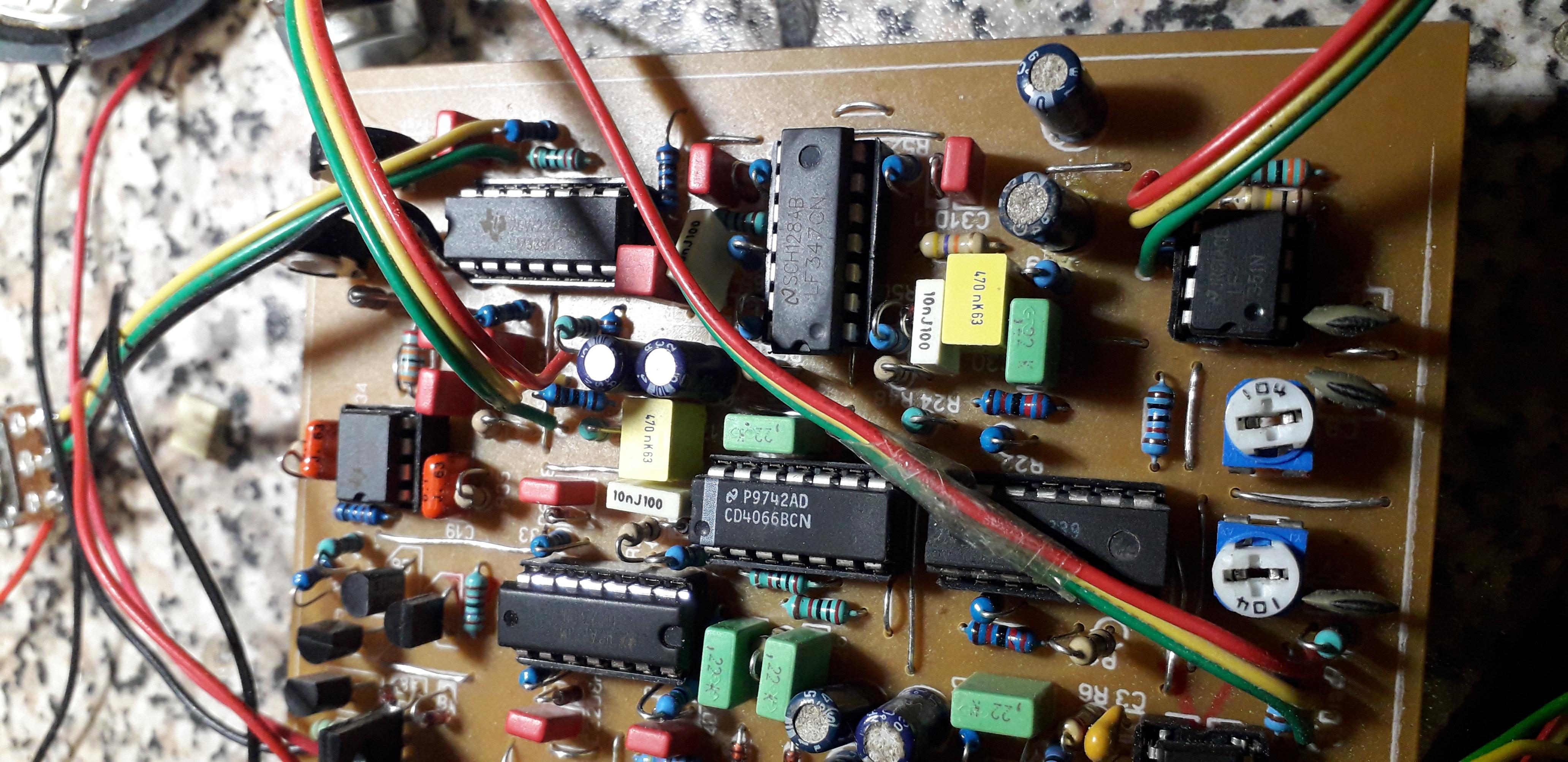

I installed a TL071 chip (LF356 stood), everything worked perfectly, metals are cut off-cut out! Many thanks personally Hyena. But I have one question on GEB black and GEB of non-ferrous metals according to the scheme and the assembly drawing are trimmed variable resistors, with a different kind of soil-sand, clay, chernozem-rebuilt GUARANTEED from the ground is not necessary ??? If it was necessary to detune from a particular ground regulators had to be taken out to the control panel ???

mainly in 0805 SMD
