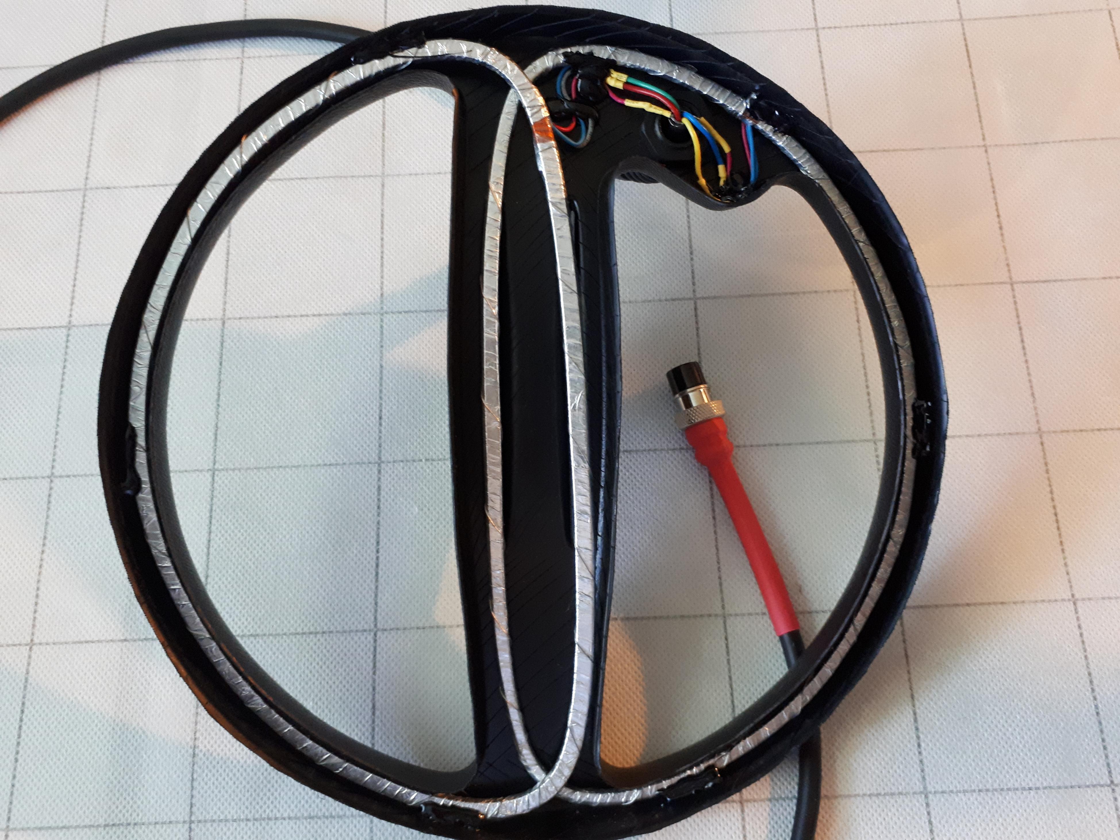

  • I returned from the hospital after the infarction and immediately to the computer ... Thank you very much for the tips. Last time I forgot to put the sensor photo, with the data that I wrote before the imbalance was 40 mv. I'll try with Тх-14,5кгц, and Рх 16.12 kHz ... I really like the voice of the goals! I'll still finish it !!!Click image for larger version
    • guys
      again and again i reminder you. again and again. both shieldings must NOT be touched together one-to-one.
      another way you get ELECTRIC ring closed EMI field. SPLIT THEM by izolation.
      do not do me angry guys. do not do.
      • The coils are isolated from each other by transparent tape! Well, the output of the shields of the coils, naturally, is soldered to the screen of the cable, but how else?
        • Tx is 14.5kHz and Rx is 16.12kHz.-
          made a coil with such frequencies, the metal detector works very badly! It may be necessary on the contrary-the frequency Rx should be less than the frequency Tx ???

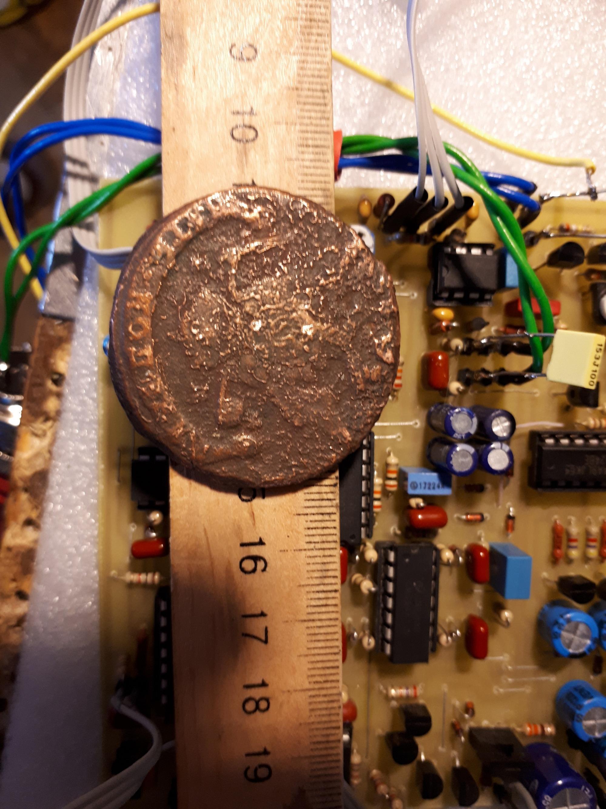

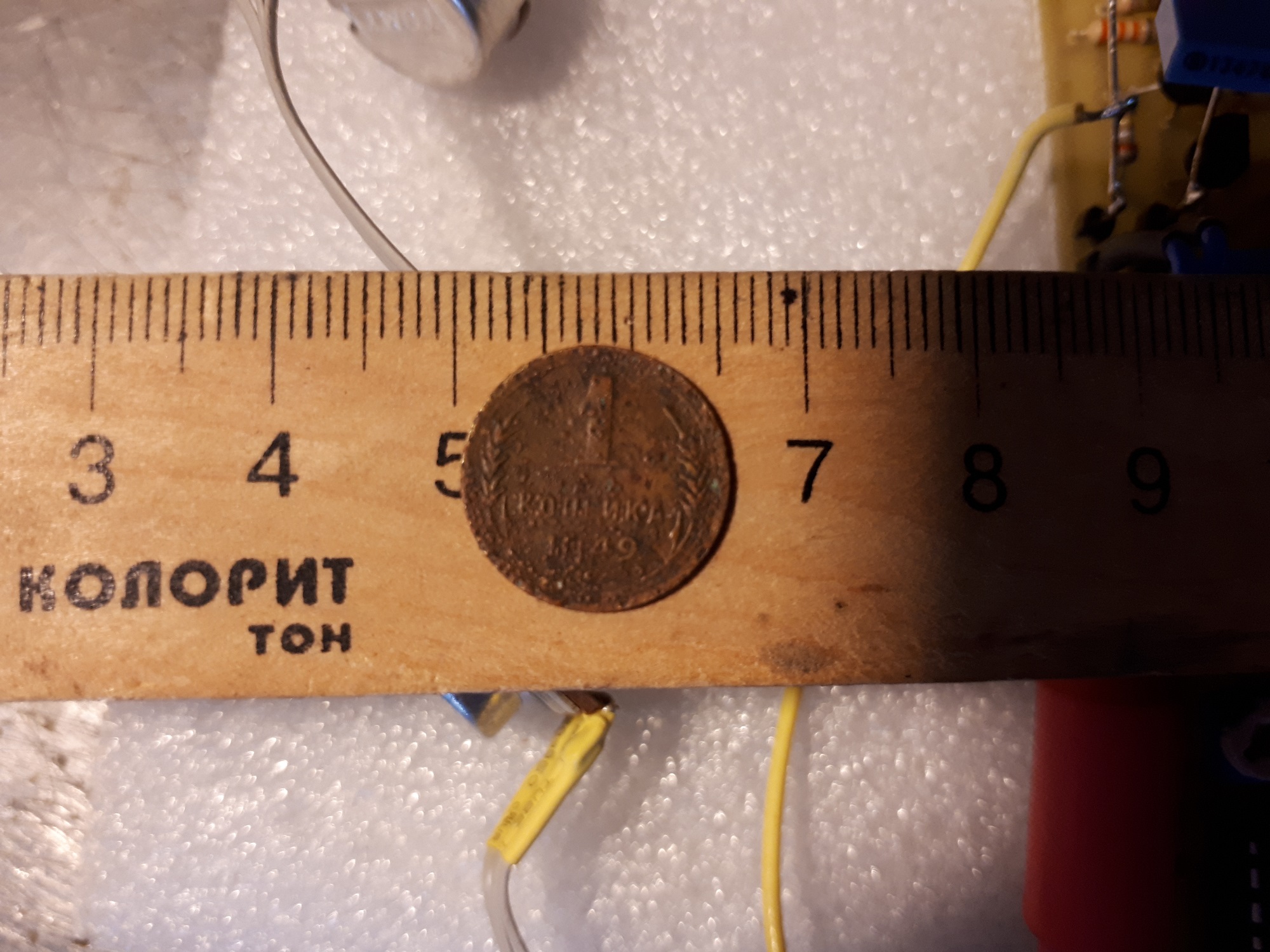

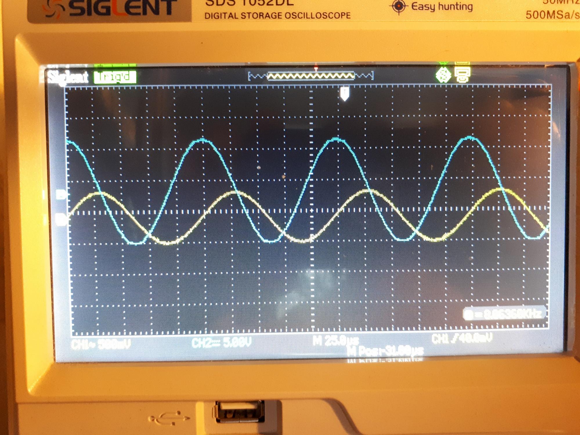

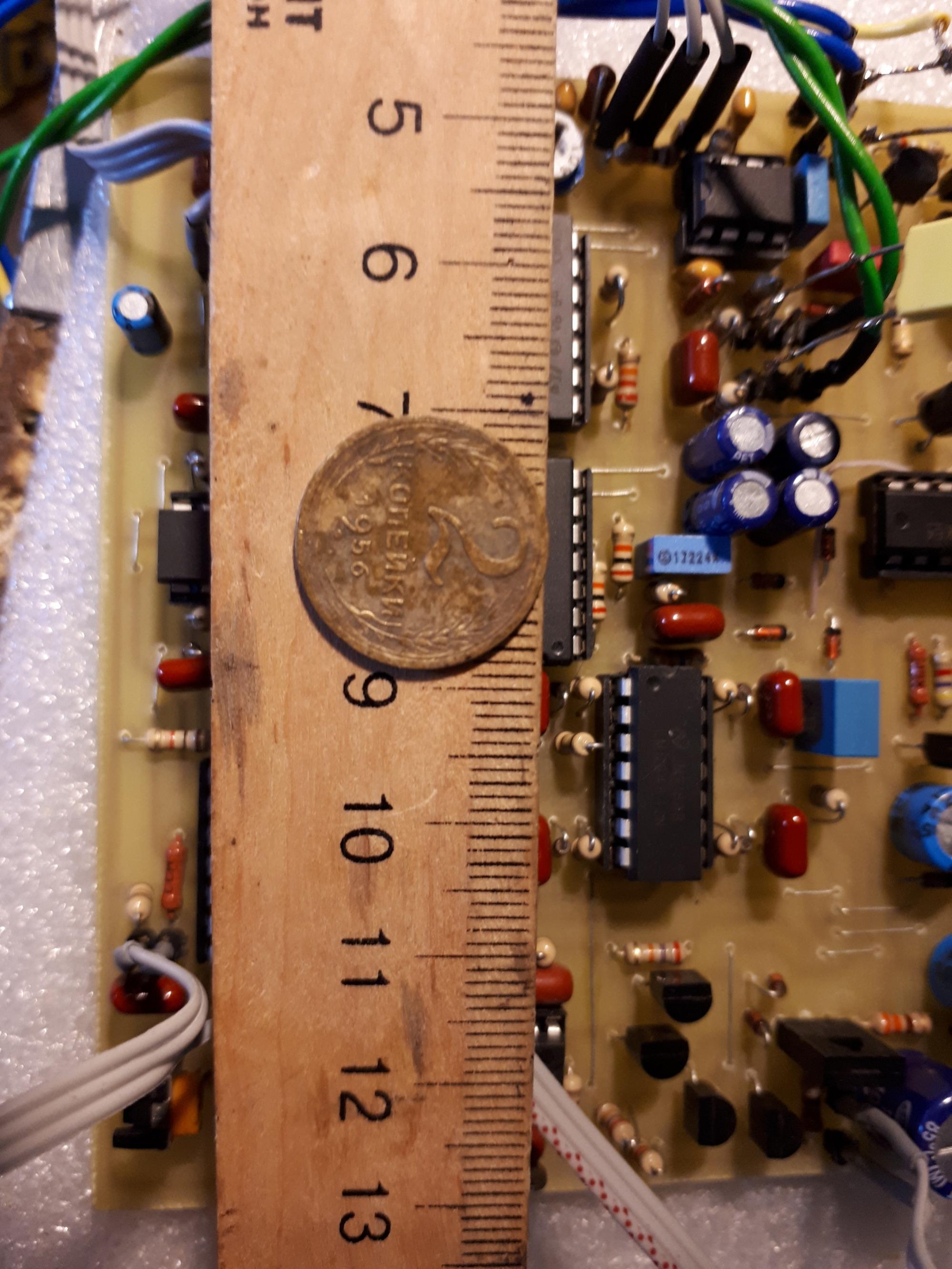

                            • Good afternoon! I collected the IGSL device, the range by air for coins: 1kop.-20cm; 2kop.-25cm; five inches of Catherine 2-32 cm, the signal is clear high-pitched, I cut the colored metal with the regulator, the black channel remains twisted, for some reason it is voiced low in tone, like black metal. It's still unclear, this metal detector does not see black metal of small metal ??? I offer ordinary pliers-see see at 5-7, somehow not that ... In the photo the blue sinusoid-Tx, somewhere 16, 17 volts, the yellow sinusoid of 1 foot of the chip U1, somewhere 800 mv.
                              Instead of LF347, I supplied LMC6484.Developers of GB black and non-ferrous metals to exhibit before their clipping, to small clicks. Thanks for an answer in advance
                              Да,забыл написать:Тх-374нан,Rx-15нан
                              Перевод с русского на английский-УЖАСНЫЙ,извините ,друзья.Спасибо огромное за помощь моему другу из Чехии -Hyena

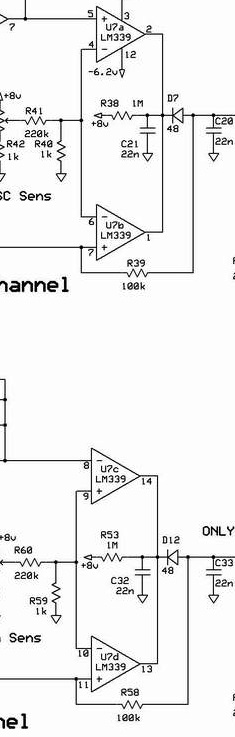

ID:	352104There is an error in the layout of LM339 ??? The black metal channel does not work, maybe this is the reason ???
