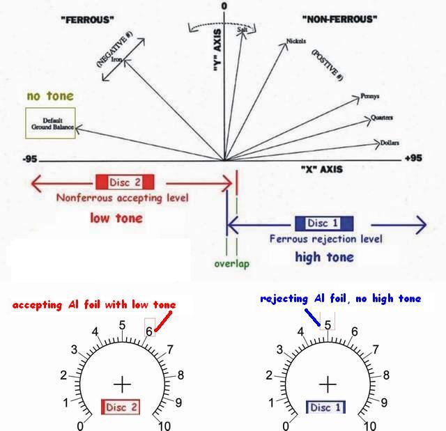

                    • To clear up about "Disc" potentiometers ranges at IGSL.
                      I hope this chart will explain:

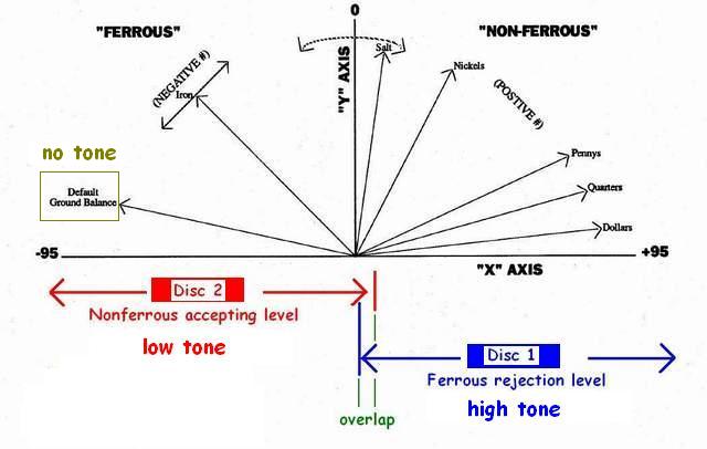

                      • Chart is not ideal, just showing approximated potentiometers ranges.
                        There is one pretty illustrative example of how this work:
                        Al foil accepting and rejecting - or "transferring" it from "colored" to "irons".
                        If Disc 2 is set to 6 and Disc 1 is set to 5 - than Al foil detection will give lower tone, same like on irons.
                        Why?
                        Because with Disc 2 set on 6 (and over), FE block will start to accept colored alloys up to end of overlap zone on the sketch. Therefore low tone will appear in speaker.
                        To prevent also higher tone to appear in speaker; Disc 1 is set to 5, the point from which Disc block will start to reject Al foils.
                        Disc 1 is functioning the same as Disc on TGSL, so; good phase relations are settled exactly when tiny Al foil is fully rejected at Disc set to 5.
                        In case Al foil (so as tiny silver and gold) are wanted - Disc 1 is set bellow 5 and will be accepted as well. Than Disc 2 is better to be adjusted fully anticlockwise, to prevent also indicating it with lower tone.
                        This is just one simple and illustrative example.
                        Many interesting combinations can be achieved with different potentiometers setups.
                        Along with Disc pots, there are also Sense pots which can be adjusted different and also included in variety of possible combinations.
                        Maximum Sense at Disc block along with minimum Sense at Fe block will provide additional good behavior in searching only for colored alloys and better suppressing of iron signals...etc...etc..
                        It is only up to operator and his demands.
                        • I thought I understood it but now I am not sure. In your example, what tone or tones do you get if the target happens to be in the overlap region between 5 and 6 ?
                          It is going to be at least another month before I can continue with this project so in the mean time all I can do is read and ask pesky questions
                          Jerry
                          • Originally posted by Jerry View Post
                            Jerry
                            Overlap is not existing all the time, only when Disc 2 is adjusted fully clockwise and Disc 1 fully counterclockwise, pretty rare situation and in most of the possible cases undesirable.
                            Because; why would you wanted to adjust Disc 1 that low anyway? You will decide whether to "transfer" Al foil in low tone range or to keep it in high tone range. But if you rise Disc 2 to accept Al foils and lower Disc 1 not to reject Al foil - than you will hear both tones at the same time.
                            Clean division on colored and irons are achieved very simply; both Disc potentiometers are to be set to minimum, counterclockwise.
                            If Disc 2 stays at minimum (counterclockwise) than you have remained Disc 1 to play with it. From that point it is the same situation as on TGSL. Fe block will sound on only irons and Disc block will accept/reject according to position of Disc 1.
                            So there is also interesting situation to hear low tones and irons and not to hear nothing bellow Disc1 position, in this case Al foil.
                            Cool stuff! Make it and experiment, new world of possibilities will open to you!
                            • "...Overlap is not existing all the time, only when Disc 2 is adjusted fully clockwise and Disc 1 fully counterclockwise, pretty rare situation and in most of the possible cases undesirable..."
                              What i am saying here! On contrary!
                              Such situation is not "undesirable" but can be also another very interesting and desirable situation too!
                              Because what will happen than?
                              Irons will produce only low tone, colored alloys which are over Al foils on scale will produce high tone ...and everything else implied in overlap range will be indicated with both tones!
                              That's also another splendid choice!
