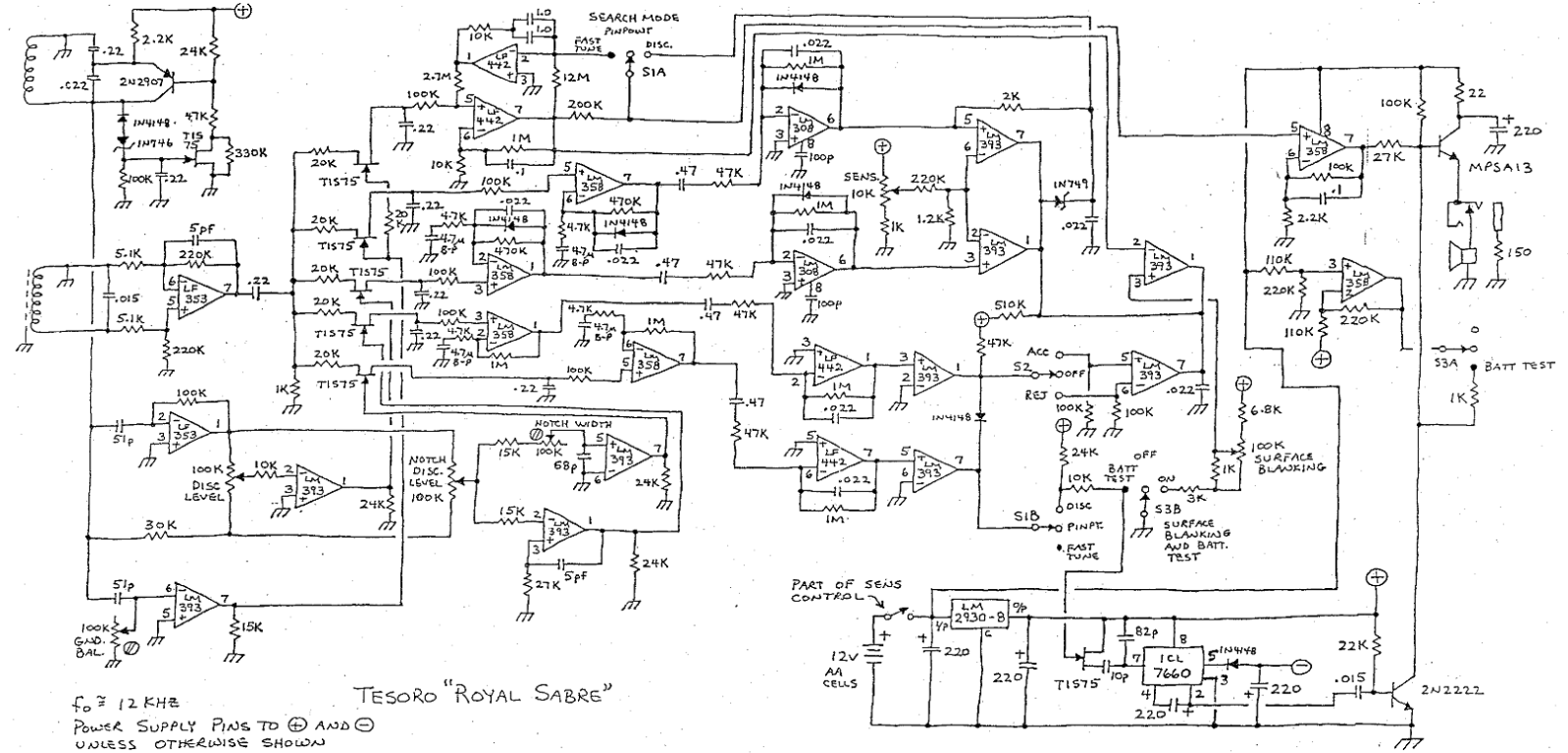

Ad2) It is Pinpoint channel taken over from Tesoro Royal Sabre. It has non motion pinpointer/Auto retune switch and fast retune button. So I would call it IRSL. I also added VCO from LM373 datasheet.

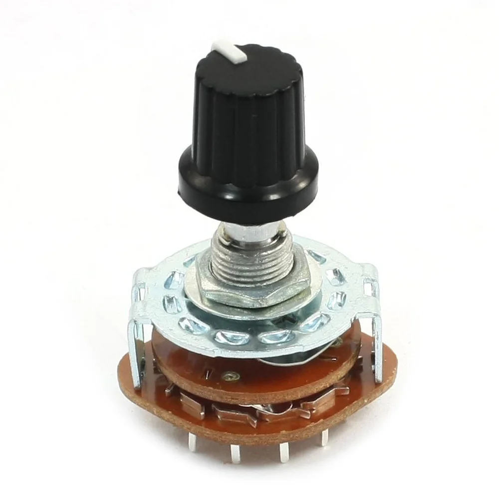

Switching between modes is provided by 4 Pole / 3 Positions rotary switch like this one: https://ae01.alicdn.com/kf/HTB17ZwUQ...Xq6xXFXXXr.jpg
So I have:
1) Disc/Accept as usual
2) Pinpointer
3) All metal Disc/standard Acceptance

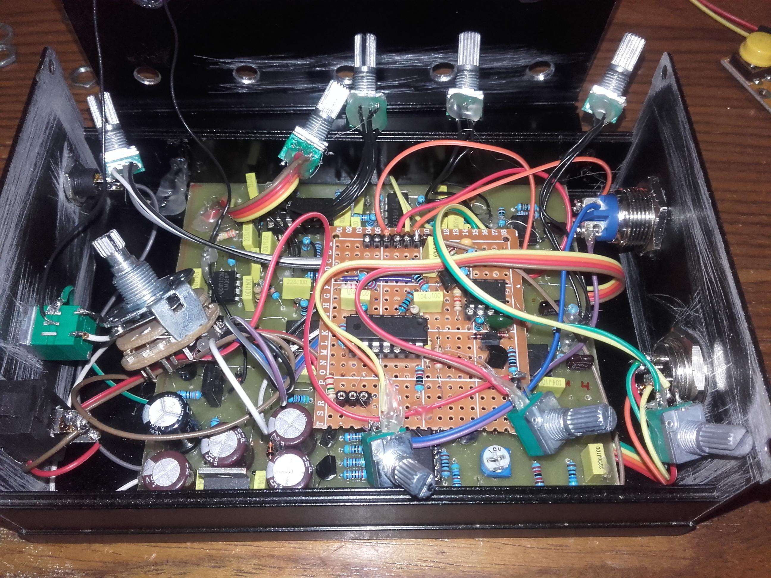

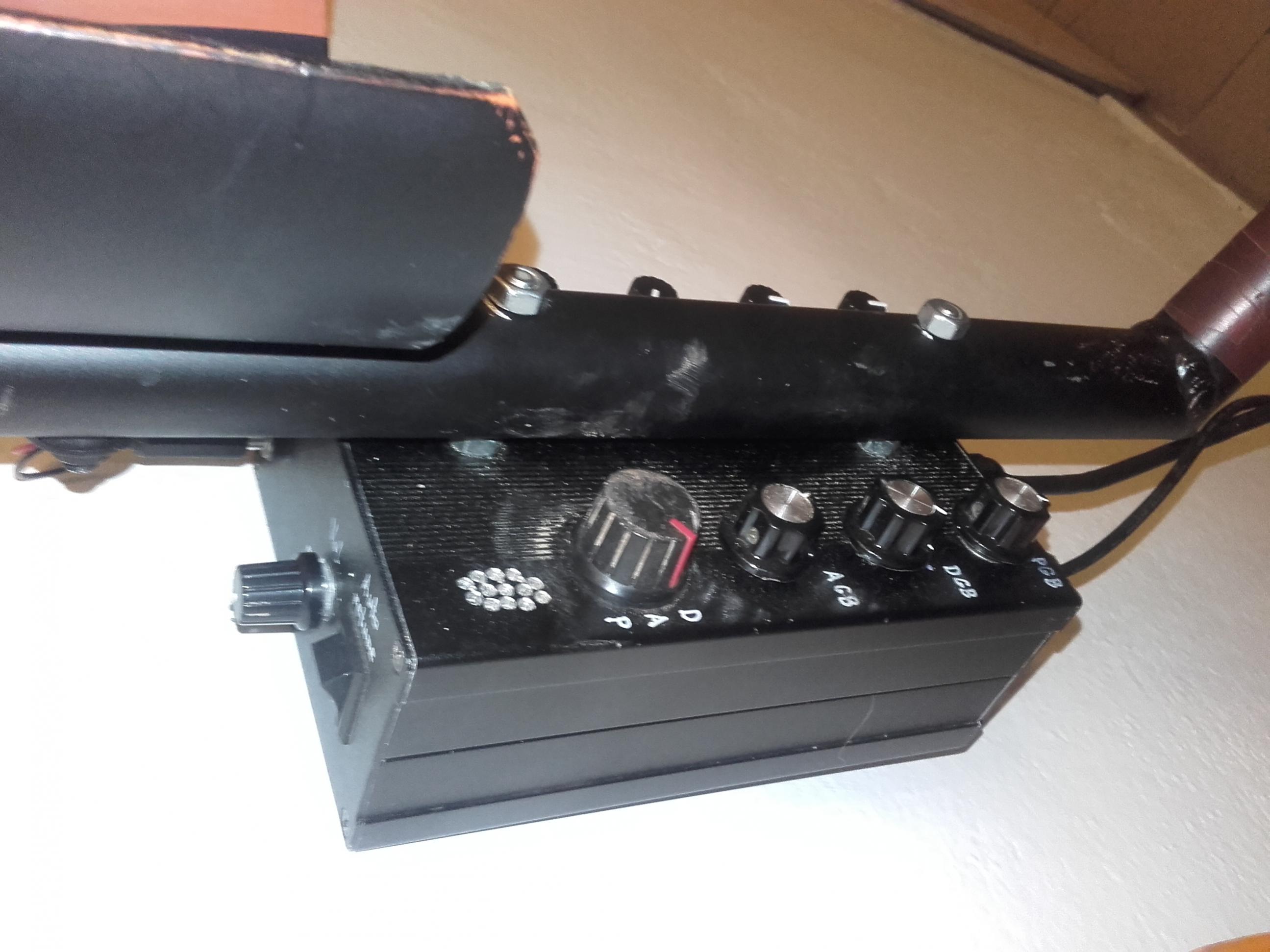

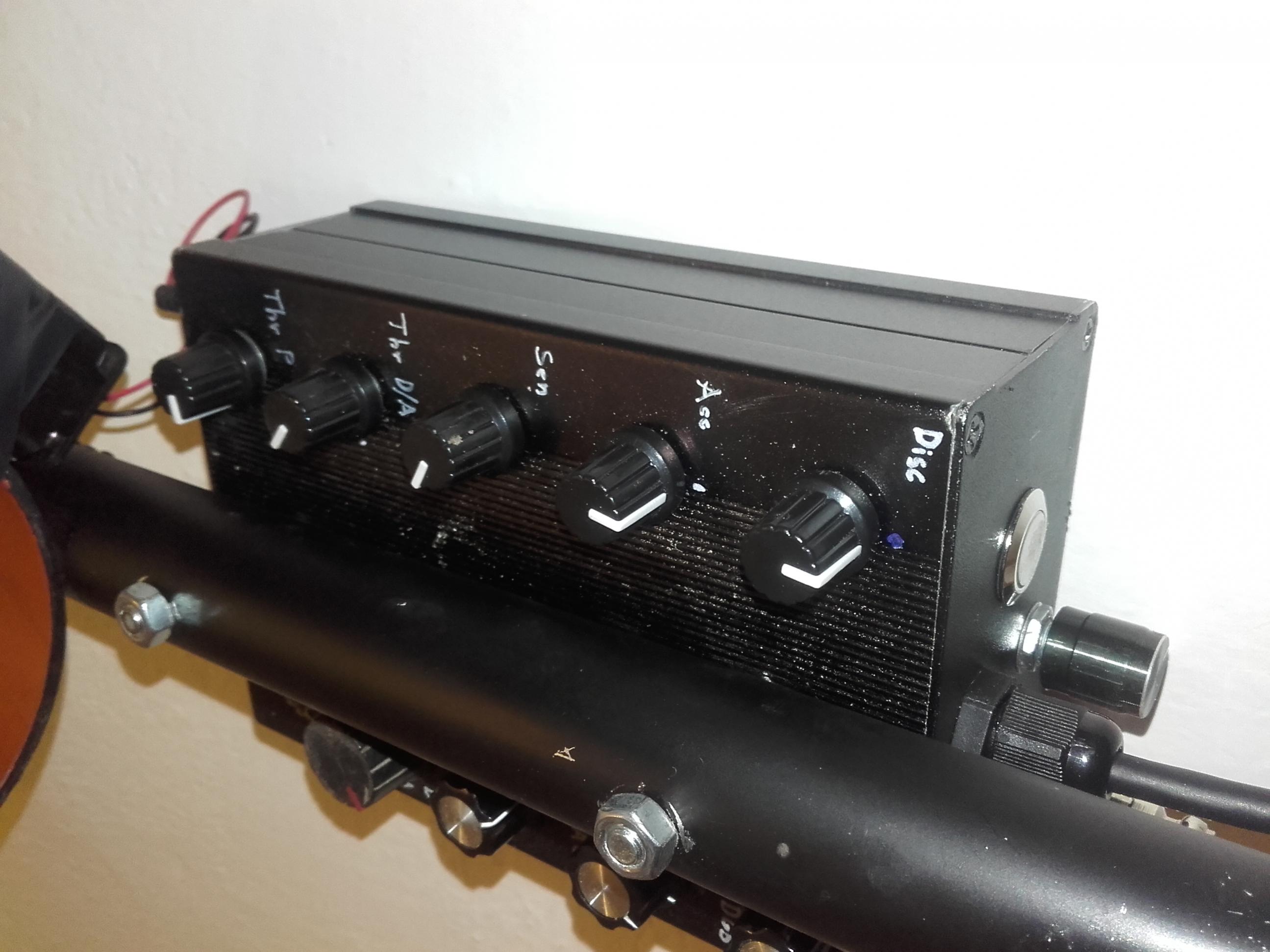

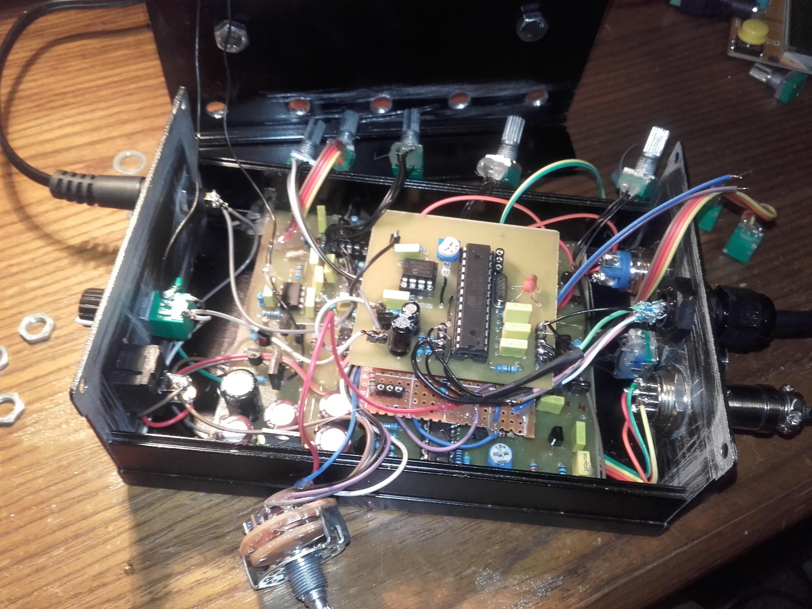

A attached schematics. There are pin swap mods for Acceptance channel and GEB channel against original design - as is mentioned in this thread on several places. I also changed LF351 for LM833 to have both channels the same. PCB for pinpoint does not exist, I did it on prototype board as you can see on pics. There is add on board for this channel and another one for VDI. Now it consumes about 100mA which is quite a lot. I would to draw SMD board for pinpointer and VDI at once with TL064 and I will change LF347 in Acceptance channel to TL064. One half of LM393 is used for GEB of Pinpointer and other half for VCO. Capacitor drives frequencies. 22nF is for 200-400hZ (15nF is 240 - 500Hz and so on...), which I found as most pleasant. There is spare op amp on LF357 and I did not grounded inputs as is often mentioned in datasheets for op amps. This and few more things I want to correct on SMD board. Case has a lot of buttons, some of them can be reduced by CD4053 maybe... Do you have any other recommendations which I should implement?
