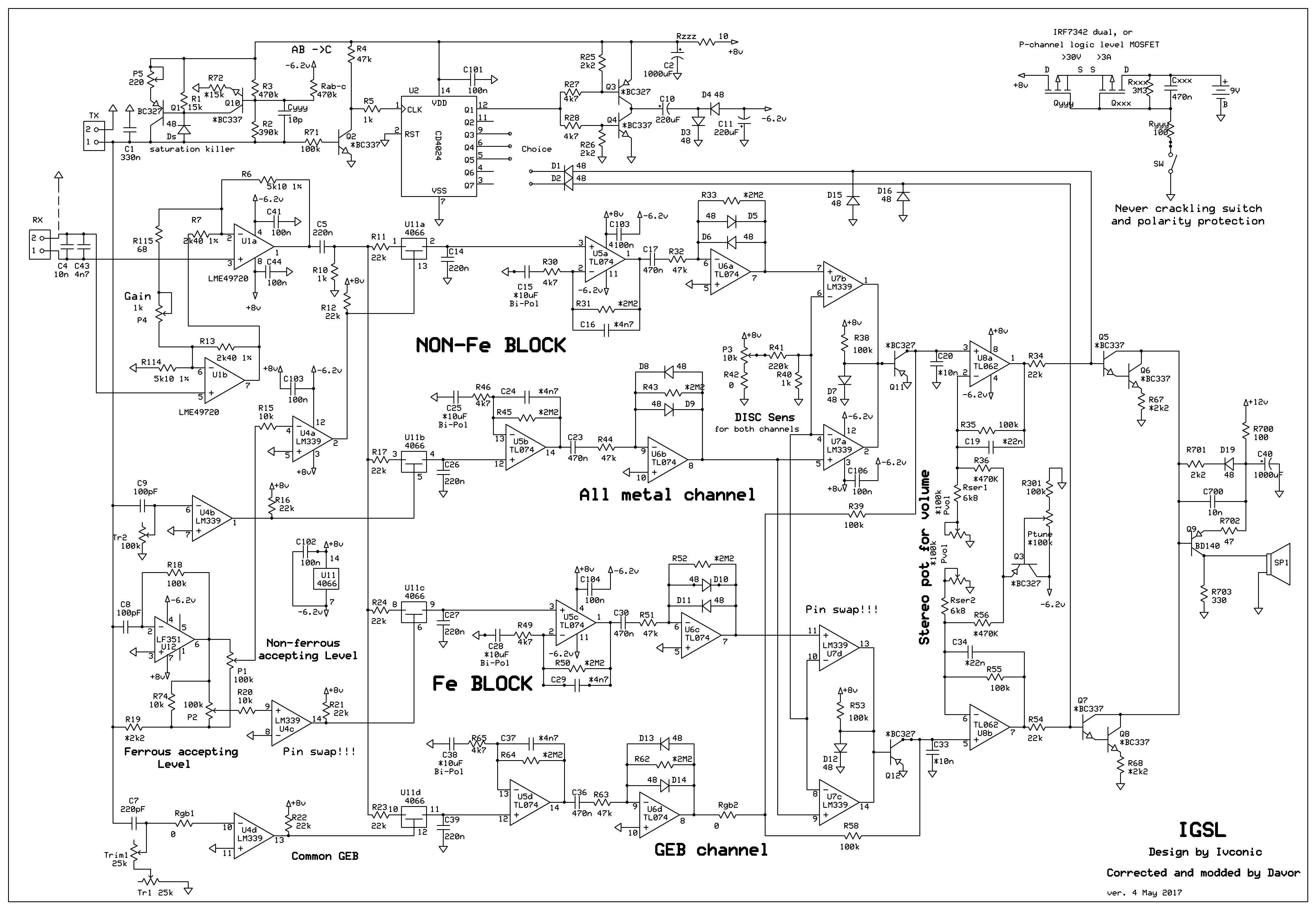

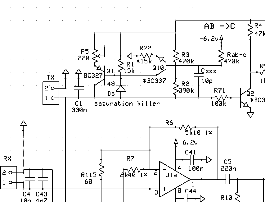

                • I (almost) finished the schematic with all the mods. It needs a careful look to fix errors that may be in there, and careful pondering if there is anything else to add. SMD is not forgiving.
                  I separated GB from All metal, introduced new discriminator detail, added "tune" function like in Whites 6000, fixed audio PA.
                  Added power switch support with wrong polarity protection.
                  I also replaced Tesoro-style Rx front end with 2-op-amp in-amp. While this may seem odd, this will allow for replacing the Rx preamp chip with a much better one, and get improvement as well. With Tesoro configuration you are stuck at >7nV/sqrt(Hz). With modestly priced chips like LME49720 it makes no sense to continue chasing one's own tail with old school op-amps. Besides, I can introduce a simple 20dB gain regulation with a single pot.
                  In Tx I added a phase correcting capacitor and a saturation-killer diode. I expect over 10dB 2nd harmonic improvement.
                  Unfortunately I'm not in a position to test all the new mods right now. It would be best if these are tested prior to going SMD. Better safe than sorry.

                  • With a caveat that I did not test some of the mods, here is a fresh schematic.
                    There is a function I'd wish to include, but I'm not clear how exactly to implement it. It would be a global phase shift, a function that would facilitate coil changes. I'll add it when I decide where to put it.
                    This solution is still work in progress and open for debate. I made some last minute changes before posting, and because all my errors in using ExpressSCH that are hidden inside, so it is not ready for netlisting.
                    The vast majority of mods are doable in the existing builds even without extra pieces of PCB.
                    I must test the in-amp front-end, power switch, audio PA, saturating transistor switches introduced in discrimination, and splitting/joining all metal and GB channels. The rest I tested with favourable improvements.
                    Ditching a voltage regulator was a move in a very good direction, as batteries are quieter than any regulator by several orders of magnitude. The difference was very notable. I'm using 9V cubes. I didn't try the rechargeable ones, but those would be OK as well.
                    I intend to introduce an add-on PCB with wide range GB for beach hunting. Most users do not need salty beach functionality anyway. Splitting All metal functionality from GB alone will fix most of the problems related to high GB settings - no more falses on difficult terrains.

                            • Beware the pin numbering of gain blocks, it is wrong. I'll fix those eventually.
                                Davor, can you confirm those pin swap's on U4 and U7?
