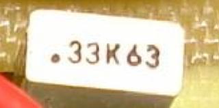

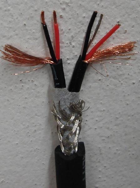

  • Hi,
    TX coil resistance is 3,7 ohm. Capacitor is 330 nF (I do not know type, there is written EL 1228 ). Inductance of TX coil is about 1 mH, cable is PROEL HIGH QUALITY MULTIPAIR AUDIO CABLE INDIVIDUALLY JACKETED-CMT2.
    Is resitance of Tx coil big ( low Q ) ? What type capacitor should I use ? I can buy only MKS type ( metallized polyester ) or MKP ( metallized polypropylene ).
    Sini
    • Originally posted by sini View Post
      This is the culprit.
      OK, it is not that bad, it only puts lower harmonic attenuation into perspective. My coil is about 1m4 and about half resistance.
      Your capacitor is fine and your cable is fine.
      Going for higher Q comes with a price of a heavy coil, so the ultimate goal would be having a lighter coil with lower Q, but superb signal nevertheless.
