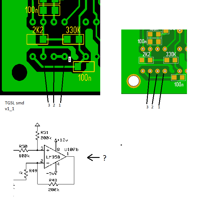

        • Hello,
          It is a version of TGSL smd by Hugo segnior.
          can you tell me if the connection of LM358 audio is good because I see differences connection to pins 1, 2, 3
Name:	QUESTION pcb TGSL smd.png
          thank you

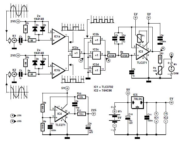

                  • PHASEMETRE DVM for nulling without oscilloscope
                    Here the phasemeter for DVM as promised. I realized sprint layout format.
                    Really necessary to adjust the phase coils and more convenient than oscilloscope.
                    There is nocmenclature and tutorial to calibrate without oscilloscope.
                    I recommend to calibrate to 20 ° to 15khz (for TGSL) to be certain because a phase variations show a difference on the DVM
                    I am not an expert in analog electronics so for those improvements or advice, do not hesitate.
                    This is the phasemeter from élektor magazine.
                    PHASEMETRE DVM.rar

                        • Originally posted by zoomix View Post
                          [ATTACH]22588[/ATTACH]
                          Do you have a schematic?
Name:	Phasemetre schéma.jpg
