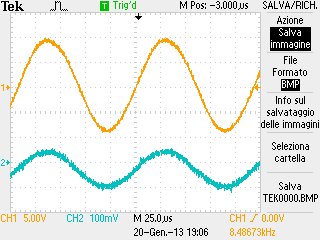

                      I think that the behaviour of your IGSL is strictly caused by the TX/RX phase difference. This is for how the coil was constructed.
                      In my coil phase difference is very minimal and at first beginning the MD gave me a good result for Non Fe channel but a strange behaviour for the Fe one. Then I have made the modify of swapping described in my post #1646; with it Fe channel is working fine.
                      This is my phase relationship, I would like to see that of your coil, if is possible. I am very curious.

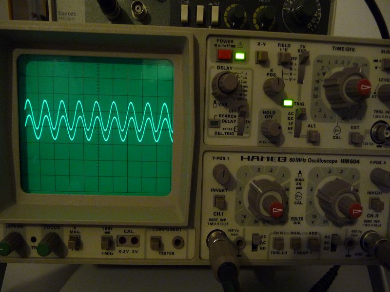

                      • This is my phase relationship.Click image for larger version
Name:	minelab dd spule.jpg
ID:	334851 The bigger curve is TX the smaller RX. It is with a Minelab-Explorer DD-Coil.
                        • This looks a bit too much shifted. Perhaps the Rx coil is too close to resonance?

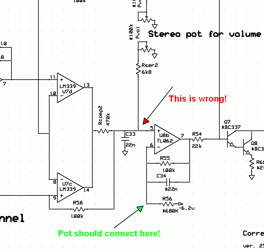

                          • @didier pointed me to a mistake in a schematic with my mods. It happened by dragging a component in ExpressSCH, and incidentally the connection was made at a wrong pin of U8b, here is a picture of the error, and a corrected schematic.

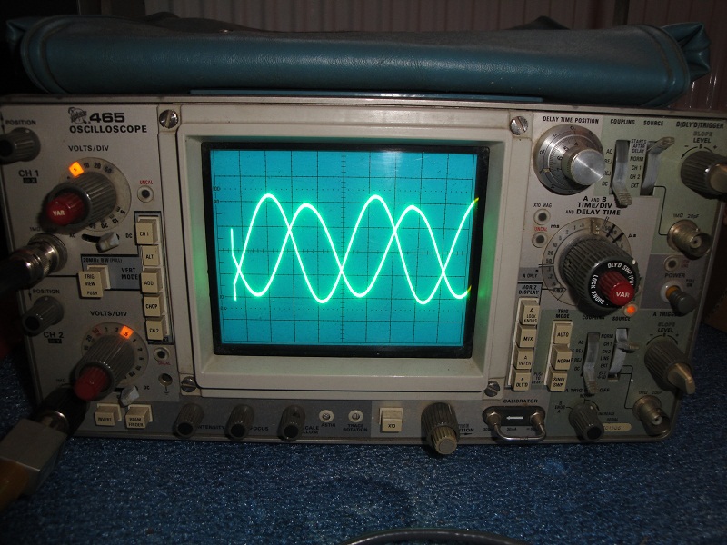

                              Hi Altair,
                              here my sinuswaves from my IGSL Musketeer! The upper wave is TX and the lower wave is RX. On TX i use a 330nF and on Rx side 15nF
                              Firebox

                                Thank you for sharing your picture.
                                It seems a phase relationship pretty normal, so I don't explain myself your results; it could be some technical constructive (shielding, etc..) that make difference.
