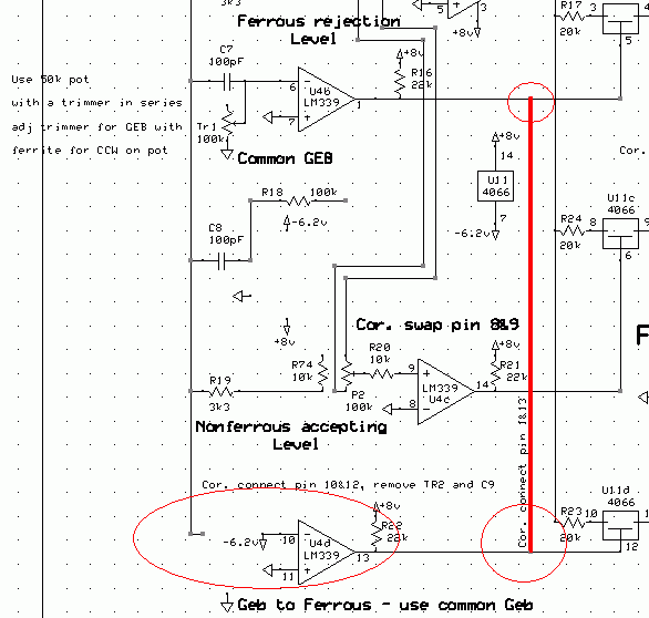

                • You need to learn how to tune ground balance. I guess you are Indonesian living on some volcanic island with highly mineralised soil.
                  Maybe your best option will be joining GB together as in my mods, and put a potentiometer on the front plate.
                  1. you must find a position on your GB potentiometer that does not produce sound but maybe only clicking when you wave a piece of ferrite in front of your coil. Mark that position as "ferrite".
                  2. by waving a coil up-down, not left-right, find a position on a GB potentiometer that silences your device. Mark that position for future reference.
                  Now your device does not sense most of the rocks.

                          It is ground balance, or GB for short. Al foil has nothing to do with eliminating ground. You have a pair of trim pots on your board for that purpose. Ivconic wanted to use those separately so that Fe channel indicates a bit of ground, and once tuned properly - just let them be. It would work fine in European inland boring soils. But in your case it will not be possible. You'll have to use a front panel potentiometer for GB instead. I think the best way to do GB on IGSL is to join GB for both Fe and Non-Fe channels. Minimum changes on your board will be necessary if you apply my mod, as follows:

                              • It is not complicated. You need to use a single comparator to drive both GB channels of Fe and Non-Fe with same signal. To do that you need to set comparator U4d high, and easiest way to do that is by removing the trimmer and connecting the "-" input to negative voltage. Next you simply need to connect pins 1 and 13 so that U4b does all the GB work. This results in common GB drive in both Fe and Non-Fe channels. To have a real potentiometer at hand to adjust GB on the go, you need to replace a trimmer potentiometer on the PCB with a real potentiometer on the front panel, so you simply extract a trimmer Tr1 and place two wires in it's place, and connect a potentiometer. Beware - the high impedance of this line is prone to picking up various EMI, so twist the wires that go to the potentiometer. Now you have common GB control on your front panel.
