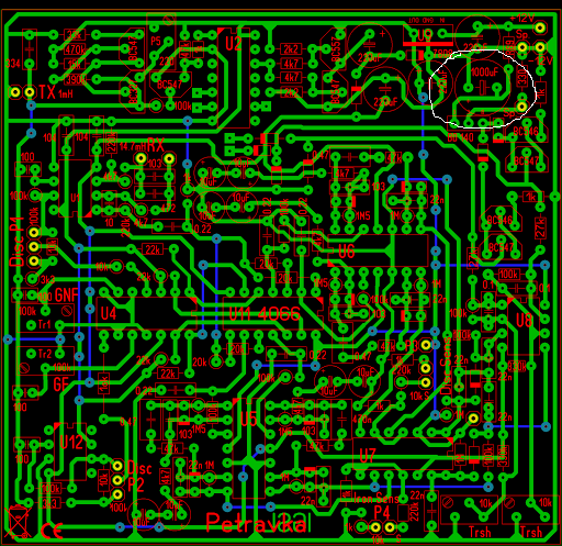

                          • Reversing these diodes makes no sense. Please make a photo of your board.

                              • davor is this true positive and negative pole position Click image for larger version
Name:	kompletna plocica.png
