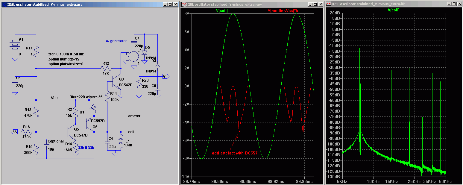

                          • Here is my input. Apparently when power supply is simulated correctly there is no problem with starting even with 470k.
Name:	IGSL AB to C.gif
                            The upper right part of the schematic is a simplified negative voltage source. There is an optional 10p capacitor for improving symmetry, which is not needed as the improvement is negligible.
                            You'll see an expected artefact that is present only with BC557, but not with BC327. It could also be a LTspice thing. Anyway, there is a little difference between the two.
                            FFT is done with flat top windowing to improve level reading, and it reflects your FFT-s as well.
                            The schematic in LTspice is attached here:

                              • Difference between BC327 and BC337 vs BC557 and BC547 seem to be not too big, so keep it as is. Apparently there is a lack of gain with 470k in your configuration, as it seem as if the initial case was measured with a trimmer cranked all the way. Therefore the S_DSC02811.JPG case among the 560k cases is the best that I've seen so far.
                                Simulations predict some 10 dB better purity for similar cases, unless the tank Q is lower. What are your coil's resistance, and what kind of capacitor do you have?
