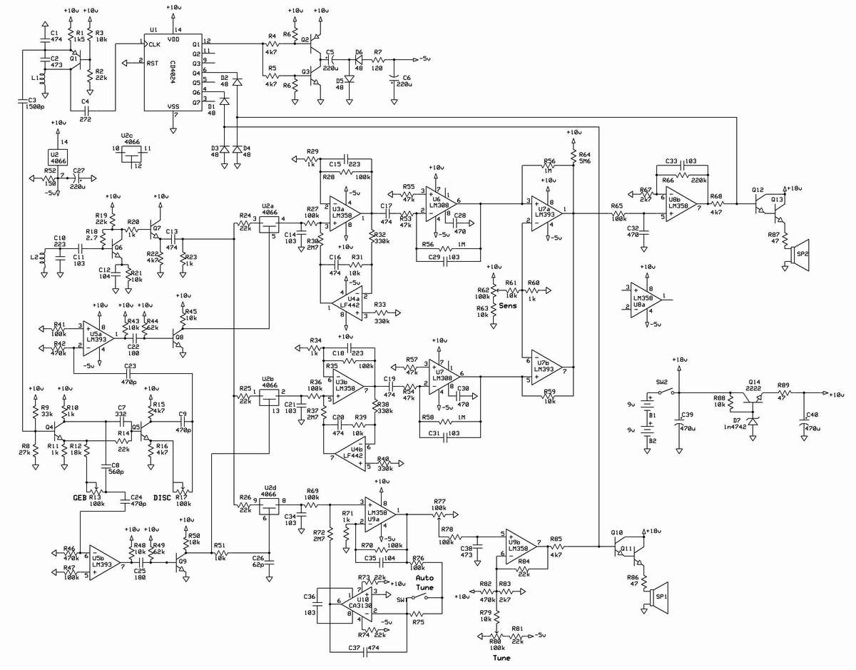

      While waiting IGSL pcb to be etched; i returned to this post. Yes, dfbowers, now looking again at this Nautilus schematic; i see certain analogy even more than i realized before! Principles are different but some analogy still exist. I had on my mind Nautilus and what was done at it, but i never payed more attention on it's details.
      Now i made redraw of schematic and adapted "style" to be more "readable", and here it is. Some values and some connections need to be checked, because i am not sure about those. PDF file is not readable enough to be sure in those.
      Would be nice if someone can check this and correct eventual mistakes..

                Nice! I'm not sure what the original source of the hand drawn schematic is. I will double check yours when I have a few hours. I have 2 other Nautilus schematics as well if you are interested. The DMCII has the features that are relevant to your post though. The DMCIIB has a signal loop balance circuit which feeds phase and amplitude back to the Rx coil for nulling in the field and has adjustable Tx power as well.
                Too bad Nautilus has never come up with product to keep up with technology though. They are large and heavy but many relic hunters are willing to put up with it just for the features. I and temped to build your IGSL just for a comparison! Maybe next winters project.
                      Ivica, I see the following corrections:
                      R6 - doubled nummeration
                      R6 & R6 - no value
                      R52 - draws too many energy
                      R64 - too large resistance
                      R75 - no value
                      R77 - no title
                      R87 - better to be placed in series with collectors of Q12 &Q13 to battery voltage and collectors with large capacitance to COM.
                      R89 - useless resistor
                      C27 appears in parallel to C6
                      Different notation of C and R values. For example C23, C24 and C9 have value noted with letter "p", but letter "p" is omitted at value of other picofarad capacitors: C22, C25, C28, C30 and C32.
                      Resistor R18 is noted as 2.7, but other resistors are noted as 2M7.
                      SP1 - no value of resistance.

                        For fun:
                        How about: short circuit protection (current limiting); startup current spike limiting; isolation of speaker spikes from rest of circuit?
                        How about: guarantees reasonably high impedance to driver circuit regardless of speaker choice?
                        Just speculating...

                            Agree. I have doubts about some values. I can not see clear some things in posted .pdf file.

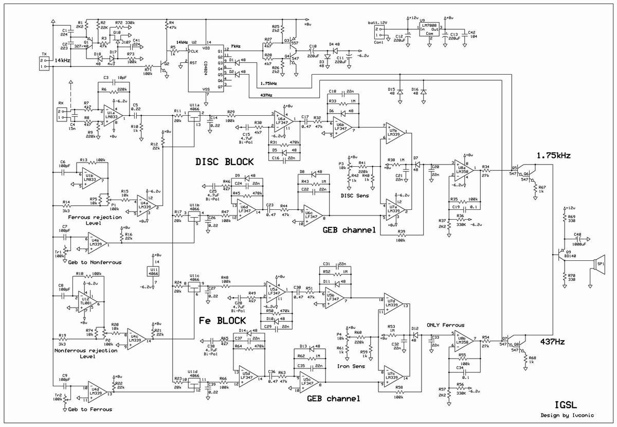

                              Ok, now let's back to IGSL. Here are the latest updates of schematic and pcb. Some mistakes are corrected....
