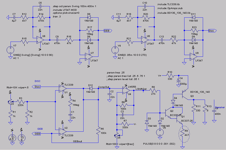

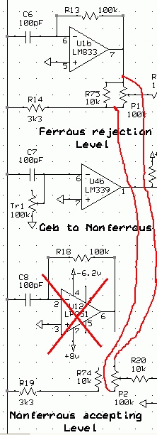

  • There is another "stealth IGSL" modification on the way: LF351 is not required at all. There is an identical circuit with ample driving force, U1b LM833 (or NE5532, same thing). Modification means just rewiring a potentiometer P2 (of the FE block) so that CCW and CW terminals go parallel to the respective terminals of a P1 potentiometer, and a wiper terminal goes to its usual place on PCB. LF351 can then be safely extracted, and a few milliamps are saved. And everything works perfectly well
    I populated most of my 2 IGSL boards, and now I have to decide what modifications will be applied prior to reviving them. I decided to go with "ikebana" solution for correcting LM339 mistake in FE channel.
    Mosquitoes are murder at night, and seawater is so good by days.
    • Just found something... capacitors C7 and C9 might need some beefing up for a musketeer version. While playing with lower impedance frontend, I encountered a little SNAFU: If I do it right and make it true differential, coil loading becomes more pronounced and Rx response becomes phase shifted more than the expected ~12° so GEB comes to question. Hence, I need some more phase span.
      Whoever encountered a problem of GEB that does not behave can increase C7 and C9 to 220pF, and thus widen GEB tuning range by double in the right direction.

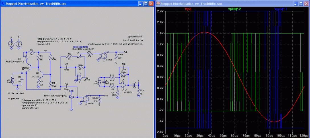

      • So whoever wishes to play with discrimination/GEB switchers, I'm attaching a LTspice circuit that is somewhat changed version of a circuit by porkluvr from a post #1150 of this topic. I replaced comparators with switches so that it converges while I'm still young (it is darn fast this way). I also replaced Rx frontend values with equivalent differential impedance of 6k8 - it is comprised of the most common values I could combine, and a differential impedance error is negligible.
        And I changed a 100p to 220p as indicated in a previous post.
        Enjoy

          • Yes, it is one way of looking at it
            On the other hand, there are some things in electronics, as well as in any other creative process, that are more obvious to a complete lamer than the author himself. A procedure is called "proofreading" and I am never ashamed to ask someone outside of a project to take a peek and clear some obvious mistakes. Those are the most difficult to spot.
            Of all MD projects I picked IGSL, not to make fun of the author's work, but to own a good DIY detector and learn a lot in a process. I do think IGSL is a very mature project worth building, and tinkering with.
            For example, LF351 rotates a phase in exactly the same fashion as the second LM833 opamp does, but the business part of the process is happening at the potentiometer wiper. Placing two potentiometers in parallel, and supplying their wipers signals to separate comparators works exactly the same as if you use additional LF351. No difference at all. OK, there are a few milliamps less power, but that's even better.
            I am confident that my IGSL will beep by the end of the week, if no delays come its way, and I hope to have a video of its operation.

                      Now that you are mentioning a second GEB... I didn't foresee these soil features that you mention, but they make sense. I'll surely try experimenting on these once my rig is ready.
                      Anyway, LF351 - or not, all features remain the same as before.

                          This will require a short "ab ovo" explanation, but here you go. In these VLF Rx-es coil signal is sampled by two phase shifted LO-s and a resulting signal is amplified by respective gain block. These resulting signals are either in phase or in counterphase, and represent target response envelope. Phase as defined by LO-s will decide whether this signal is positive or negative at some moment, and that results in target discrimination. In case of IGSL and TGSL both gain blocks must supply positive signal to the comparators gates (AND function), and they turn high impedance and a GEB signal is passed to a tone producing circuitry.
                          So, to have a positive confirmation of a target in a specified span of angles (discrimination) both disc and GEB channels must be positive. That is the one quadrant detection: positive I and positive Q.
                          In all other instances there should be no firing of tone.
                          But... there are also noise, interferences, and phase troubles.
                          For noise you have a threshold control, in IGSL this is called "Disc sens". So you set it to the lowest possible setting that will not annoy you.
                          Interferences are a bit different because their result may rotate in phase at speed that passes through gain block filters, and their power may be quite high, e.g. two metal detectors operating nearby. I'm afraid that only a coil arrangement that cancels far field can help here for real. Or you crank up the "Disc sens".
                          And now - the feature content: phase troubles. Both TGSL and IGSL, and I guess many Tesoro detectors have a very specific gain block configuration with one diode in each stage. There is nothing wrong with it when you deal with low signals, but there is a phase shift with stronger signals. This shift comes from the fact that net. impedance in gain stage feedback lowers when diode conducts, and more so with stronger signals. If both disc and GEB channels are supplied with equally strong signals there would be no problem because both shifts would be ~ the same and nothing spectacular would happen. Trouble is that it is seldom the case, and being a motion compensated detector as it is, even for situations with GEB and disc being in counterphase at samplers - there are spikes at phase overlap later on.
                          TGSL's gain block diodes create a phase shift with rising signal, but tackle its problems by making a positive response shrink to a shorter pulse, and on top of it apply the severe "anti chatter filter" to make it even shorter. Doing so they hurt low signal detection, and also detection of signals that produce big differences in amplitude in GEB against disc. That is the main reason it got so much of my attention.
                          How to fix it? I think the easy way to fix the unruly gain stages phases is to remove all compression function from the first stage, and remove all LPF function from the other. In other words, a diode is removed in the first stage and placed antiparallel to the diode in second stage, and remove a capacitor in feedback of the second stage - so that you have a place for diode. This removes phase and pulse shortening problems, and some spikes appear only when first stage's output hits the rails.
                          I won't put the whole LTspice shebang here again because the mother of this solution is already placed in post #1289 - here is only a printscreen picture of the setup:
