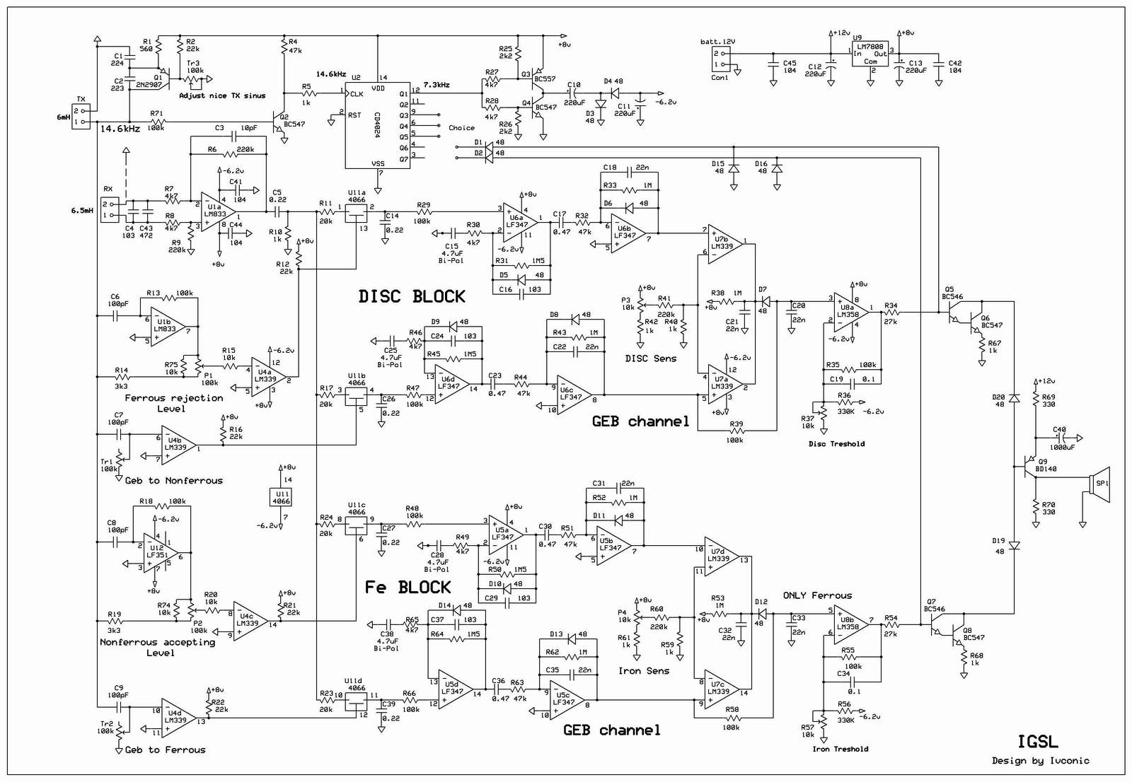

  • I bought the IGSL - TGSL pcb kit from silverdog's site and i must say it's beautiful! i see the pics are already up from another person a few pages back.
    my concern is part reference #s. what the heck is U11? what does U11 correlate with? is it the LM339N IC? I'm confused. the parts reference I do have is for the IGSL EDU and is completely bogus in my case.
    I would really like to get started Any help, links, pics, etc would be most appreciated!

          Its all in this thread somewhere
          Re-posting Schematic with a partslist

                    • IGSL
                      I finally got IGSL board working good. After pulling off the musketeer oscillator , which was working fine, I put on the original TGSL osc. But that wasnt the problem! I used the partslist in post #274 which has caps. C17, C23,30 and 36 wrong. The file in post #274 should be changed or deleted to save someone building the IGSL a whole lot of trouble! Silverdogs partlist is the correct one!

                            Der fisherman just rushed... i don't think he did that intentionally.
                            I didn't made BOM because i am used to search for values from schematics. I am never using no BOM's anyway. What is written on schematic - presents MUST for me.
                            But regarding other people here, now i am sure that i had to do that and make separate BOM file too. It is my mistake, sorry.

                              Not you fault Ivconic! you had the values right on the schematic. And Im sure fisherman was trying to help and meant well. Which goes back to the point if we all could agree on a common pcb and schematic program to use, some of them will print out a parts list.
