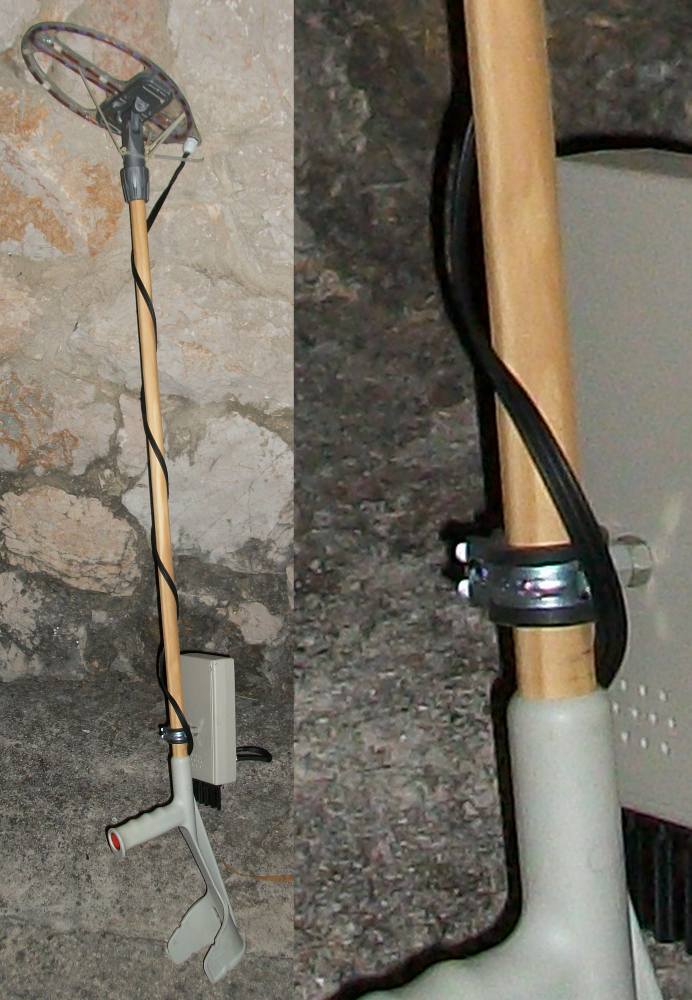

In a moment of epiphany I realised a perfect mount for the device on the shaft. So it became complete. OK, a few washers wouldn't hurt, but a nut and a screw just proved the concept.
I have a silly notion of giving names to all devices at home, and i christened this one "Raskov 2012". Have a look (temporary straps are still on the probe):
