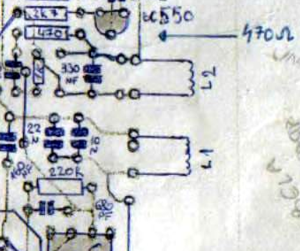

    This is my working version of the paper, which I looked at when assembling the pcb from those "hundreds" of my handiwork:

    And if you pay close attention to the capacitor values ​​here, you'll also see the values ​​I was talking about:

      I just saw this.
      You have to "trim" the TX&RX capacitors as well.
      It was long time ago, if I recall correctly; 330nF parallel to RX and 32nF parallel to TX (22+10).
      Right info is burried deep down somewhere in the forum, I posted this so long ago.
        ..... one of the trimmers on the pcb is crucial for setting the phase.

        • Here's a part of the schematic extracted from that pcb , so judge for yourself:

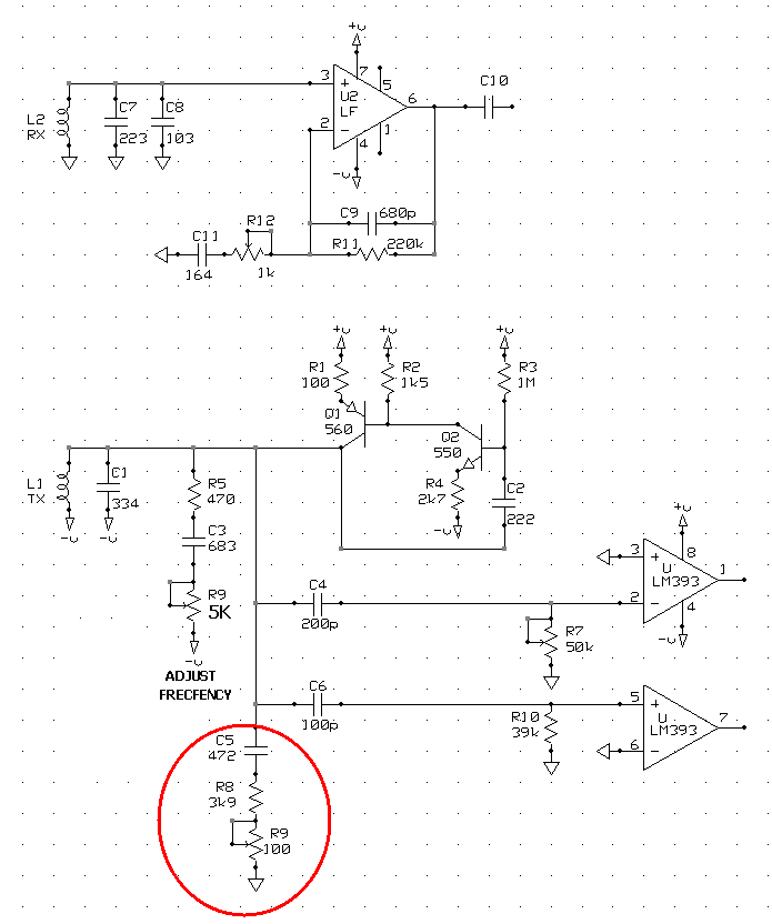

                  Could you discuss the role (necessity/purpose) of the R-C-R circuit put in parallel of the TX LC circuit (470-68n-1k)?
                  I`ve made detectors with that exact generator and LC circuit, and they work very well. That`s why I`m curious about the influence of these additional components to the generator`s behavior and the overall performance of the detector?​
                  Thanks in advance for any hints and tips you would suggest!...
                  • I think a potentiometer makes more sense​ 1-5k instead of a 1k resistor​ thus, noise from the outside environment is removed​ by a small change in frequency​ ,by changing the basic seed marked in red​ the smaller the phase shift​ in ch for discrimination​..Nothing is noticeable in the air, but I'm not sure how much it worsens the discrimination on the ground​ ? Maybe it penetrates deeper into the soil, but with less discrimination..​

                      The same idea pop up in my mind right after Ivconic mentioned the importance of one of the trimmers for the depth. On one hand, few weeks ago I did some experiments with buried small coin (18mm diameter on 22sm in the ground), and noticed that rotating above the target there are directions/approaches when was heard unequivocal and definite reaction, and continuing the movement around the target in a circle there were moments, when the detector discriminated it partially. These two facts provoked me to check this kind of schematics in my archives, and it was confirmed that in most cases the component you have encircled in red is trimmer instead of constant resistor. I hadn't been paying attention on that so seriously, even though, back in time, I`ve repaired detector based on that sch solution, and there definitely was trimmer, because I`d redrawn back its schematic from the PCB. So, I definitely will play with that issue during some of the next weekends, as to confirm or dispel doubts on the matter (Moreover, the coin is still in the ground and is waiting to be found easily and clearly) .
                      Cheers.
                      • I think the trimmer that ivconic refers to is a 1k one, which is not in the original IDX schematic, and was added in the RX circuit, also mentions that the tests were with a CZ5 coil.
                        Install this trimmer on my IDX, and you get an improvement in sensitivity, The GB and VDI varies a bit but it is within the range, my coil is homemade.​
