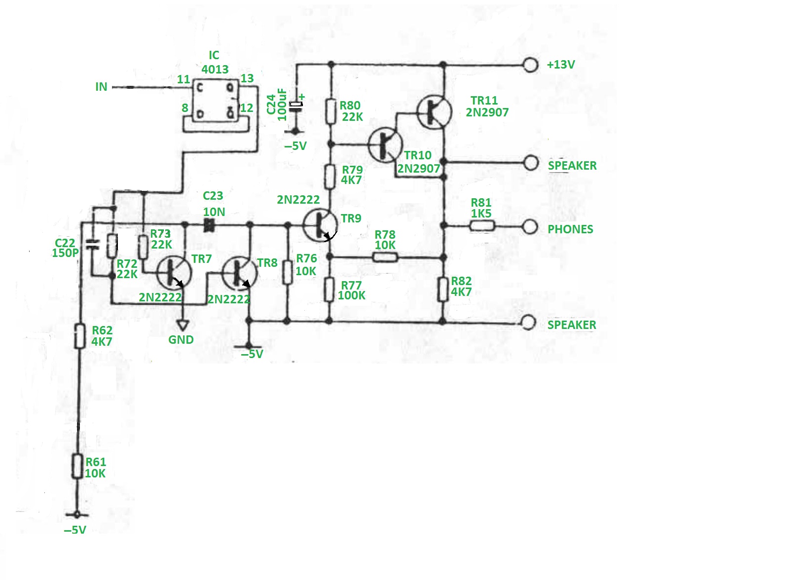

    I need help, is this really the csope 1220B audio section please correct and correct if something goes wrong,

      I do not understand why you are posting about the 1220 in an IDX-VDI thread????
        I mean whether the schema is correct and how it is connected to IDX I want to change the IDX audio

            I mean the image that I sent is the audio part, it's true or there's still a missing piece

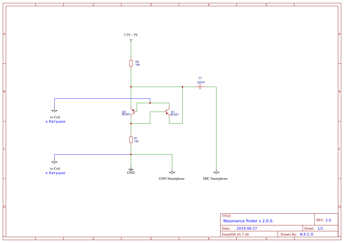

                • Good morning everyone!! Thanks to Eduardo 1979, Holyuser and all who collaborated for the success of this project; so that every hobbyist can build it. I have only read a few pages of this thread. I am starting in the construction of detectors and I would like you to help me how I could put the coils in resonance and I do not have an oscilloscope or sophisticated measurement equipment. I only have a multimeter, a frequency generator and a frequency meter that I did with an Atmega8 and I also have an Arduino one with which I made an inductance meter but I don't know if the measurement is correct. Please a help !!!!
                  • Will this NECO application that I found on Youtube work for me?
                    • https://youtu.be/RYBDPuuTHK4
