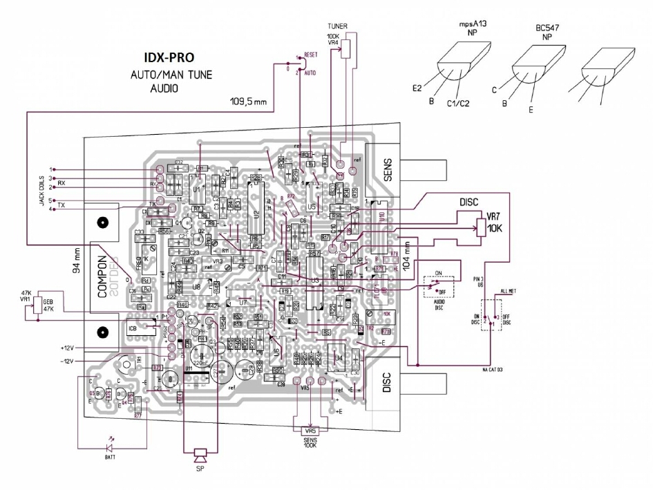

            • IDX PRO AUTO MAN TUNE AUDIO
              hi masters,
              Is there a sprint layout file belonging to the circuit?
              Has anyone ever tested or has a video.
              Gurdal
              • Originally posted by gurdal View Post
                hi masters,
                Gurdal
                This is 2 tone version, i have one pcb for this machine, but not tested yet.
                • Hi CDI
                  Can you scan and add it with scanner.
                  Let's copy it with sprint layout.
                  i want to test
