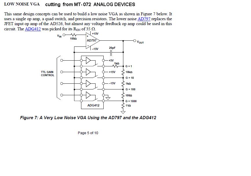

                              • Originally posted by szucs_g View Post
                                I experienced it unfortunately.
                                I noticed the gain endstopping when scoping in XY one time - Rx chain compresses like mad with a tractor wheelnut and goes non linear - the phase dexterity is lost and signals beat their way to the comparator and sound off as would non ferrous.
                                I was toying with the idea of a gain control (AGC) to slash the gain of the front end with large iron signals.
                                The Preamp could have n gain taps with cmos switches to select R's for gain -controlled from an A/D post demod.
                                Similar to ..
