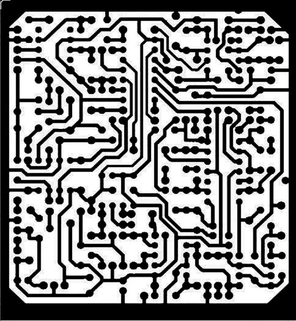

  • You need Sprint Layout and print to PDF then you get "black and white"
    • with the "sprint layout viewer" you can view and print the layout. but you can not edit layout. the program is free.
      I hope this helps.
      http://www.abacom-online.de/html/sprint-layout.html
      http://www.abacom-online.de/updates/...t60_Viewer.exe
      best regards, marc

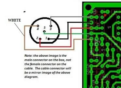

        • well check shielding two coils they do not touch and check the direction of connection also tx start , tx end , rx start , rx end .

            Ok Thanks Marc
Name:	Black and white.jpg
              Share This Black and White PCB

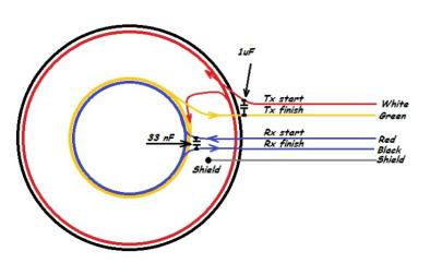

                      • Hi I am making my first coil and have a few questions.
                        It's going to be a 27cm DD. I have made a jig with the shape from in the TGSL_101 instructions
                        Found several different winding in this thread but they are close so
                        TX=35 turns 0,70 +1uF parallel
                        RX=270 turns 0,18 +33nF parallel
                        My questions are
                        1 Do I wind both the same direction
                        2 Each coil will have a start and a finish (TX start TX finish) (RX start RX finish) what pins on the connector do each go to.
                        3 Should I shield the TX as well as the RX
                        4 Which pins should the shield be connected to
                        5 If I stack the coils side by side as the come of the jig and open them out to make the DD shape. Is this right or will one have to be flipped over.
                        6 At the overlap one will be at the bottom should this be the TX or RX or makes no difference
                        7 The coil will be used on a 6000d and a silverdog does it make a difference which I set the frequency and null on.

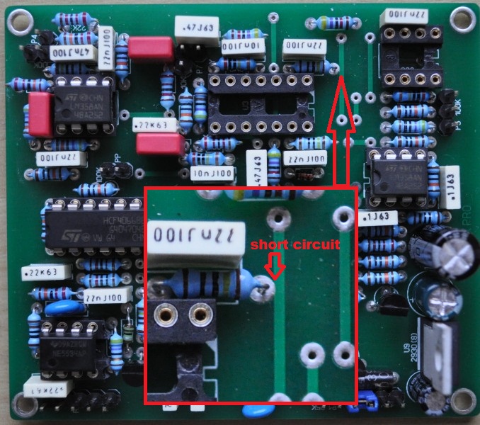

                              • Mistake on silverdog's PCB
                                I did not read the whole thread so I can repeat. When I start idx'a I found a bug on the PCB from silverdog. It is short circuit X and Y signal:
