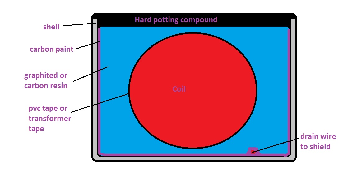

            Fit flexi entry gland to shell, prepare cable, Fit cable, secure gland compression / spot tack fine drain wires to shell and cable sheild and paint in carbon paint in shell and over drain wire but not to lip of shell - wait until thouroughly dried - carbon paint needs to be thin like a cellulose. but also needs to stick to shell ( waterbased acrilics fall off ) Roughen shell first. older grey car primer may be worth a go. oil based paints dont fi the bill as they never dry and make plastic brittle.
            coils go in tack, null, phase.
            pour in pot resin, which can epoxy glue, thin fast set or thick warmed /polyurathane car resin, /epoxy potting compound, /polyurathane potting coumpound mixed with carbon powder or very fine gapghite. or a blend.
            medium gain size Graphite tends to coalesce into tarmac like paste which doesnt like to flow - I warm the carrier resin of choice in 50C oven to thin it - so it A flows, B sets quicker. need to try this so you dont get messed up. It sits flatter/ thinner with lower Resitance outcome.
            Your shell should have enough depth to take your coils and some graphited/carboned resin to cover the coils - but have spare depth. ie conductive flood is not to the lip of the shell. Just below it. To the carbon paint finish depth line...
            The idea is, the conductive flood does never touch the ground - you top off the fill to the brim with Black resin , epoxy or potting compound ( Robnor resins do some good ones on uk )
            This top up final pot is non conductive, hard, and should have low water ingress. A commercial potting resin is best here, 80/90 shore hardness
            During this process have coil conntected to your detector - scope the Tx sig and Rx preamp out. When you pour the first lot of resin, you may see a phase and null shift. Be ready to have to tweak this on the fly and prioritise the phase over null, while wet see you can still reject ferrite ,, Iron and accept gold bronze and silver. This way there will be suprises when set!!!!
            This is the closest I know to commercial coil construction.

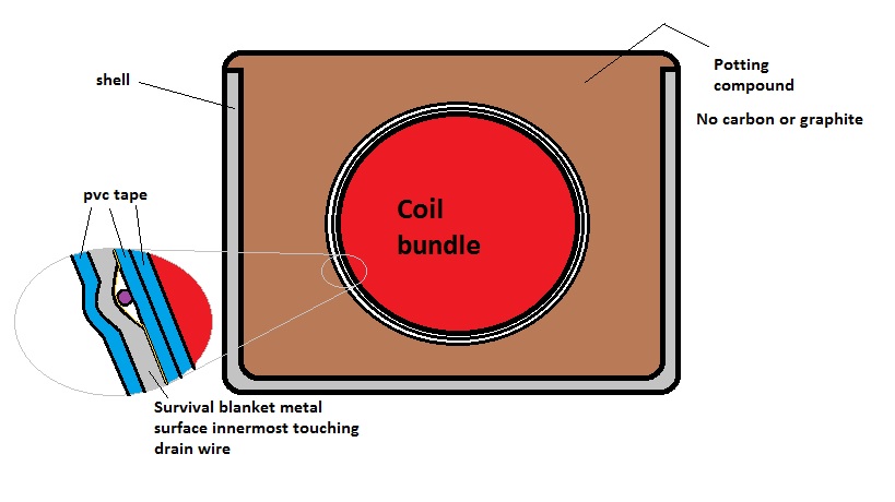

                        • Coil contruction without graphite
                          Another popular type..
                          • HI,,, G/NUT,& ALL ,,, Thanks for the survival -blanket pic ,, ..

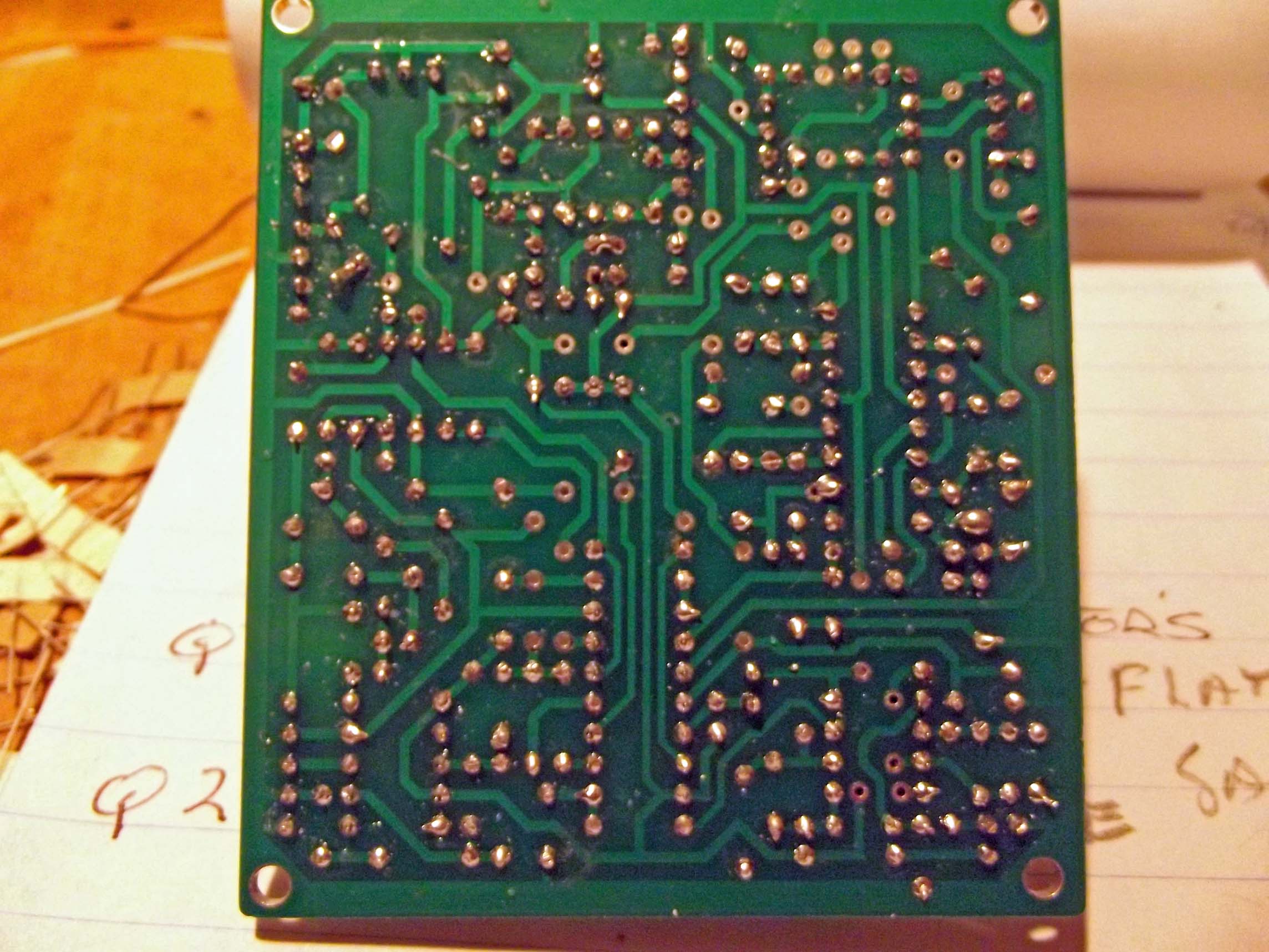

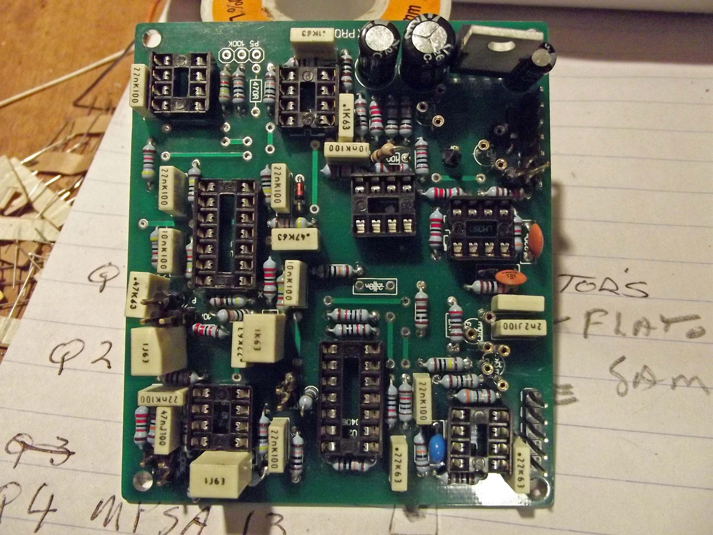

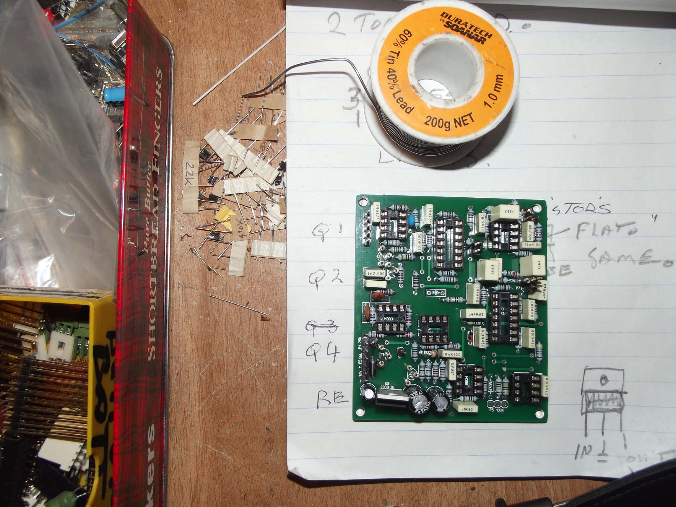

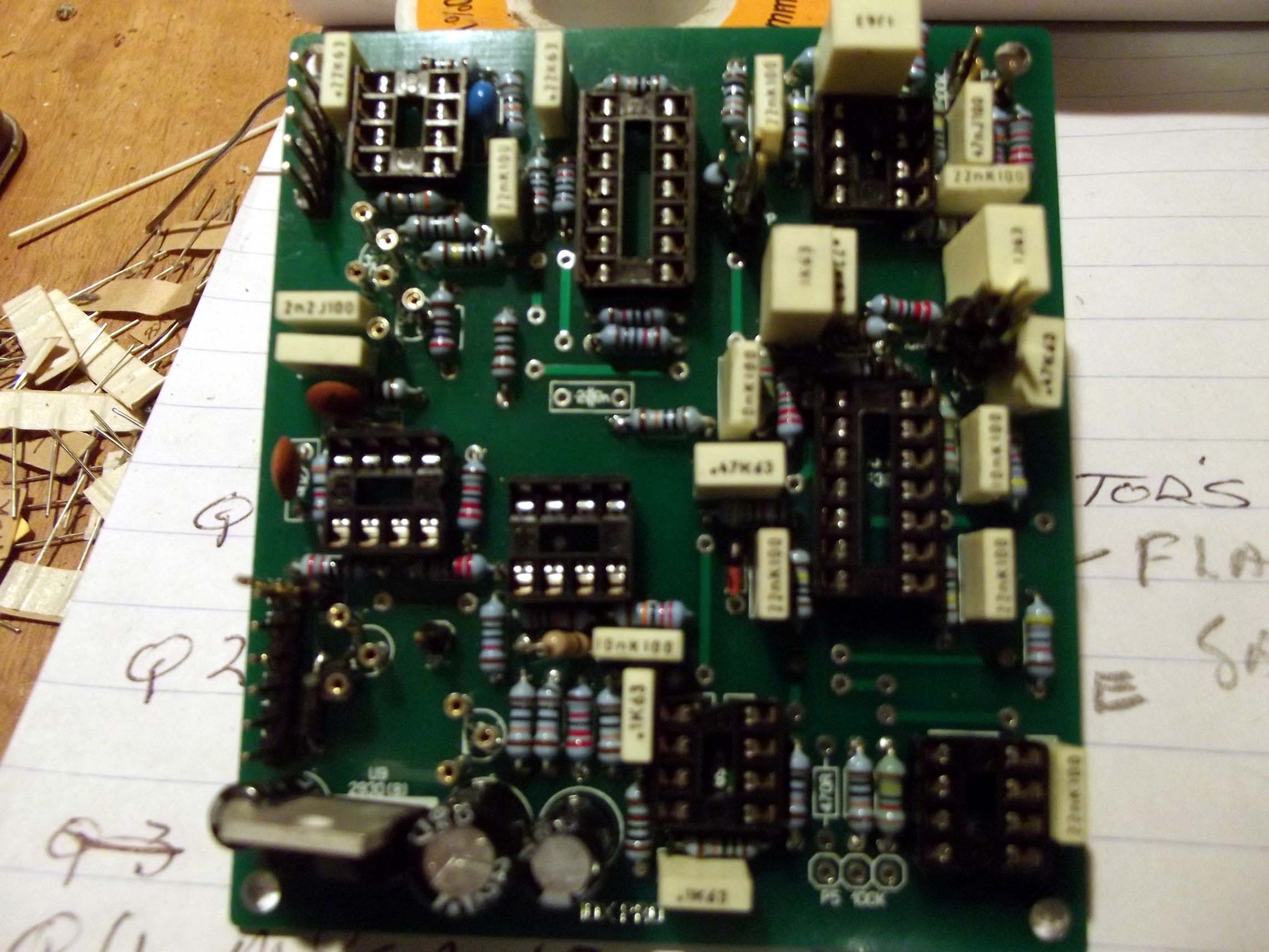

                            GOOD news ''MY KIT has arrived'' so the Shield is on the back-burner untill I assemble that ..

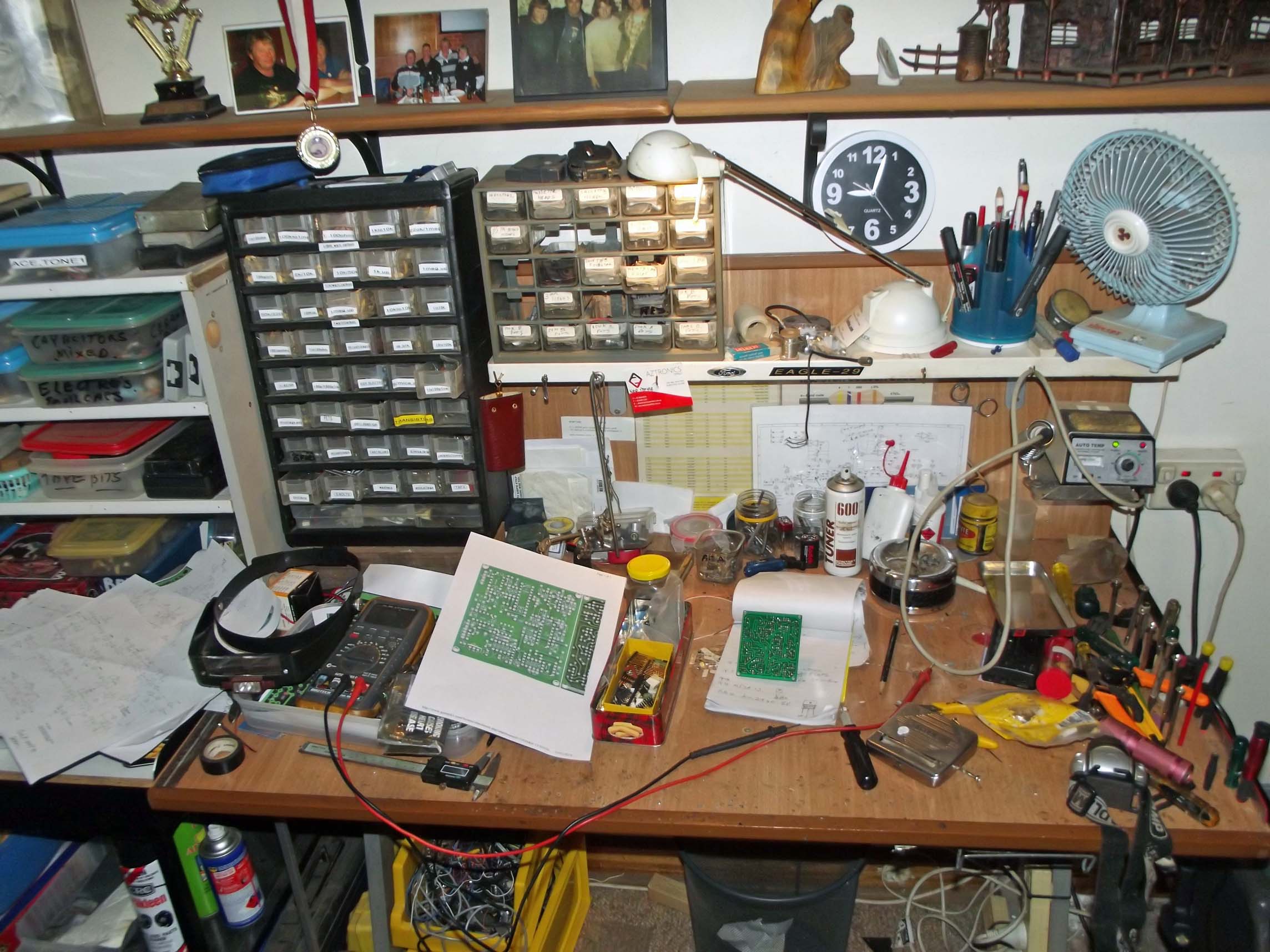

                            The board [IDX-PRO] is much smaller than I thought [Very -Very compact]..
                            I notice a few differing differences to some of the pics I D/loaded from here ,.. This Board has had the short remedied .. [Should I adhere to the Lay-out as printed on the Board ????]as I find theres differences in the Schematic I have & the Parts list ???
                            Well its getting there I order'd a 2 tone Board from S/DOG yesterday for later add-on..
                            I have your posted schem ,,Is that a final Copy ..
                            PICS of progress & my Messy music-room w/Desk ..
                            CHEERS BARRY..
                            • Hi Barry -
                              my advice would be build as per the silkscreen - the schematic is then not a priority.
                              I have requested a blank board from Andy to generate a schematic for your pcb version. Steve
