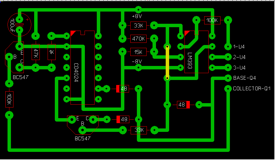

                  • guys there's no way to make it work with 2 tones do not know where mistake or if the circuit does not work, but it 's the second PCB I do, and the last run' this, some of you have ever done and so it worked?
Name:	2 Tones.png

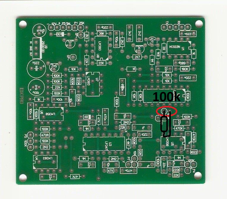

                    • I thiught the dual tone board silverdog outlets is ok, anyone made one and got it going on IDX???
                      • If its a silverdog board - it sounds like your stuck in pin point mode.
                        You may not have fitted the 100k resistor on the cmos switch for PP ... the placement isnt the name as the others ,, the resistor body is vertical and the silkscreen outline is a circle.
Name:	IDX Pro PP pull up 100k.jpg
                        If you flip the PP switch or button and the tone stays the same your in PP all of the time as discussed , fit the resistor.
                        The continous tone is normall PP mode with the VR4 on schematic too high , back it off to no tone then do PP search, thenwhen finished in PP, release PP button or flip switch to other state. PP is not useful with a DD - it is useful with a concentric.
                        P4 on silkscreen is VR4 on schematic
                        In PP sets the tone on/off threshold - adjust to just no tone for PP seaches.
                        In Disc it affects depth perception,, set low user gets quiet for deep, louder for big/close... Set Full -- no change.. all fuller solid note for most targets. Leave full in Disc.
                        P1 on silkscreen is VR1 on schematic
                        Is Ground Exclusion Balance (GEB) In Disc, set geb high and bob coil (dont touch ground) it will false. While bobbing, rotate geb anticlkwise to point where falsing just stops. Leave here for this field. Reset in next field, as required.
                        P7 on silkscreen is P7 on schematic
                        Disc Rejects things like Iron in clkwise position. At zero allows all metals thru.
                        P5 on silkscreen is P5 on schematic
                        Sens - sets the quiet threshold, like a squelch on a radio. Too high and you miss small stuff, too low and chatters

                          • Build from the pcb in the kit. This way there are no errors
                            kit says put 100k here - thats what you do - you get a solid working machine.
