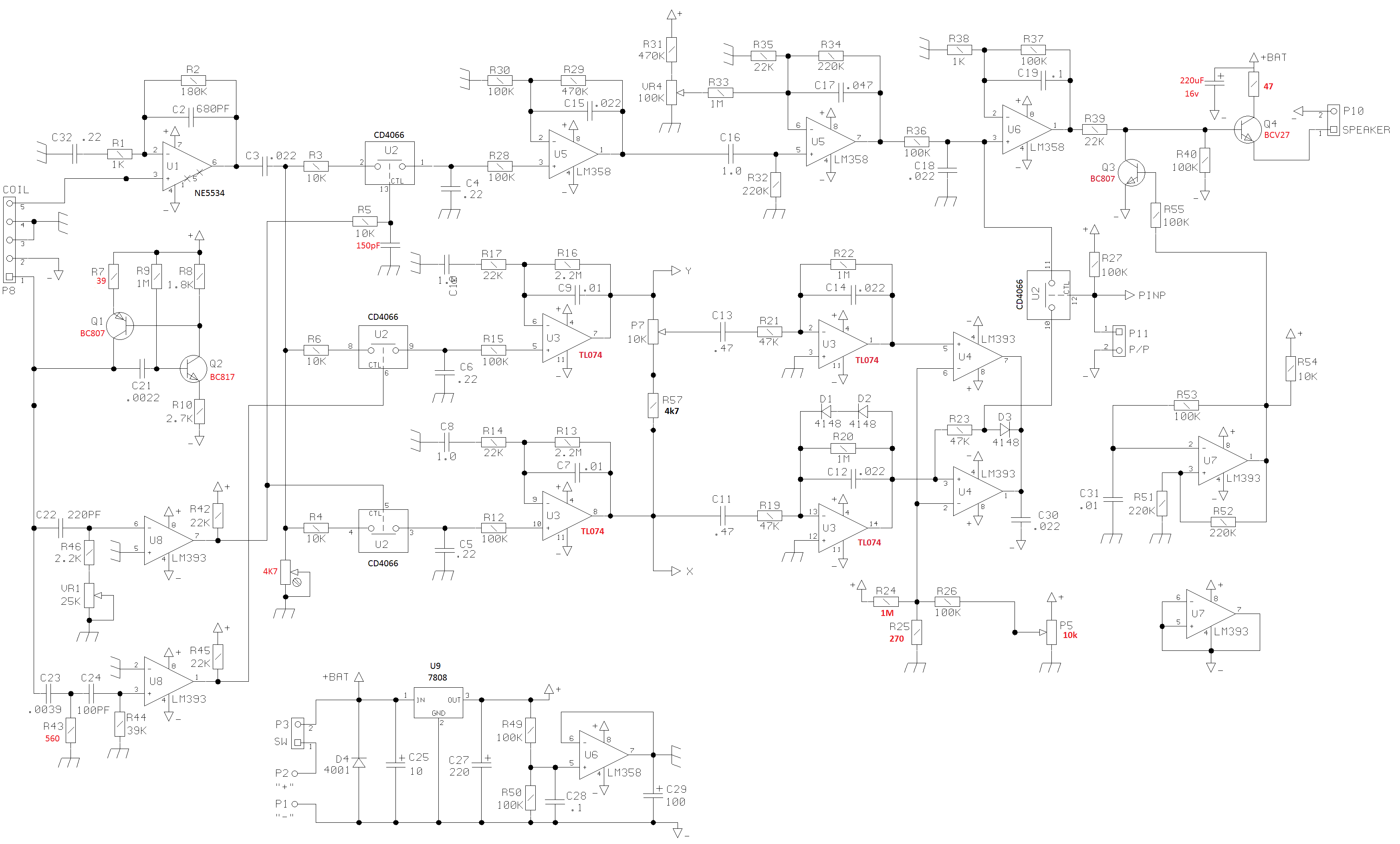

          • DD Coil specs:
            Tx: 592uH 34x0.6mm wire, cap 1.1uF CH1 of scope
            Rx: 34.2mH 260x0.2mm wire, cap 34nF
            Resistance of Tx at coil plug(with cable resistance) is 2 Ohms, Rx 92 Ohm also at coil plug.
            Couldn't null if less than 2.5mV, phase is some 160 degrees, discrimination and ferrite rejection works good.
            U9 is t.h. 7808
            So far i changed: NE5534 and CD4066, no difference, for u3 i tried TL064, TL074, noticed difference in sensitivity, but instability persists.
            Also i added trimmer instead r11 and little 150p cap at pin 13 of CD4066, with trimmer i managed to silence noise a bit.
            Tried to capture the noise at pins 10 and 11 of 4066 as shown in video...
            https://youtu.be/w0RJ0_V4cI8
            This is the sch of my current setup.
            • you might need to reduce the sensitivity with the sens pot as first test, you could also try a different wire to connect the coil to the pcb, e.g. RCA wire where one of the conductors is shielded and IMO all IC’s (U1, U2, …) should have decoupling capacitors in both Vdd and Vss for better stability and should also reduce the noise...
              • sounds a lot like mine when I accidently leave the soldering iron on. I believe some florescent lights also interfere
                • if none of the above works you could also try to tune R43 which might reduce the noise...

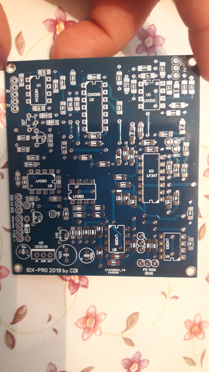

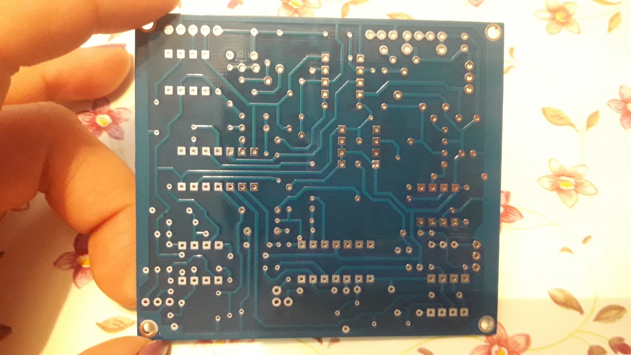

                          • Here is my little conversion, IC's reamin in dip socket, standard elco's, etc. But, smd resistors are now and caps.
                            Maked by JLCPCBClick image for larger version
                            • Looks awesome CDI.
                              Are you willing to share that nice layout?
                              • Originally posted by wallker View Post
                                Looks awesome CDI.
                                Yes, why not... when arrive to home tonight.
                                But, this pcb isn't checked yet. Next week when i got all material's i will know if there are mistake's...
