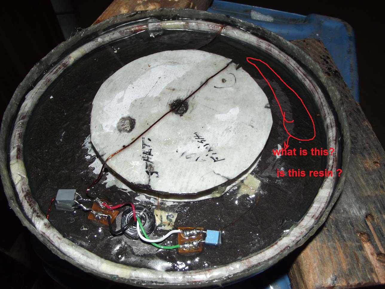

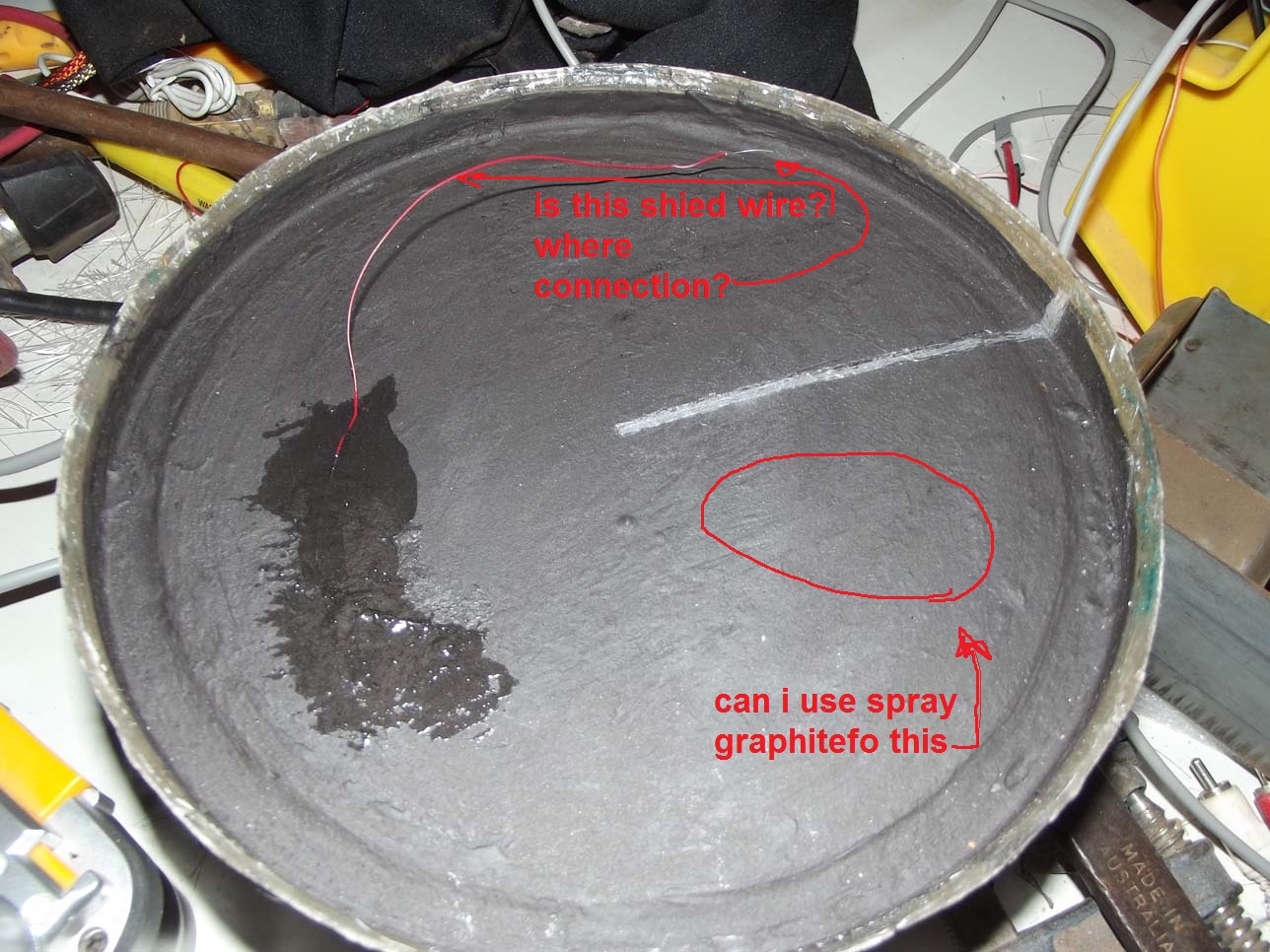

          • who can help me by simple language
              [ATTACH]32466[/ATTACH][ATTACH]32467[/ATTACH]
              yes you could use spray graphite on that, you stick a small square of copper tape down solder the shield wire to the copper and spray on.
              yes its the shield wire, but i cant say where it goes that depends on the detector design.
              and yes that looks like resin.
              • Originally posted by sinclairuser View Post
                i want connect shield of DD coil to that wire,then connect wire to copper tape next connect it on graphite plate.graphite plate means i want use carton and spray on it.i want use 2 plates of carton.one of them above and another Under the DD coil and connect shield to them plates by copper tap .
                it is correct?

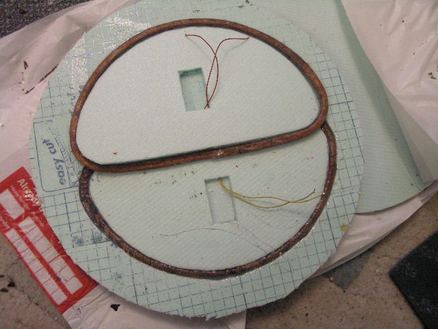

                      This is as far as I have got with my new coil. Gone for spacing the shield a few millermeters away from the coils with some underlay foam.
                      need to clear some space of metal to null the coils also need to be able to leave for a few day as I am using epoxy which does not harden below 20C
