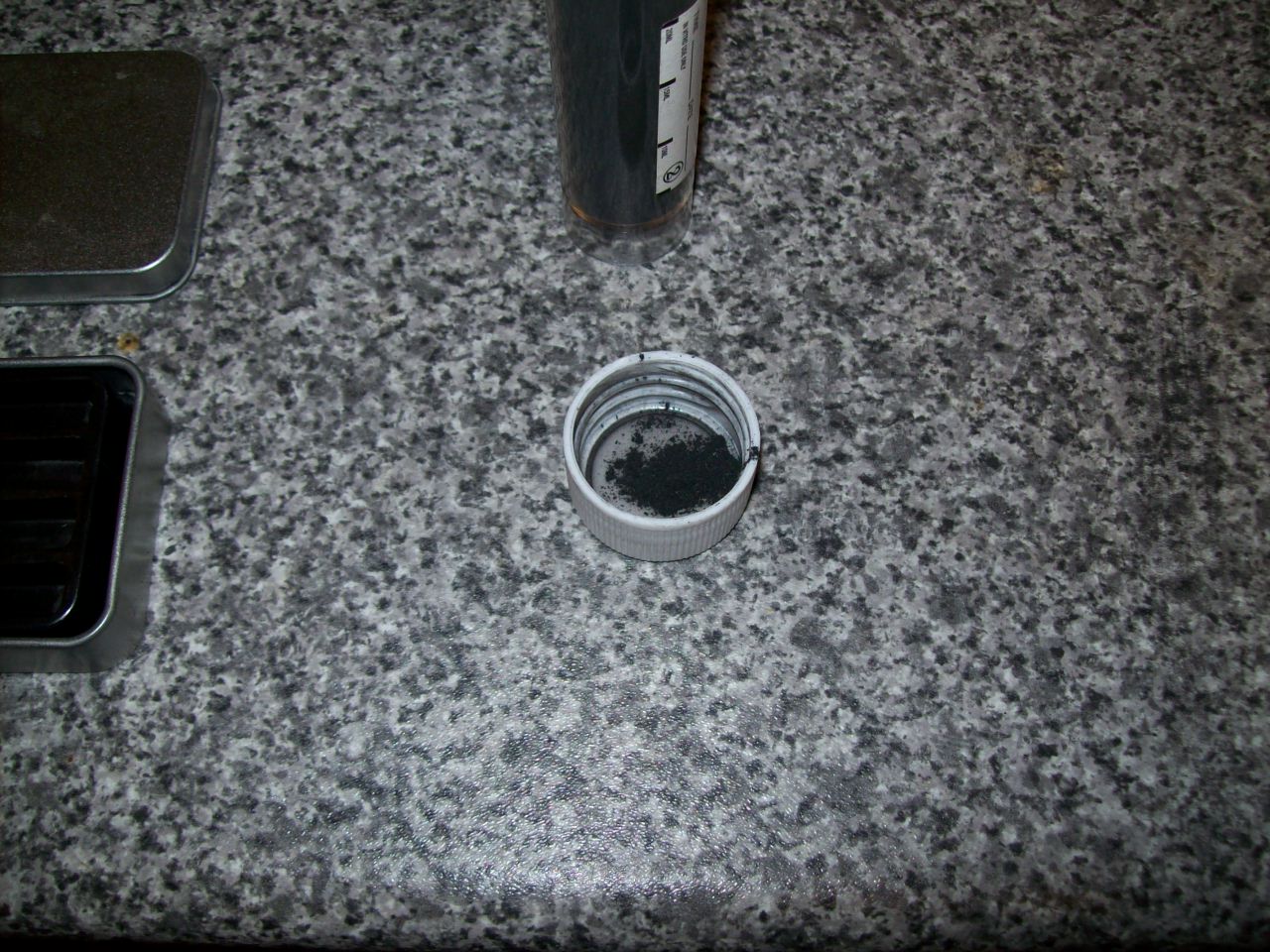

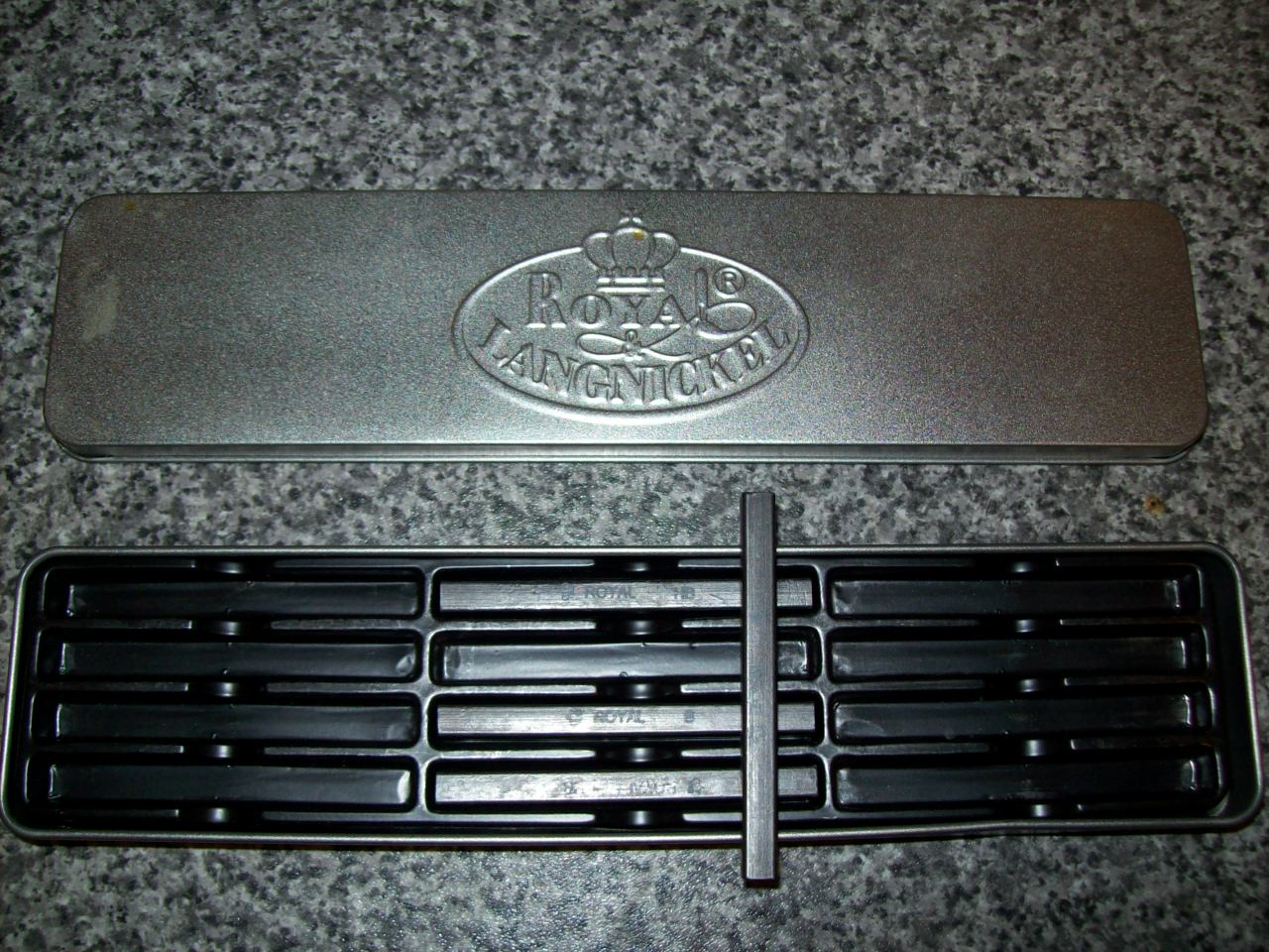

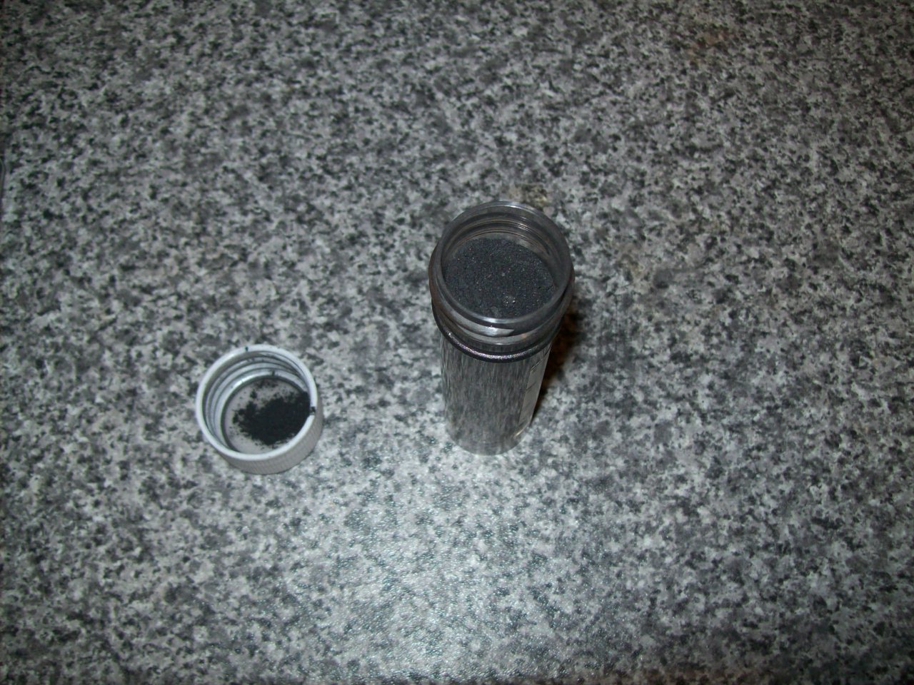

            • what i used were graphite pastels, they are the same stuff as inside pencils they are graded the same hb,2b etc.
              i ground them in a pestle and mortar to a fine powder, i used this to make my graphite paint i tried carbon brushes but they are too hard, these pastels are easy to grind.
              using these would be easier to put a certain amount on the paper.Click image for larger version

              i got mine from the range, but any art shop has them, and they are no more expensive than pencils.
