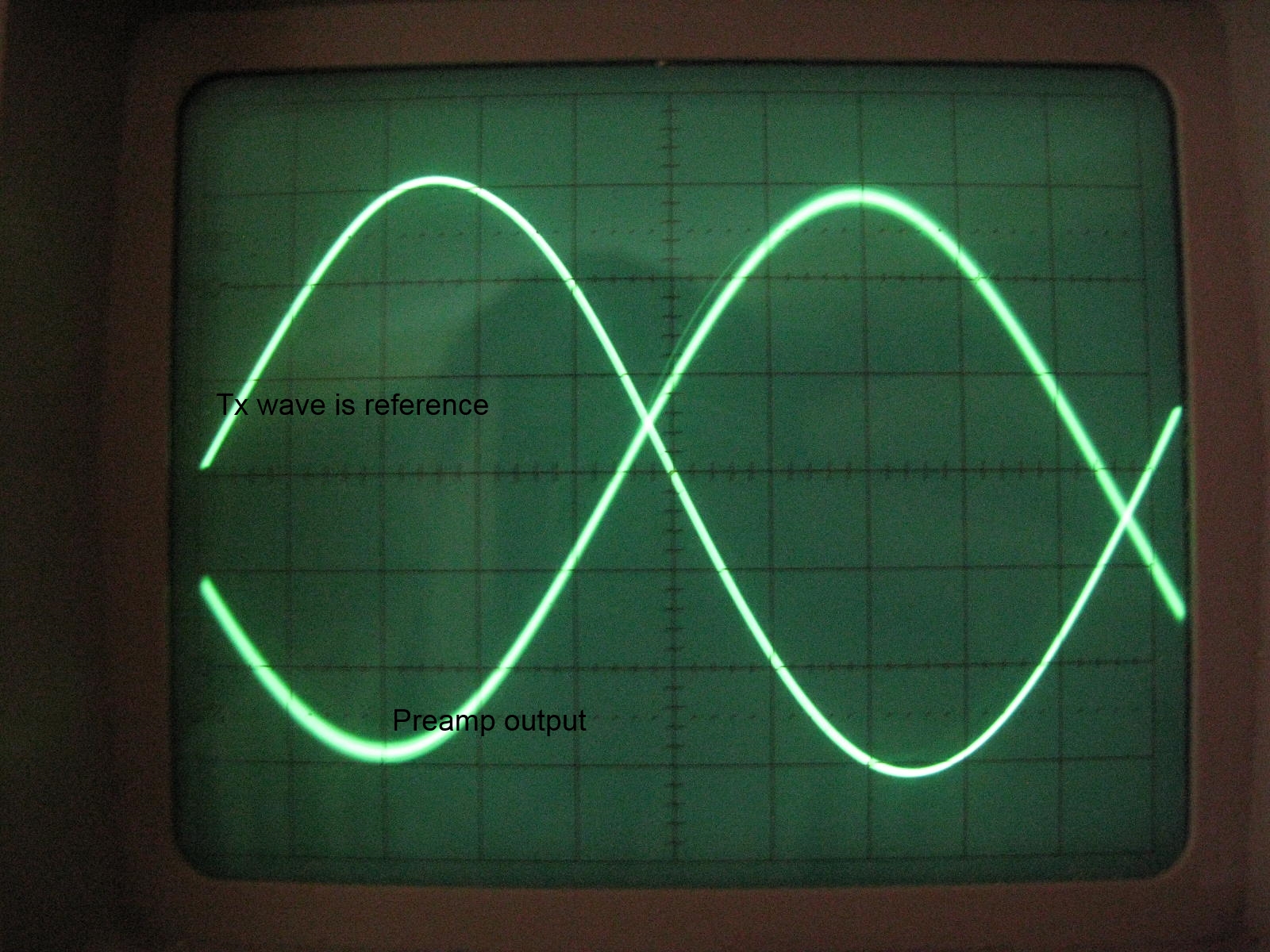

  • Dont go for lowest null value. It isnt important, what is is the phase relation of the preamp out WRT the Tx coil volts.
    A good working unit looks like this Click image for larger version
