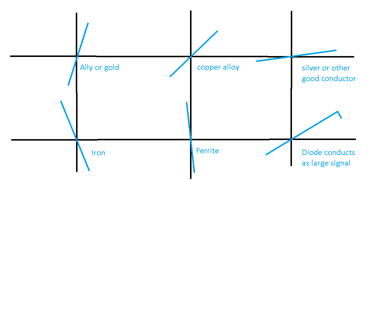

              • Originally posted by ampirate View Post
                Tonights Testing,
                I found I get higher Range, if I shift off the Null Value slightly inward - probably bending coils added Inductance.
                I hooked the X and Y to the Oscilliscope with Gnd of course.
                The Angles I got from Y/X based Oscillator Mode - from Flat Left as 0deg - to flat Right 180deg :
                * 50 Euro Cent - 10deg
                * FOIL - 20deg
                * Copper Penny - 45deg
                * 2 Euro - bent leg 90deg to 180deg (2 metals)
                * 10 cent Euro - 140deg
                * 1/8in x 2in Threaded Iron Wire - 145deg
                * 3in Ferrite - 145deg
                * 5 cent / 2 cent euro - 150deg (Iron ?)
                * Beer cap - 150deg
                * Quarter - 150deg
                * Merc Dime Silver - 160 deg
                * 50 cent Euro - 170deg
                dependig on how u connect the x and y then vanilla xy mode should look like this from memory

                      • Problem,
                        I Null the Coils.
                        I try adjusting the GEB.
                        On the Y/X mode oscilliscope, I see:
                        * Ferrite Rod vary between 10deg to 45deg depending on GEB.
                        * but all Foil, Bolts, Nickel, Quarter, Silver Dime, Copper Penny are all the same at 135deg.
                        Why ??
                        Also, I get a lot better Sensitivity - if I shift (either way) off the Null of 5mA magnitude to about 20mA magnitude,
                        but I lose the Ferrite to 135deg then also.
                        • Originally posted by der_fisherman View Post

                          • not certain of your terminology?
                            Dont mix volts and amps !!
                            I would not do too much XY action at present..
                            Can you make the detector NOT BEEP on a pass with small chunk of ferrite ??
                            - If you cant, nothing else will be right either.
                            • Comment
                              • Sorry, tired in the eyes when I posted it...
                                - 5mV and 20mV
