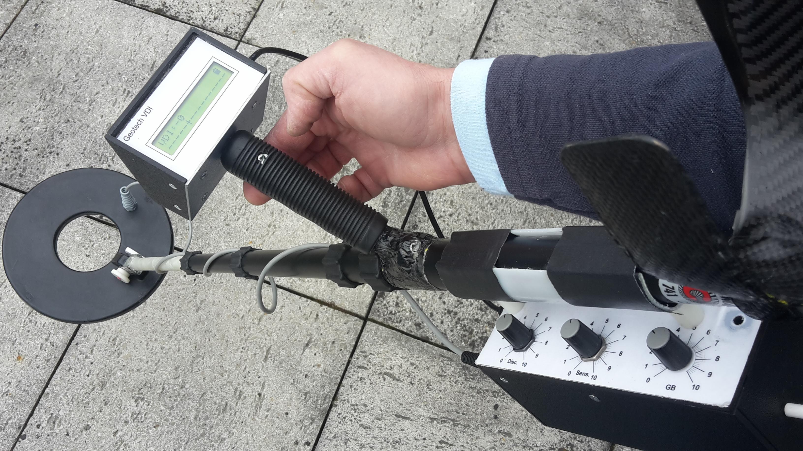

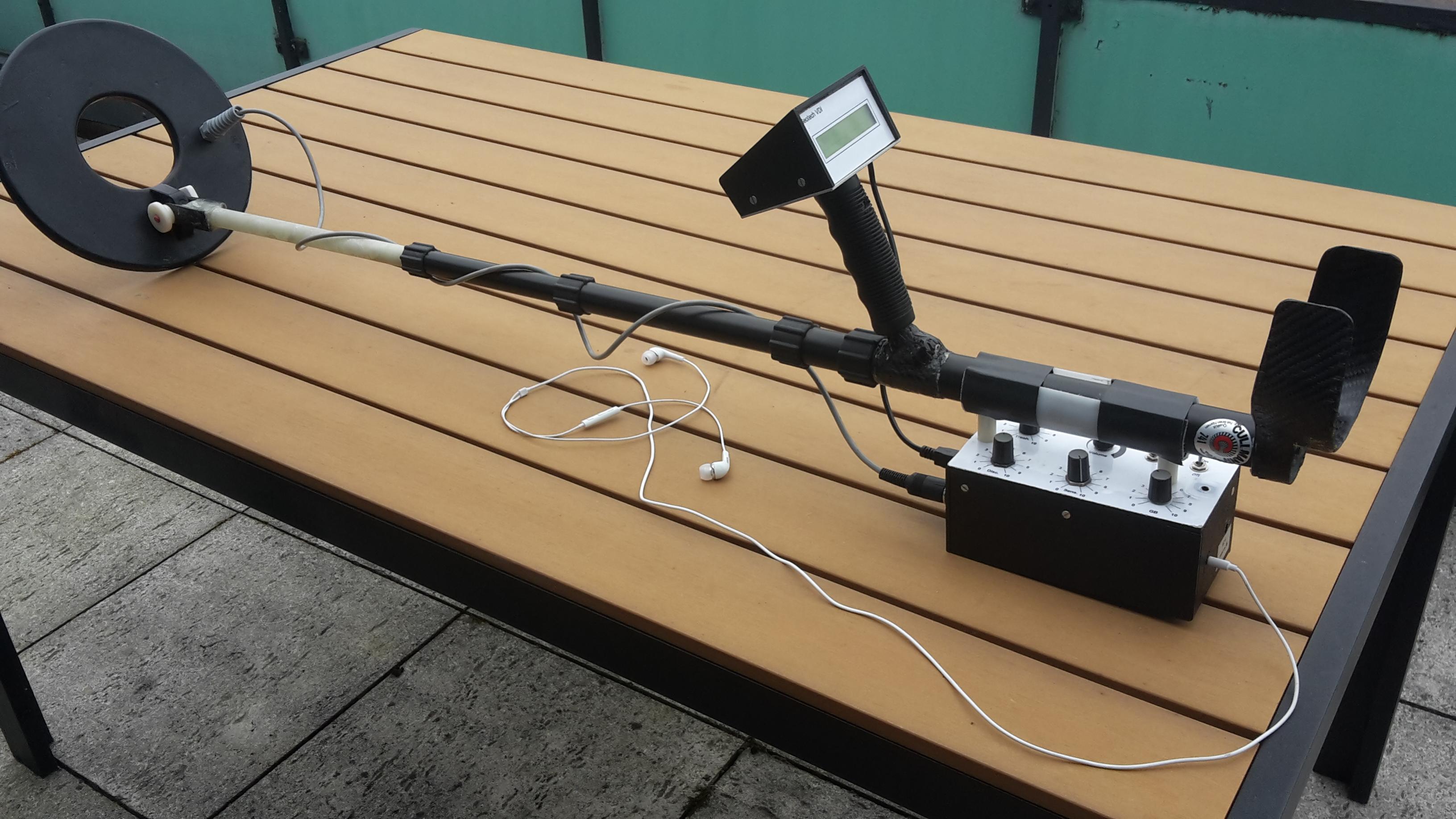

Hi, I did only disc test and if iron is disced out at 3 of 10 it looses about 2cm. I had not made soil because since it's finished it rains, but I hope for about 20~25cm with a normal sized coin. Others have made soil depth test maybe they can tell you more. I had an original Blue Max 950 coil for testing and it performed the same as my DD27. Max air depth was 41cm with a Hungarian 200Ft. With LF347 you should get pretty good performance.
IDX-PRO+VDI
Yes, it can be unpacked for 2 second's.Originally posted by NĂ¡ndor View PostThats very nice man
! We hade the same idea even the foam grip is the same
black with red! Is your stem made of 2 piece's can you separate them? Thats what I wanted to do but have no idea how to make it. I like the coil thats my favorite of the White's design. You helped me a lot thanks again!
It performs very well, about 42 cm for 1 euro coin.
I had 2 tone board, but not working so good, it's giving iron tone on soil.
Yeah, coil is from XLT, but my second IDX work's better into mineralized brick's with double D coil.
I will post pic when finish.
My IDX setup made in 2012, but the rod I use also for my TGSL and both Krot. With the concentric, I have only 30 cm in air for 1 Euro and with the DD 35 cm. But the concentric I like to hunt on the beach, I never dug deeper than 20 cm for coins and rings. Both coils are made with aluminum foil shield. Next I want to make a concentric coil with graphite shield. Maybe I can get more deep.
What else I can do get more? Any comment would be fine :-)
Maybe CDI know more?

Delete 47R near U4 and set trimmer pot abot 10K, also 1M near U4 replace by 2M2. This will give u more sens. Next, try to match U4 with more gain, the same thing with U3.
About U3 (LF347) i bought 20 of them, and only 2 were realy good, deeper for 15 - 20%.
I deleted R7 and soldered trimer 200R for perfect amplitude.
If u decide to make your own coil, use 330N for TX stage, and 8 - 10 for RX.
Now freq. should be aprox 12 khz.
My coil's are shielded with graphite, i use Graphite 33 in spray, u can buy in Conrad, i found in Austria.
It is aprox 1k per inch.
That's almost all.
Great and realy deep machine in real soil, not only in the air.
Btw, realy nice looking, i like long stem. Look's like factory made.

Many many thanks CDI, I will try soon your advisings. I never thought about to buy more IC's, than I need. But of course, they also will have some tolerances, even in such industrial processes.
Btw, my stick is made from a foto mono pod, with a homemade fiber plastic tube, for the first segment.

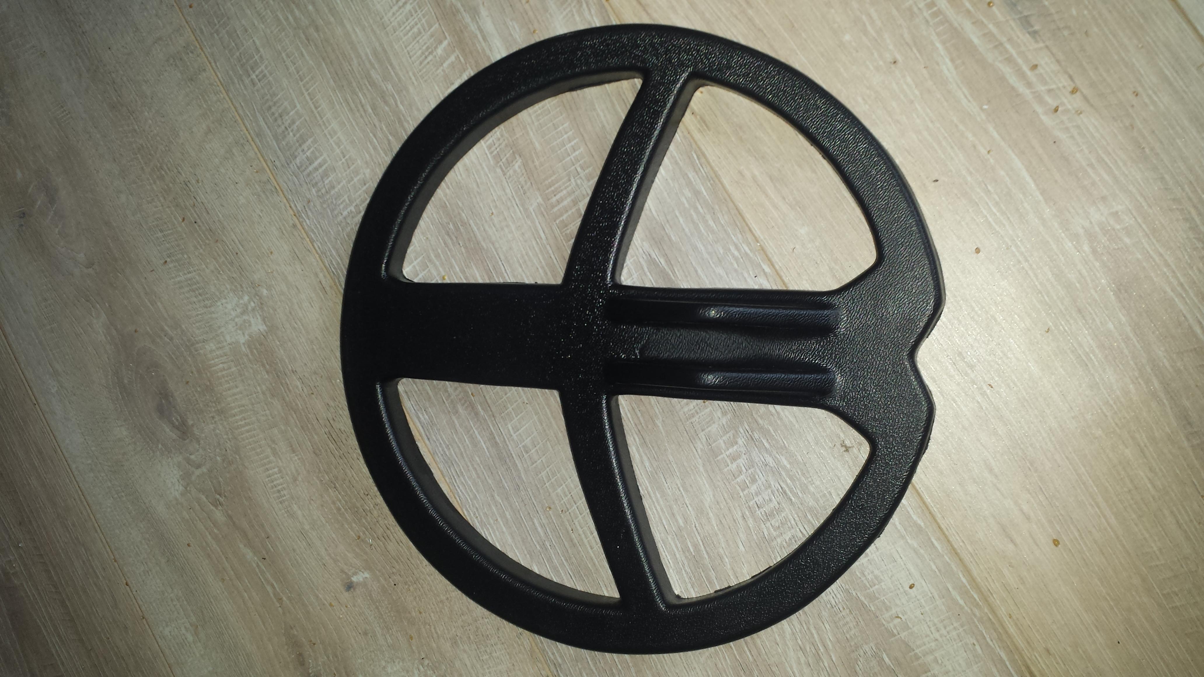

Right CDI the link for your coil housing is not working, please do a new upload!
But anyway, vacuum forming is a very great way for diy projects, to get easy a perfect results.
Very nice shape, looks perfect and professionel...cool.
I realy like the surface, what is the secret, to get such surface structure?
What is your plastic sheet thickness?

I just made wooden mold, my friend made housing using thermoforming method.
Sheet's are 2mm, this is enough for housing, very strong.
About the surface, i think u mean texture? Well, u can buy diferent textures sheet's, i like this.
