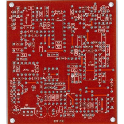

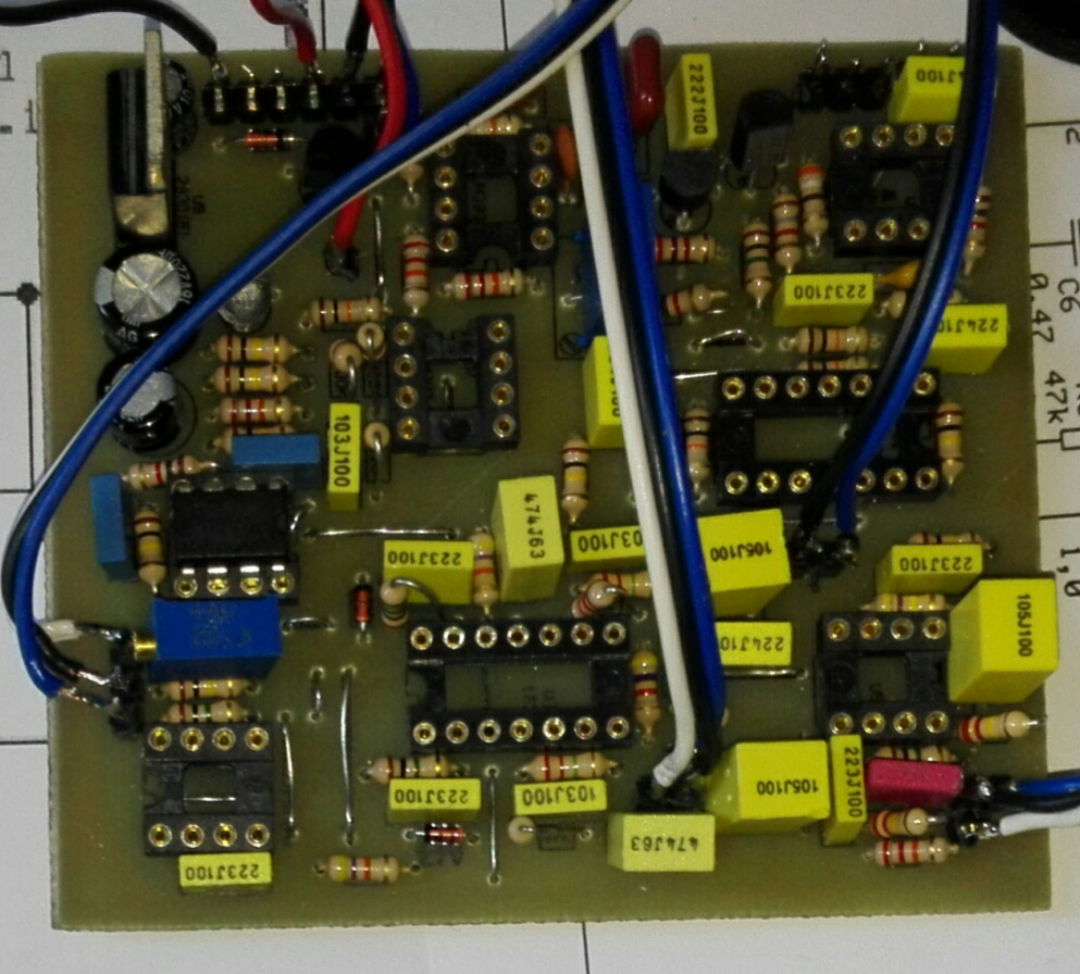

                        For U3 i have LF347, but i bought 20 of them and changing where found one which can reach best distance. Can u make photo from top side of pcb?
                        • Originally posted by CDI View Post
                          Now I only have photo without IC's. If you want better quality or with the IC's just tell me - tomorrow I'll take one. What are you looking for?

                          • Originally posted by cacekspoko View Post
                            [ATTACH]38259[/ATTACH]
                            This is not last version. U have there 3 1n4148 zener diodes, version with only one 1n4148 has litle better disc. But u can easy modify your pcb.
                              This is last update.
