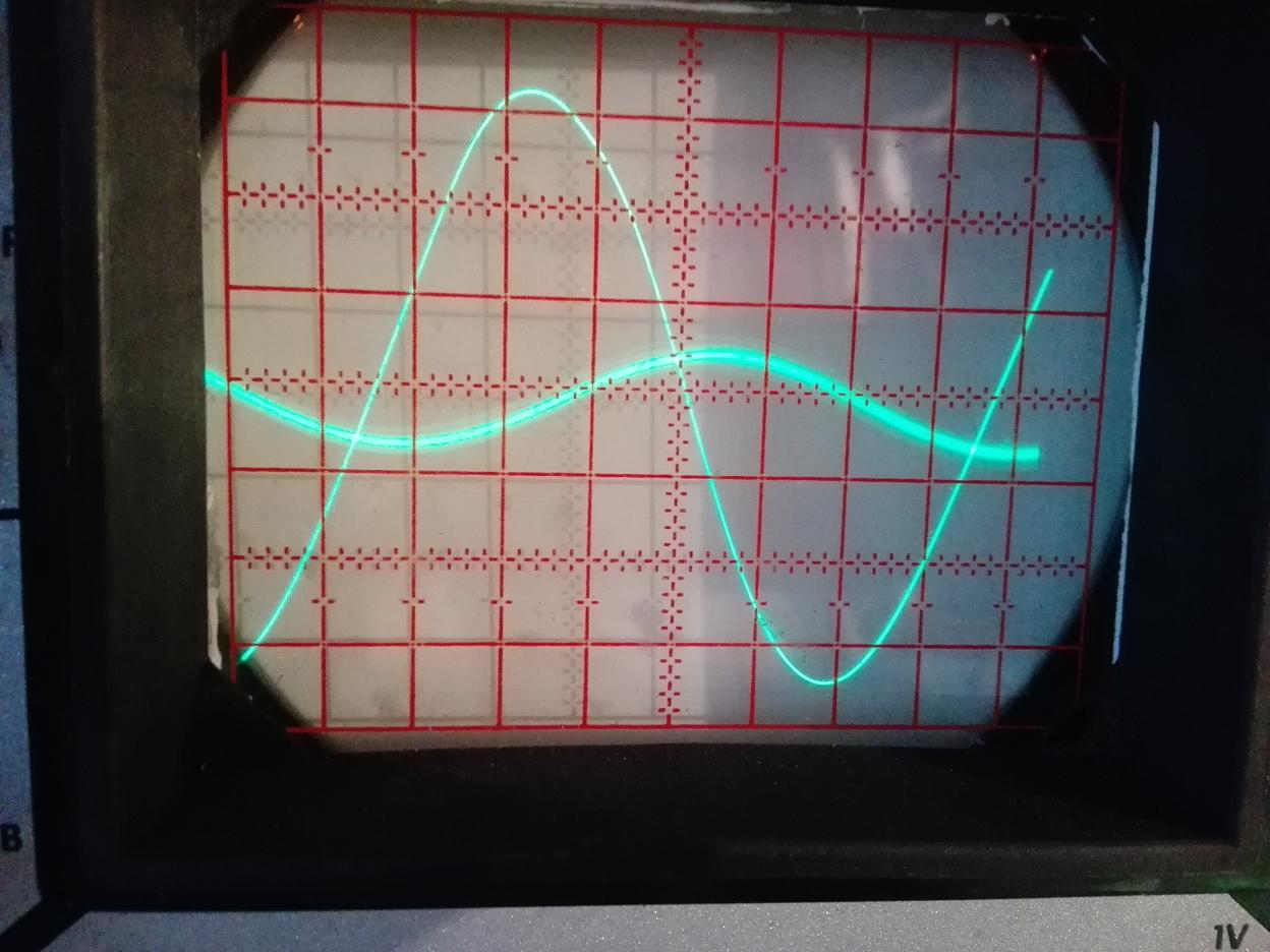

  • I fix a wave for rx and its ok but still the wave of tx asharp and bigClick image for larger version

    • What do you think could be the problem

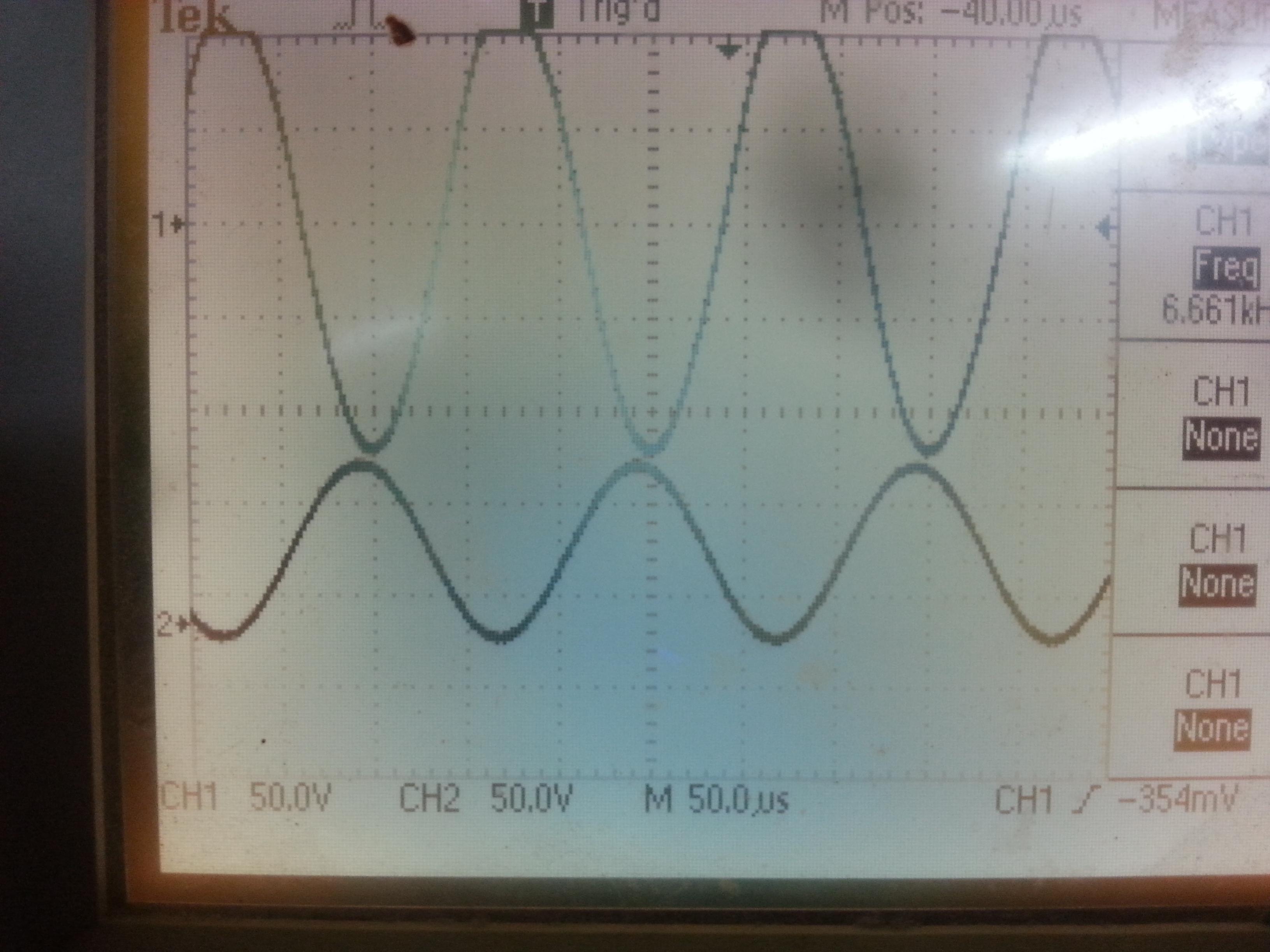

                        • Hello,
                          I have problem with my IDX. I made dd27 coil:
                          TX 530mH 0,7 6,60kHz 14Vpp
                          RX 35mH 0,15 4,64kHz
                          TX/RX phase about 90 degrees 150-200mV
                          Discrimination and PP works well only the GEB has a problem. I have 50k pot for the GEB and ferrite is invisible untill I set the GEB pot to 2kom then is visible to 50kom so the regulation is very unuseful. How to set this point in the middle position of the potentiometer? I increase 220p cap to 330p, decrease it to the 100p but no change. Any ideas, help?
                          • Originally posted by cacekspoko View Post
                            Hello,
                            50k is a lot of ground to control, rather 30k. Set ground control to the middle position and the selection of the reception capacity of the winding device to Achieve never seen ferrite.
                              Hello,
                              Sounds like the phase is too far out. Try changing the RX capacitor a little
                              • Originally posted by Artyom View Post
                                So RX coil needs correction number of winding? But what with recommended RX resonance frequency? It will be change.
                                Below is my TX/RX coupling
