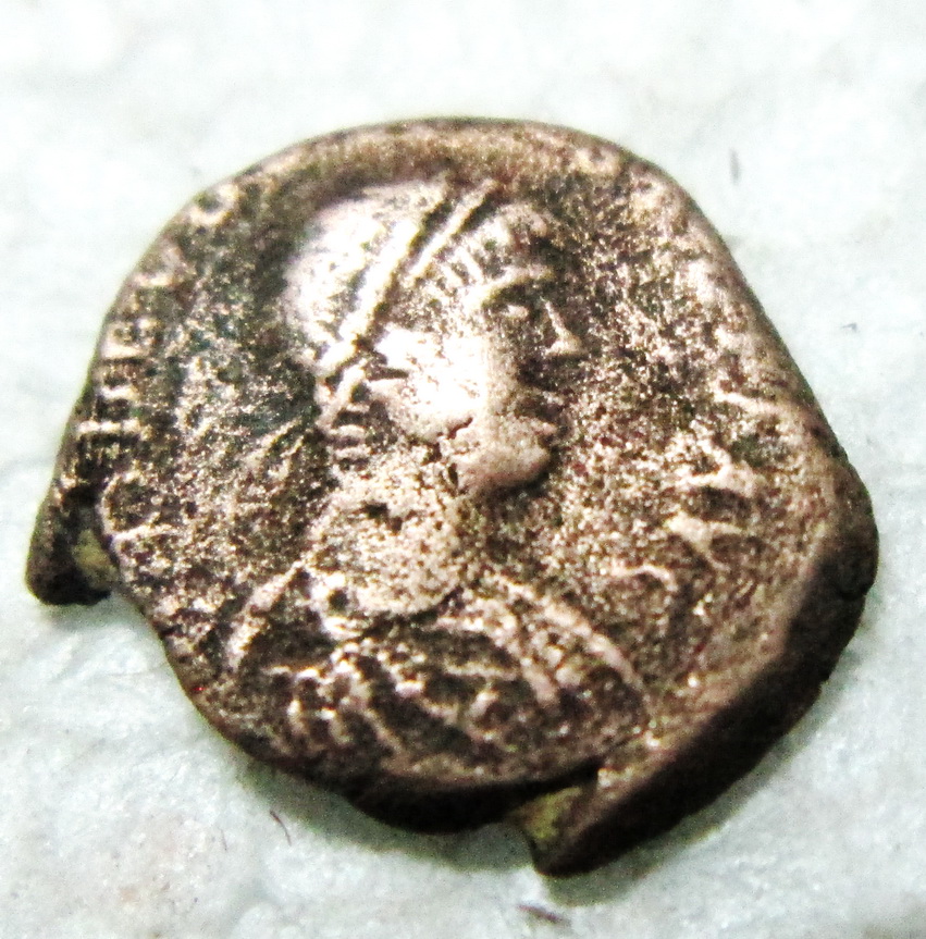

        some idx huntsClick image for larger version

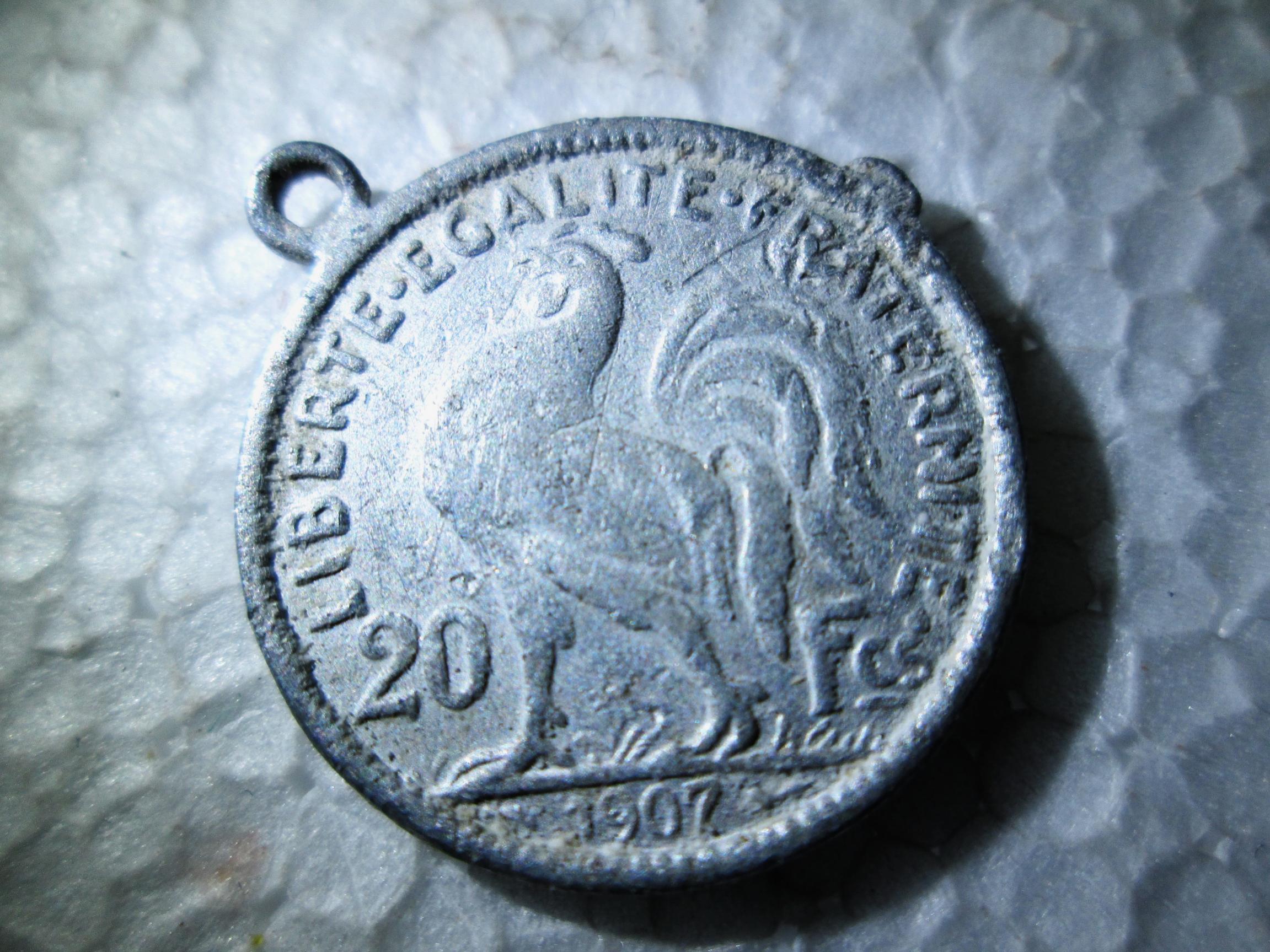

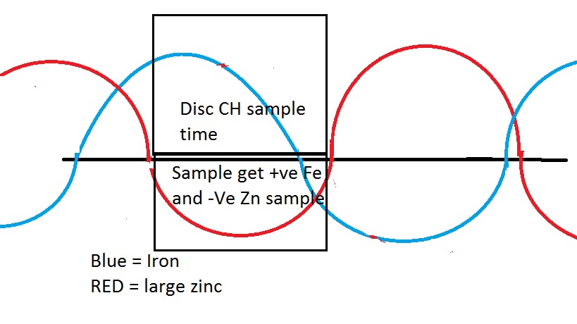

        • matbe if the phase response of the large Zinc was like ths pic you wouldnt here it.
                [ATTACH]33116[/ATTACH]
                hi
                can you explain more pic.regards
                • Has anyone tried large zinc on a working detector. Not the sort of thing I have lying about. Large iron plough (plow) shear has a bit of discrimination (broken sound) even with the disc on 0 and nails still sound fine.
                  Would not be suprised if large zinc did not overload the detector also but can't test.
                  • i balance ground in disc mode by
                    ferrite as soon as i hear cracking sound it accept both silver and zinc and go to hunt
                    Balance the machine over the ground your hunting. The same as any othe manual geb machine
                    Leave it in Disc.
