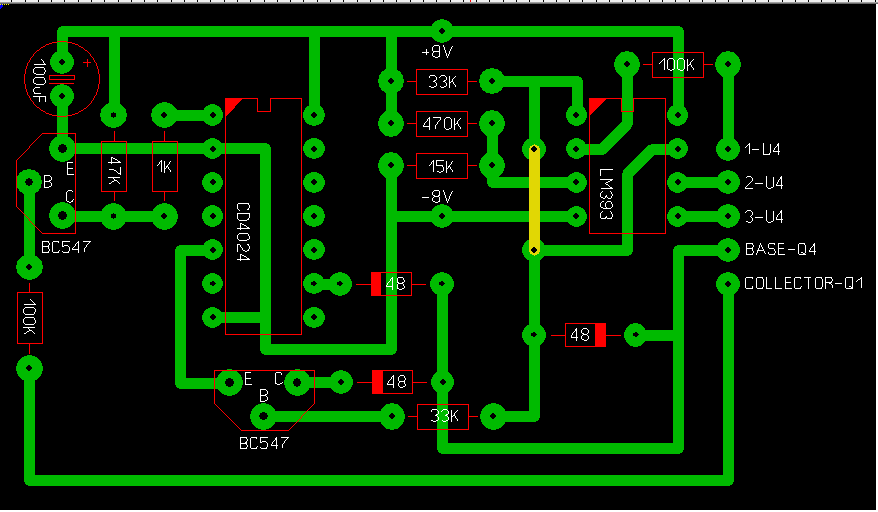

                        • HI all
                          please put the complete & correct pcbs for this detector together here.ALL pcbs my means.
                          thanks.
                          please
