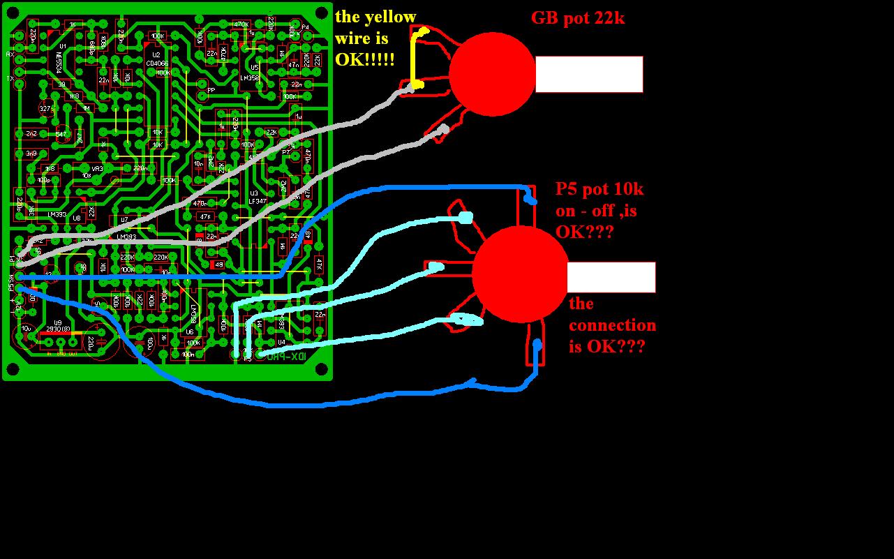

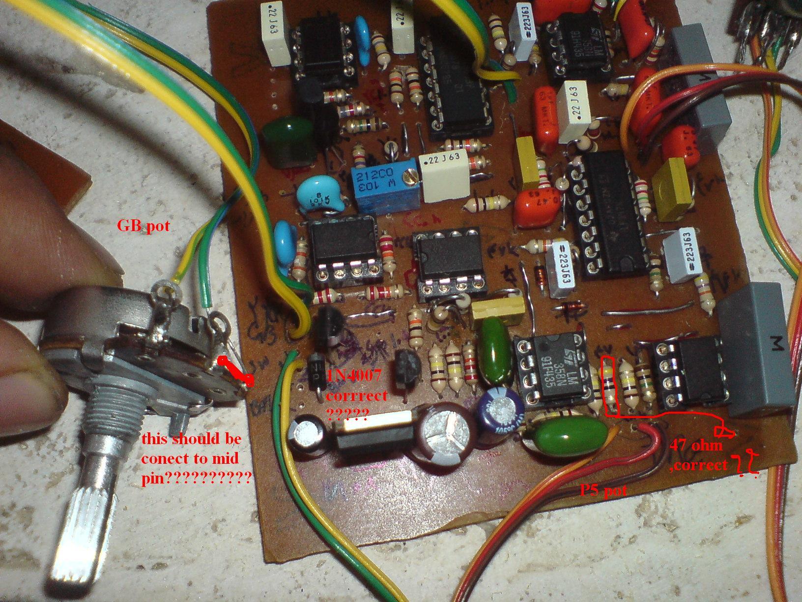

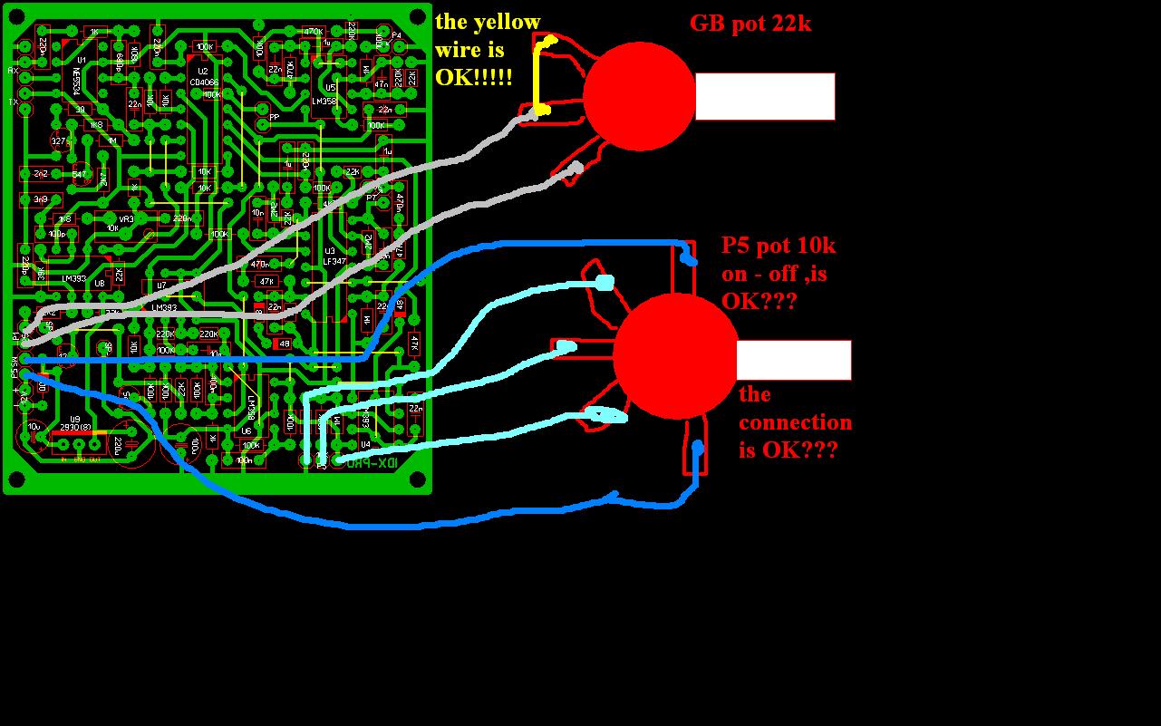

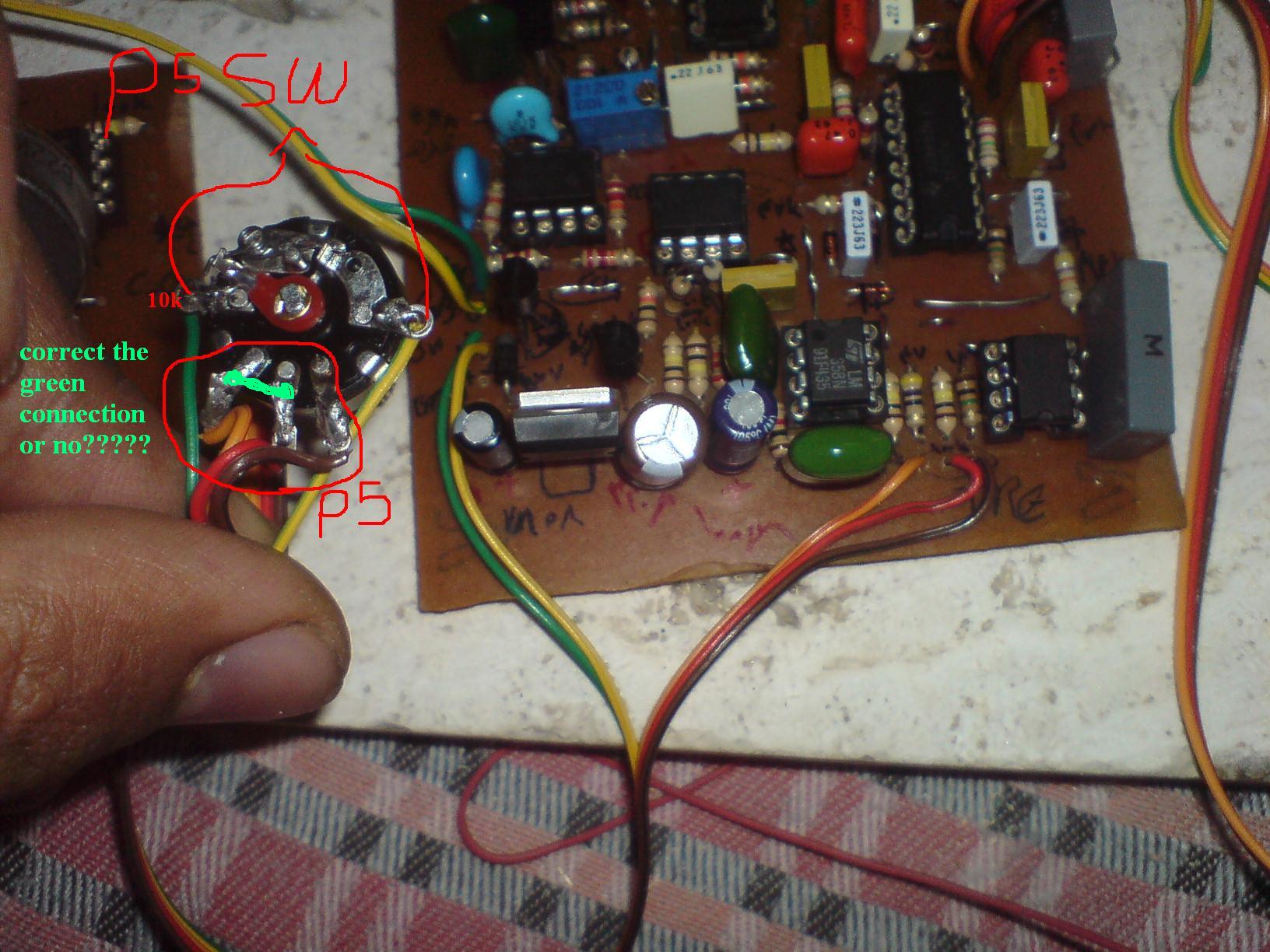

            is this the correct way to wire the encoder
            just comparing the drawing with the physical encoder picture
            tag #7 looks like the tags on the body

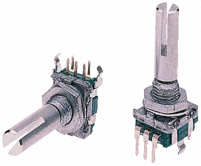

            HI
            mr 6666 i can not find this pot in my country , what is this name (completely)?

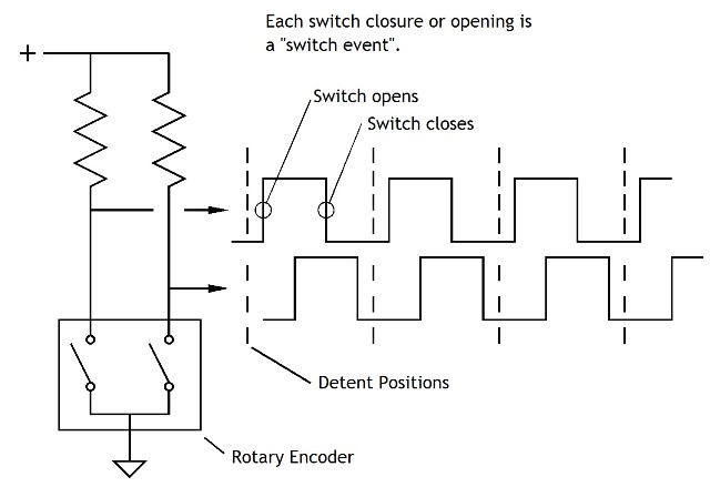

                In post 457 what we are talking about is a rotary encoder, it is not a pot.
                inside it there are mechanical switches that operate (open and close) when you push the shaft and turn the shaft,
                the switches can be used to make pulses and the pulses can be counted,
                if you look at the schematic symbol you will see the switches, is that ok ?

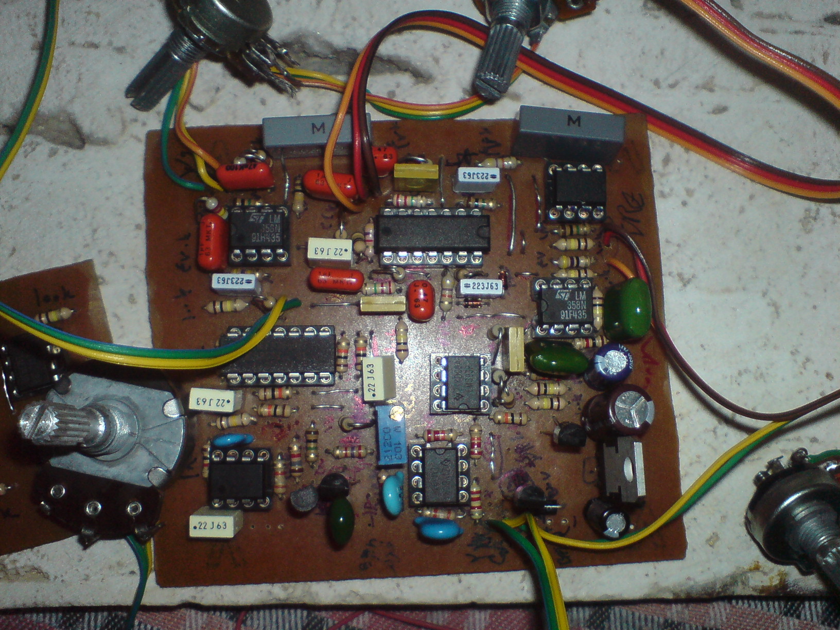

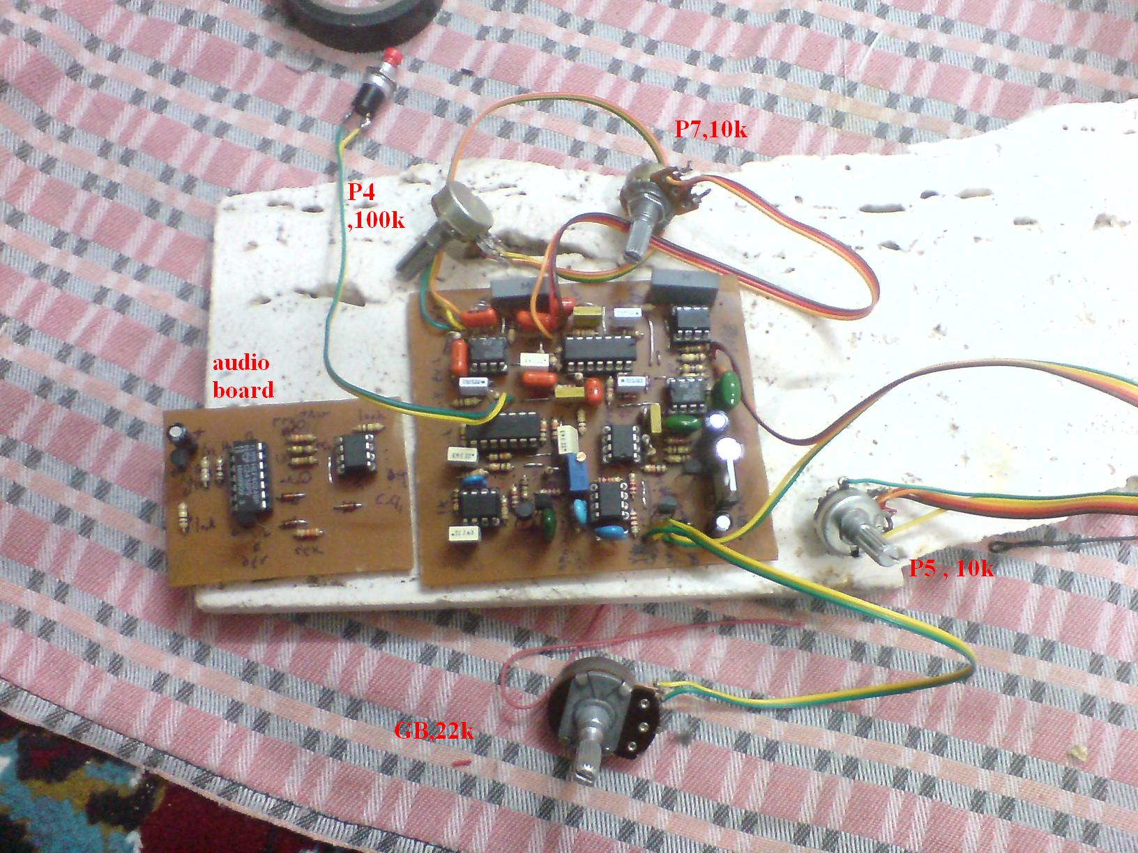

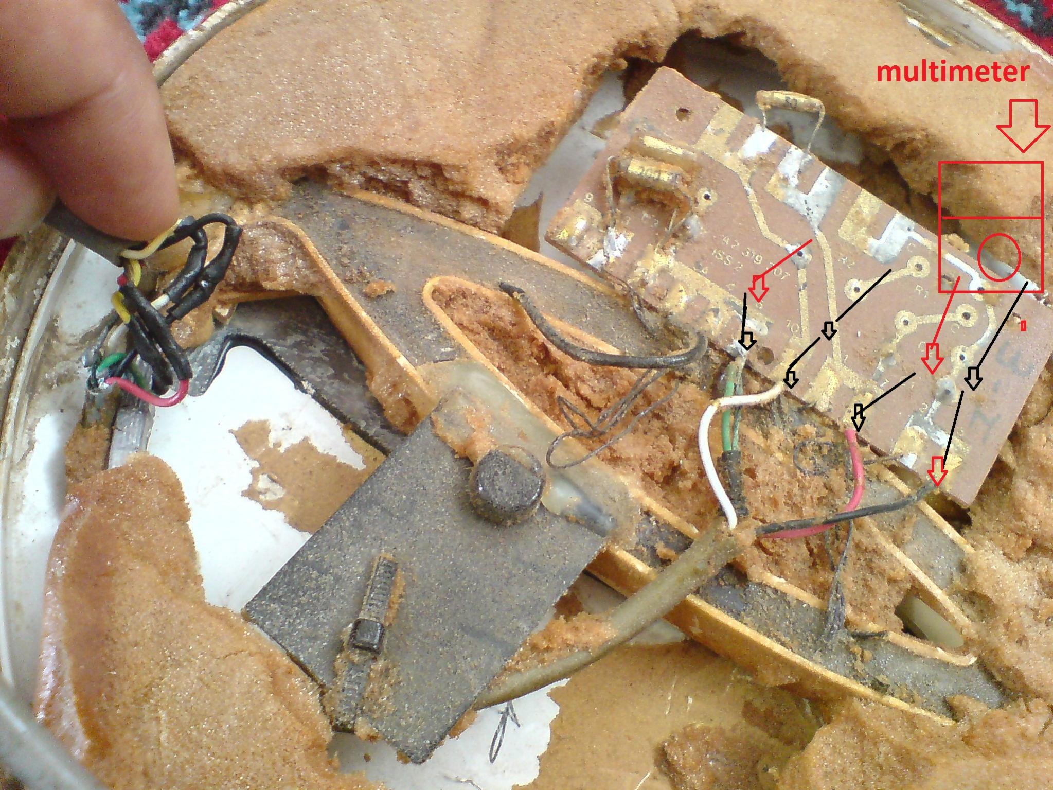

                    • hi all
                      please see ad avswer

                      edit :
                      Can i use coil of cscope metadec for this detector ?
                      how the connection to the board??
                      about the PIC not equivalent
                      thanks

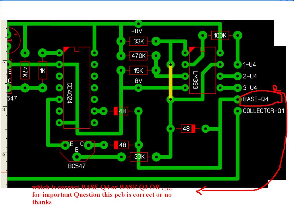

                      • please tell me
                        i read to page 60 and finally solve all my problem except some .
                        GURUs tell me about my ? in the pic please,first Ques for Guru

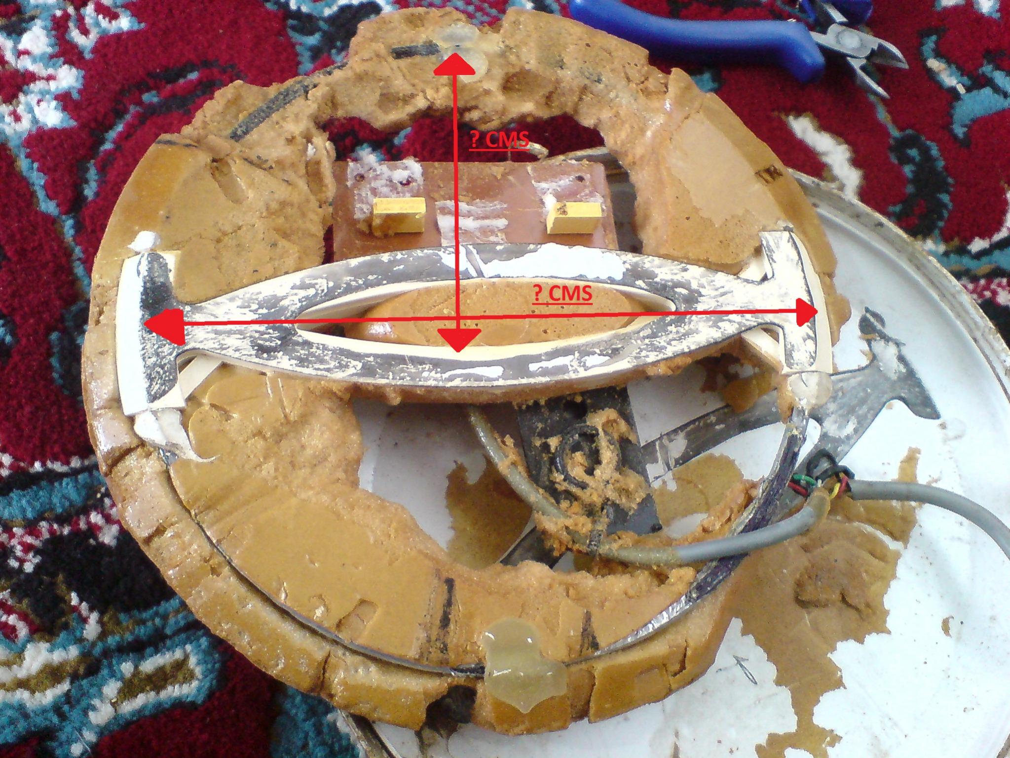

                        Mr Don
                        can you help me to make this coil ?please

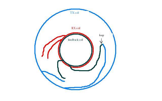

                            IDX Concentric coil: Click image for larger version
                            - tx winding diameter 240mm ! tx 0.72mm, -29 winding 1,6 ohm, 0,523 mH
                            - rx winding diameter 120mm! rx 0.2mm,- 370 winding 80,2 ohm, 35,2 mH
                            Data for the concentric
                            - feedback loop , diameter 113mm ,10-12 winding 0,6 ohm, 0,019 mH
                            wire 0.72mm .
                            Data for the concentric coil !!!
                            black max coil !!!
                            greeting !!!

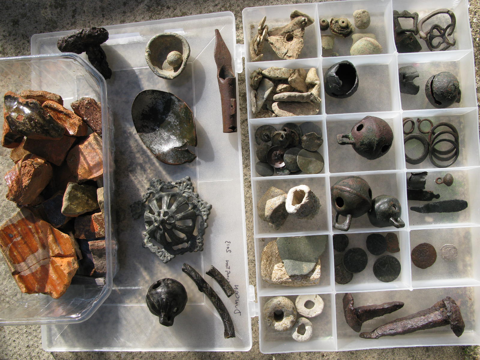

                            • Been looking at my other permission. Farmland with medieval history, plus Ive discovered a small amount of roman.
                              The small hammered is edward VII from ~1490AD so fits with the medieval nails and pot thru the post medieval.
                              Been a great summer with the idx. Ive no idea what the lattice cover plate is, it had 2 fixing holes and looks like a vent cover?
                              right columm
                              buckles, crotal bell, rings, (roman button, saxon strap end, late med strap end, thimble), nuremberg jetton/ ed VII penny, Medieval nails.
                              Column mid
                              rubbish, crotal bell, crotal bell, crotal bells, (mixed coin, roman, 1695 farthing)
                              left col
                              lead washer, mixed lead, buttons, cast pot leg/lead handle pour to fix blade into antler handle, pewter sherd, spindle whorl, loom weights.
                              lid..
                              pen knib shape is musket ramrod end guide, dark linear bonze parts - patterned, Unknown.
                              Lead gun powder measure, plated copper alloy spoon bowl whaetsheaf maker mark with W M, pewter ornate vent?, older crotal bell
                              pot, clear, black, green, beige glazes..
                              All of the copper alloy and Iron has been preserved using the microcrystalline wax method.
                              FLO is gonna have a heart attack using up their pad..
