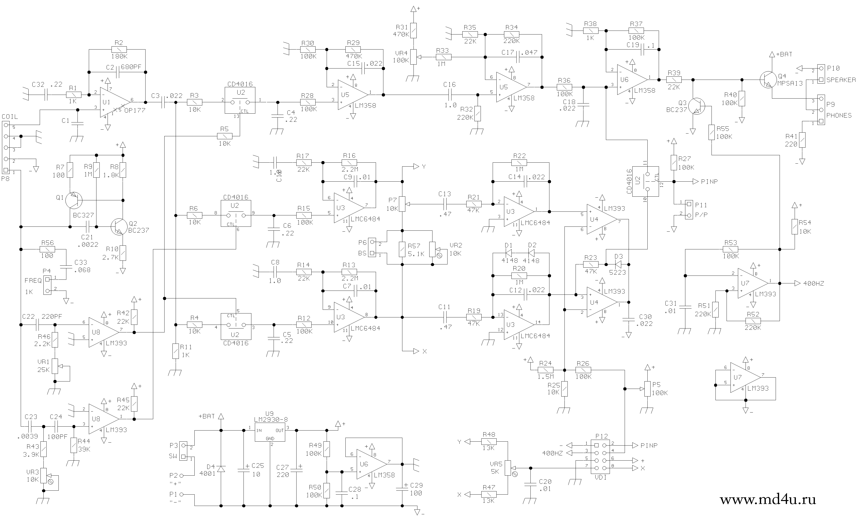

    Hi Eduardo,
    can you please explain that sentence for me as I simply don't understand (too long in Germany!) exactly what you wanted to say, sorry.
    Andy
    The two capacitors of 1uF both 33nf like go into the search coil and run parallel to the coils. The 1uF capacitor in parallel with the TX coil and 33nF capacitor in parallel with the coil RX.
      TX=35 TURNS 0,70 +1uF PARALLEL CAPACITOR
      RX=270 TURNS 0,18 +33nF PARALLEL CAPACITOR
      FOR DD COIL 27CM.
      inductances?
      thanks
        The P4 in the scheme is to adjust the frequency as long as there are 2 metal detectors looking for the same type very close to each other. PCB is the Threshold p4. I did not know what you mean, a PCB or electronic schematics.
        I'm referring to this schematic ->
        • The Freq. adj. was omitted on the Eduardo board. I think what he means is VR4.
          • Originally posted by Amalio View Post
            inductances?
            thanks
            TX=0,587mH
            RX=36,5mH
            • Originally posted by Wiltran View Post
              Yes.
                Yes.
                OK - thanks.
                Do you have a schematic that matches the PCB layout?

                    I have not. There are very few modifications. The detector is almost like the original. I modified a bit sensitive stage. I canceled the frequency potentiometer. No major changes.
