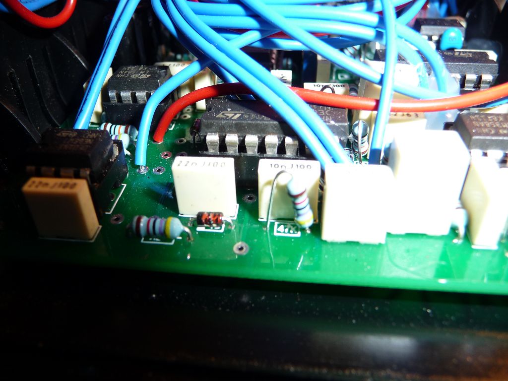

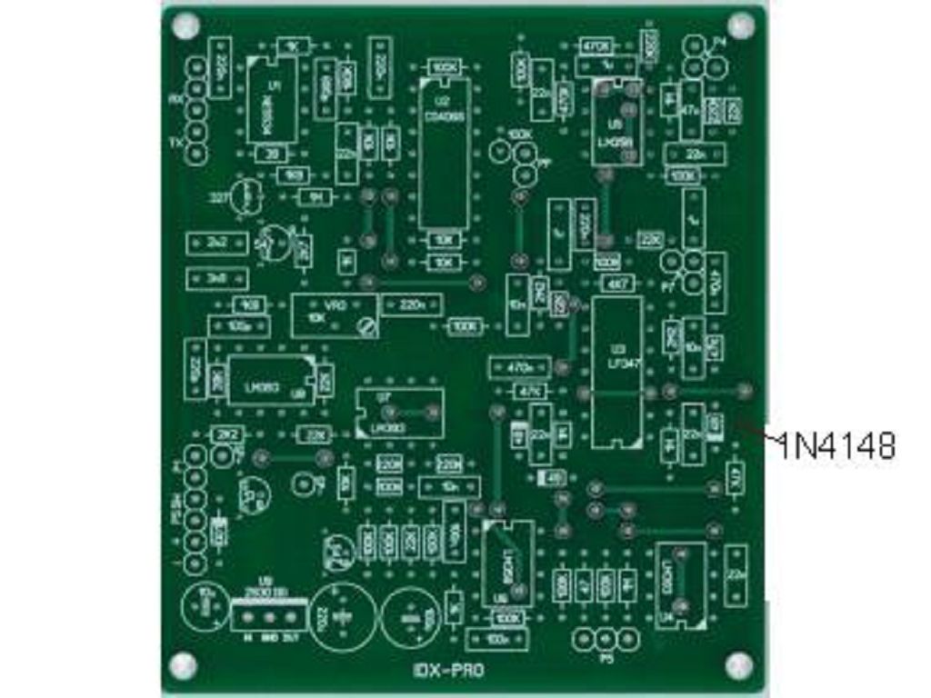

              Hi DAVOR,
              i have my kit from silverdog. It has a Schematic printed on PCB, but i belive the position of the zener diode is wrong, it must show in the other way...
              So what position is right?
              Firebox
              • Originally posted by Firebox View Post
                Hi DAVOR,
                Firebox
                If you are using a 1N4148 diode, the position marked on the PCB is correct. If you're using a 2V7 Zener diode, diode position has to be invested.
                • Thanks for the info @eduardo! then my 1N4148 Diode is in the right way

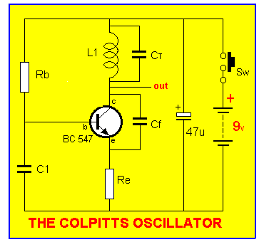

                            Rafal, I made my observation of phase shift for concentric by doing exactly what you have done. I was using a Blue Max 600 coil and observed a 90 degree phase shift. I will double check my results sometime today.
                            Also, others have posted 4900 Hz for RX, but in doing the calculations, 33nF & 36mH in parallel resonates at 4620 Hz so that was my target. That gave me the correct adjustment range for the GB and DISC.
                            Don
                            • Strange.. For example here is some info about XLT concetric works at 6.5kHz too, and it is 180 degree(sorry it`s not in english) but just look at photos:http://taktykpulse.com.pl/misc/Modyf...0XLT%20cz1.pdf I have 180 and everything: BG,Discrimination works fine,maybe it is the same.. anyway could you show yours Rx oscillator circut? Is this circut will by ok?, what about corect values of all elments Click image for larger version
                                Hi DAVOR,
                                Firebox
                                Eduardo is right. The other option is that your discrimination is set too much "on the wild side" and invites more iron. I recently learned that ferrous materials of very low conductivity tend to respond naturally in a non-Fe quadrant. If that is the case, you may turn your discrimination potentiometer as ever you want - it will stay there.
