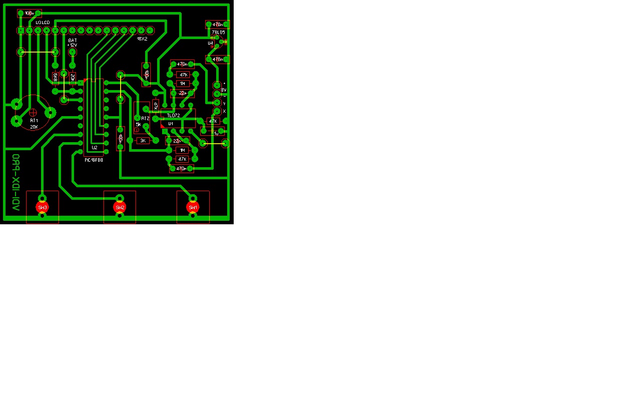

                        • Hi all,
                          I am making up the VDI BOARD at the moment and wanted to know how to arrive at the correct sized resistor for R2 which is the battery in circuit and goes to pin 2on the PIC?
                          • 6k8 ohm if you got a full accu, but it´s explain in the thread!?Click image for larger version
                            • I changed U3 to lmc6484 to lf347n. It so sensible. I changed the r25 too a trimmer. So I can adjust for more sensibility. A hungarian "20 forint" http://www.hamispenzek.hu/hamis_fempenzek_forint/20%20Forint%201994%20hamis%20hamisitvany.jpg comes from 40-45 cm. :-) Waohhhhh! It is fantastic... But! The of-key sign frequenter. I set up down the sensibility.
