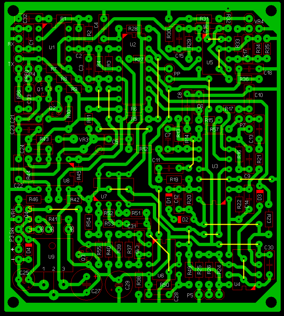

    Hello. I found this Russian forum of IDX-PRO PCB. The PCB had many mistakes and failures of some components. I corrected the PCB and added the missing components. I wish that we all take a look and give a chance on this project. Surely here in the forum there are people who would be interested in this project. I've also found the VDI file with all documentation. Please advise if there is any error in the PCB. I'll put here a video of this VDI I found on Youtube. Thanks for reading. Eduardo.

          Hello! All right, completely revised. Here I leave the edited file and guaranteed 100%. Shortly I will post the PCB of the VDI. Enjoy everyone.
            Excellent job!
            Although R27 could be placed a bit more "happier"!
            I am guessing it was planned to be SMT?
              Ivconic Thanks!. True, R27 is a bit misplaced, because it had no place to get more clues. SMD R27 may be no problem.

                  Maybe like this?
                  No need all traces to be 0.8mm.
                    Yeees. Tnks

                        IDX-PRO+VDI FINAL
                        Hello! After many hours of work have brought together all parts of the IDX-PRO. The project is 100% correct, both the metal detector, and the VDI. No errors, everything is checked thoroughly. Tomorrow I will start making the PCB-S. Enjoy the new project. Greetings to all. Eduardo.
