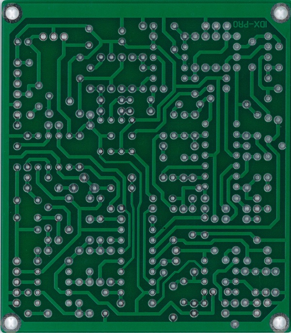

                • Ok Boards have arrived for the IDX to go with the VDI units added last week
                  I must stress at this stage everything is untested by me - I will add the pcb and kits to my shop as people have been asking for these for a while
                  Please understand there may be minor problems which could include missing components, or extra components supplied
                  I am trying to pull together some documentation but as with most other projects it is a bit sketchy
                  I have put together a partslist which I will use initially and will be building a unit from it as soon as I can to verify its accuracy
                  I will be trying to supply original components i.e. Lmc6484, Bc237
                  The partslist shows some alternatives
                  Thanks again to Eduardo and Holyuser for their great work

                        • Thanks for the first couple of orders guys, give me a couple of days to get them out

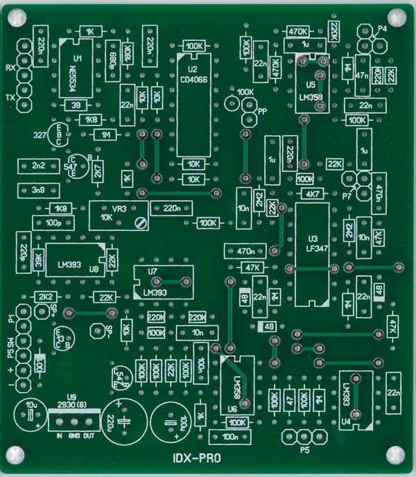

                          I started mine last night and found the partslist needs work !!
                          I made the partslist from the schematic, not realising there were so many changes
                          I'll hopefully correct it tonight and can then put some kits together
                          This is just the IDX pro Kits, VDI kits will go out as normal

                              Anyone have pin outs, I'm not sure about the shield and how best to connect to the pcb, I rather not cut the connector so will look to source a male 5 pin plug that will fit
                              • A bit of help required
                                Connected up the Whites shooter coil over the weekend to the IDX, no joy
                                I seem to have a nice TX wave but nothing on RX, as there is no cap on the pcb is it possible there is no cap in this coil ?
                                Eduardo could you explain what you set VR3 to ?
                                Maybe show more details of the coil you used and how you connected it ?
                                Connection points for the VDI would be useful too, although not diffcult to work out a picture is always good, particularly for amateurs like me
