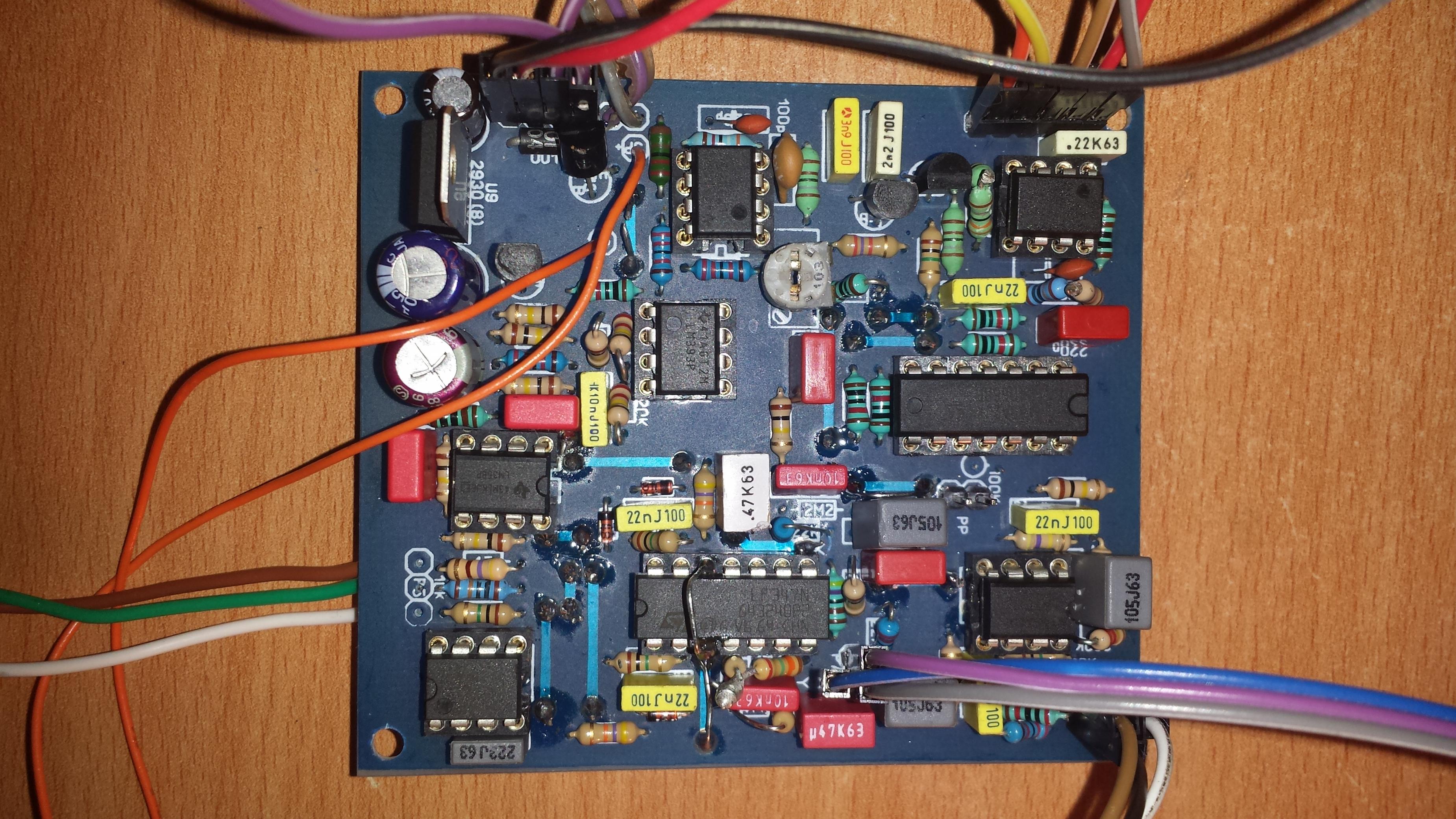

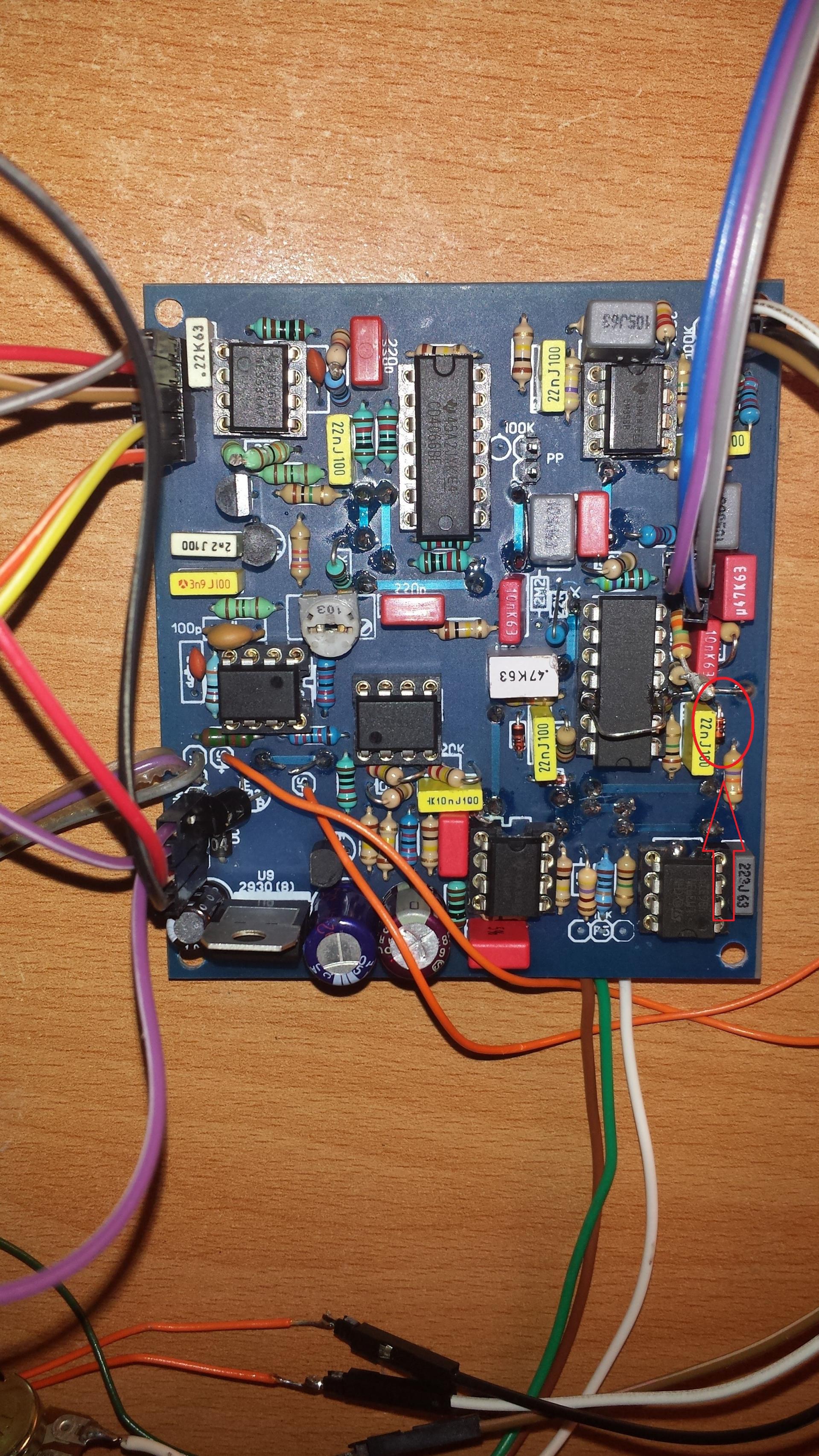

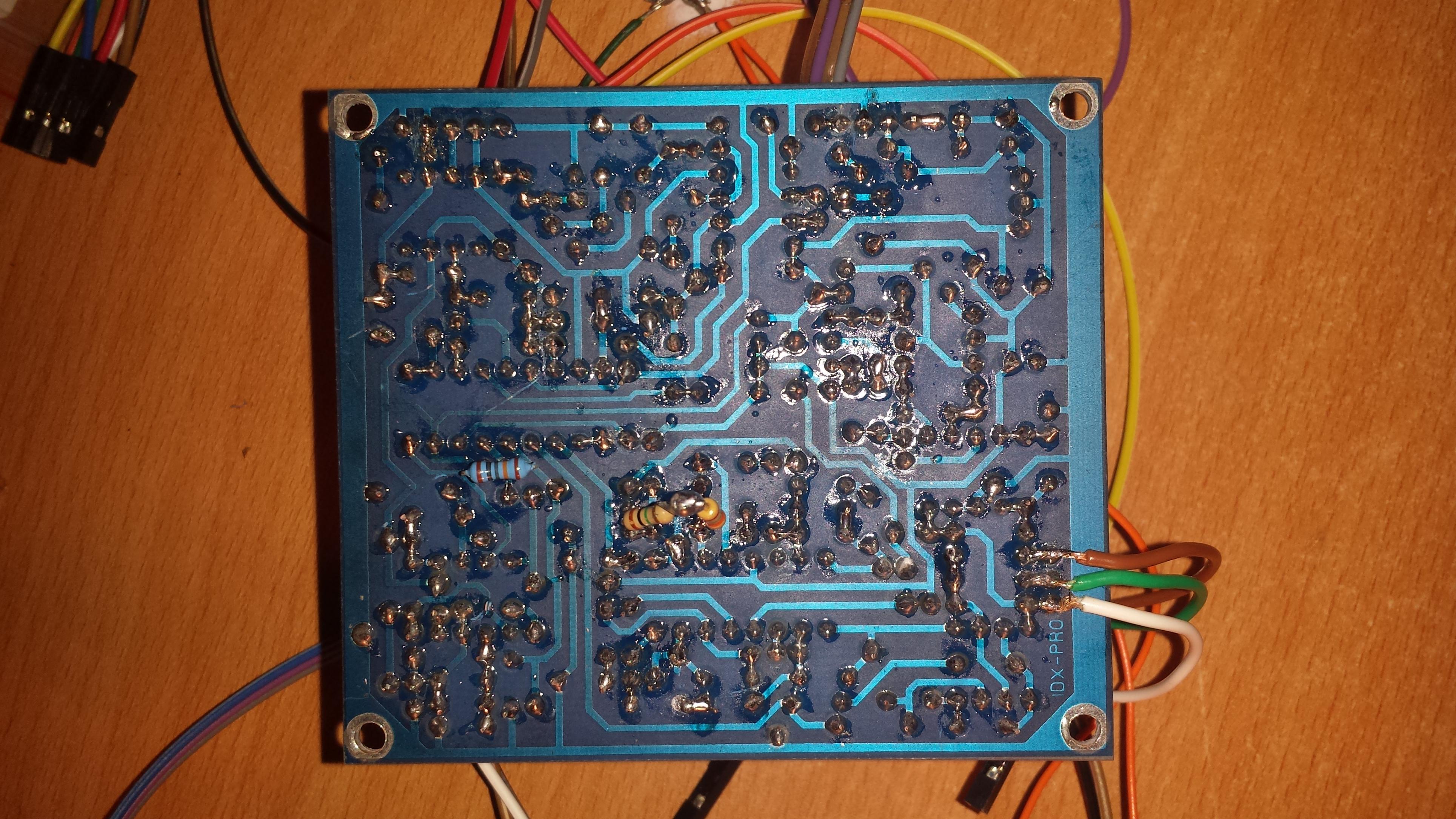

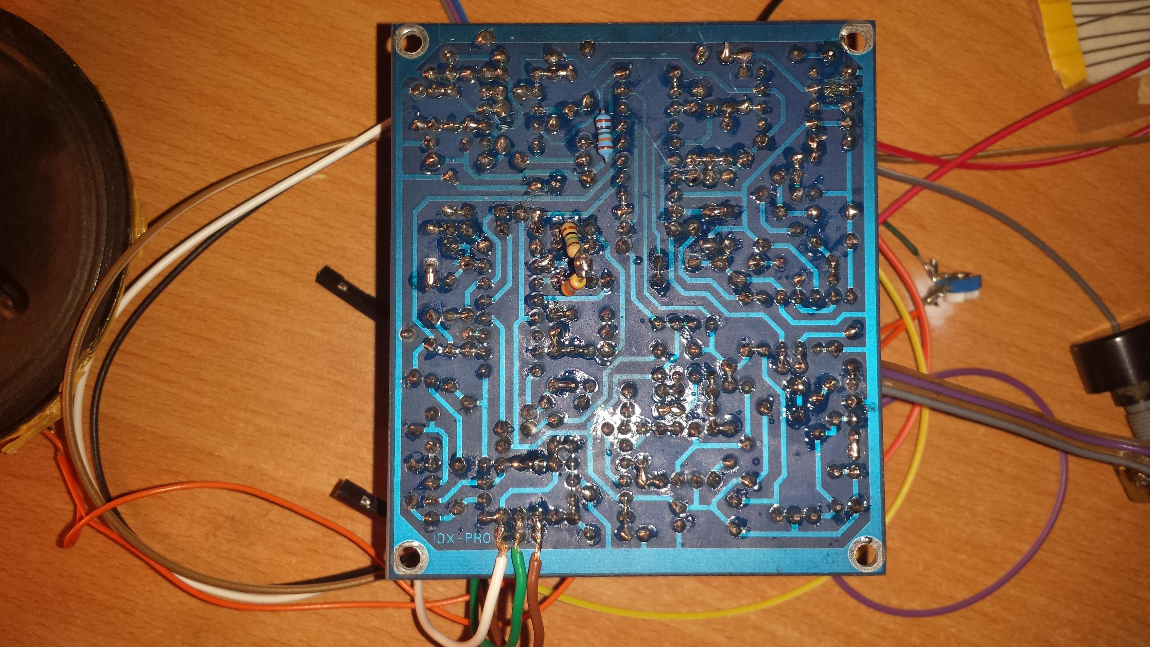

              • Now i have sound, coil is working (i didn't yet maked idx coil, im using coil from tgsl), but i have pulse signals like when we move something over the coil or like digging target, now mpsa 13 is cold, but U4 going hot after 5 seconds. I have replaced U4 and 4066, no changes, stil the same. Here is my pcb. Does this diode near U3 need to be reversed? Im using this lay file.

                • You don't have 100k resistor near to pp
                  • Originally posted by kaligula View Post
                    Look at soldering side...

                        Not important so much if 3n3 or 3n9, my problem was not in that section, i replaced U4 again and now is working. Not as expected, cause coil is from tgsl(for testing only). I don't have 0.7 wire for now.
