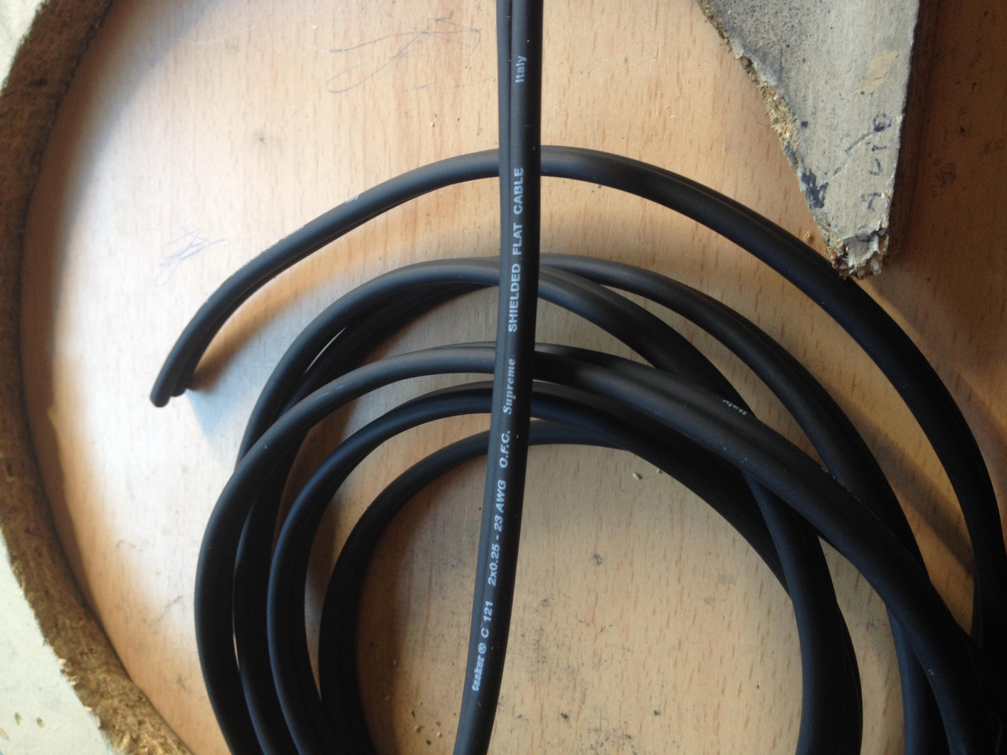

        • Originally posted by Emiliano_070 View Post
          [ATTACH]33613[/ATTACH]
          If you are asking if the cable is suitable for connecting the coil to box I don't know but looks okay. You will have to try it
          I have tried USB2 cables. One worked okay but felt week and the other was not stable when tapped appears that all USB2 cables are not created equal.
          I now only use 4 core Van Damme microphone cable. Very flexible so unlikely to break and no false signals even when dragged through stubble or long grass.
