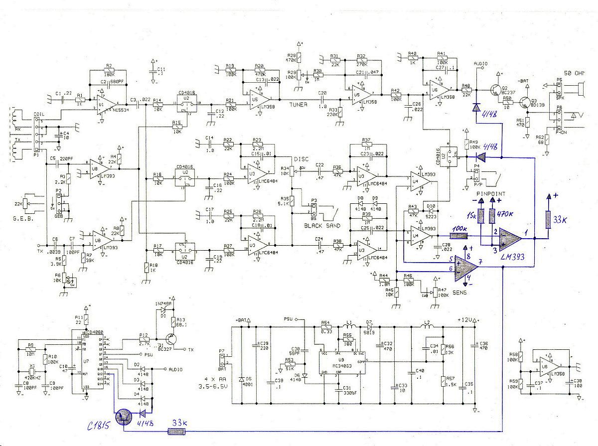

      Can you give me more info on adding two diodes?
      A Where you place these diodes?
      Is the 1N4148?
      VDI geotech module does not respond to a good distance.
      I 've realized the VDI lugatek module and I have a +45 display on steel.
      On the oscilloscope, the X and Y outputs are 400mV (PCB IDX)
      Can not set to 0 for aluminum, potentiometer 4K7 has no influence ..
      About VDI input schema, Somebody could tell me if this is an integrator assembly / diverter or differential amplifier ?
      What part I could change to improve reception?
      • You connect ADC0 to X and ADC1 to Y on the IDX board.
        Or, you can connect ADC0 and ADC1 to the Outputs from U3B p1 and U3D p14.
        The Diode(s) are on the IDX Board.

            • Please upload simulation Proteus for VDI
              • Will be soon. Be patient.

                  • Support 2 tones?
                    can someone tell me what part I find the way to put a switch for the 2 tones, not having to replace components .. is that I saw somewhere I've searched and can not find it .. I need if anyone can help me with part in the forum where it gets a switch for 2 tones?
                    • Here's a 2 tone mod that seems to only work in PP mode;
                      • I think that the Pin point is a bit of an optical illusion,, The Pin point text is for the Switch. Not the 2 tone mod..
                        • Well pin 1 of the 393 gets pulled negative so cuts off the 2nd tone when the PP button is pushed...
                          • maybe your right I cant quite work it out now you've said!
