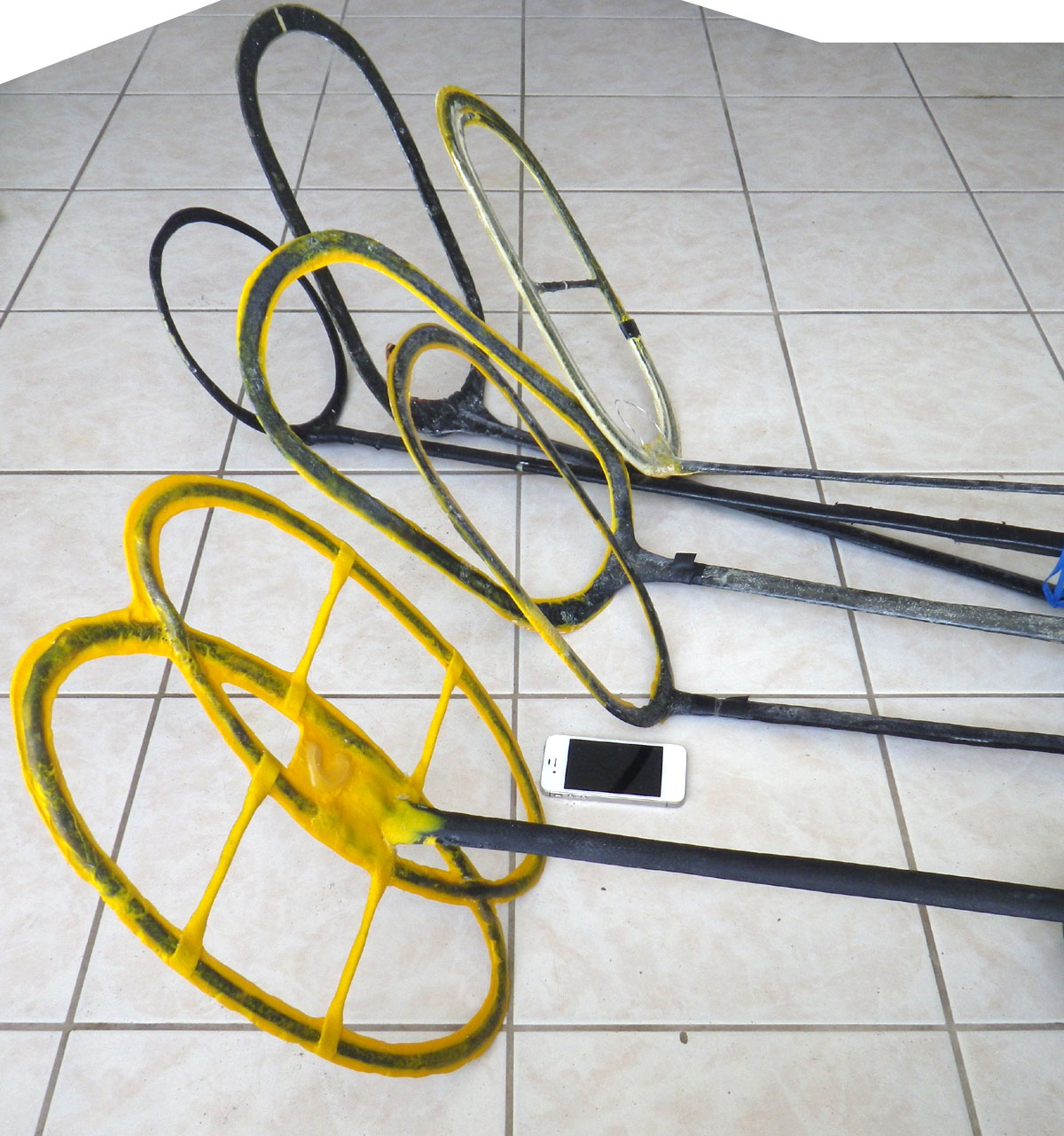

                      • NO SHELLS COILS FIBERGLASS OVER GRAPHITE SHIEL
                        Why to use coil shells at all? Without shells coil weights much less and you can build a really big coil.
                        Technology is relatively easy:
                        Wind coils.
                        Cover with insulation, for example paper tape.
                        Wind a spiral using thin silverplated stranded wires to connect a shield later.
                        Paint with graphite + epoxy 1:1 by weght, live 5 mm gap.
                        Wind by fiberglass
                        Put coil between plastic bags (epoxy not sticks to it) put in on something soft like towel
                        Pour epoxy (marine epoxy, no polyester please)
                        Cover with towel then put desk on top, than apply pressure several kg.
                        After hardening remove plastic bags and sandpaper results.
                        On picture you can see most of coils 17-18" long.
                        For DD/SEF/"8" coils left a wire loop to balance it when epoxy gets hard. Loop has to be connected to the grounded end of coil so it has no needs for shielding.

                            • Originally posted by Waikiki_Sweep View Post
                              Wind coils.
                              Wind by fiberglass
                              [ATTACH]28705[/ATTACH]
                              HI-Waikiki,,, I like your method very much Thanks I may give that a try ,it was you,, I think that put me onto the'' Micropore medical tape'' that tape is great & I used it on my DD coils with a mix of Graphite & nitro-cellulose ,furniture satin clear .drys very quick & sticks really well ..
                              Question do you wind a shield wire around the coils say 1'' apart ??? or do you use a single trand on the coil edge ???? I have it on the outer edge of my coil on top of the tape then coat graphite ..
                              Thanks for reply ,,,,,,,,,,,BARRY..
