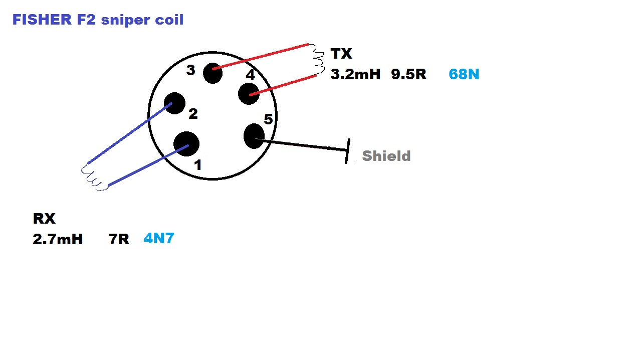

                      • Just tried idx with Fisher F2 sniper coil, all i can say it's working very good, coin's from 4 to 10 inches, disc and and geb also is very, very good.
                        Pin 1 and 2 is RX,
                        3 and 4 is TX,
                        pin 5 is shield,
                        RX tank is 4,7n
                        TX is from 47 to 68.
                        So, here is fast maked picture and video for anyone who wanna try the same thing...
                        https://www.youtube.com/watch?v=TW03siJ7pus

                            • Interesting that the inductances are not as White's and it still works well.
                              • Originally posted by NĂ¡ndor View Post
                                Idx is very tolerant about coil's, have another one pcb with Tesoro Tejon (SEF Detech Ultimate) 13" coil which is realy deep, more than 14" for coin's, exelent work trough mineralised brick.
                                Can also work with Minelab TS 1000 coil for Musketeer, my friend using idx with TS 800 coil (19 cm) but can't remember rx and tx capacitor tank.
                                For Tejon coil TX tank is about 330N, for RX from 10 to 12N.
                                Soon i will make fast video with Tejon coil.
