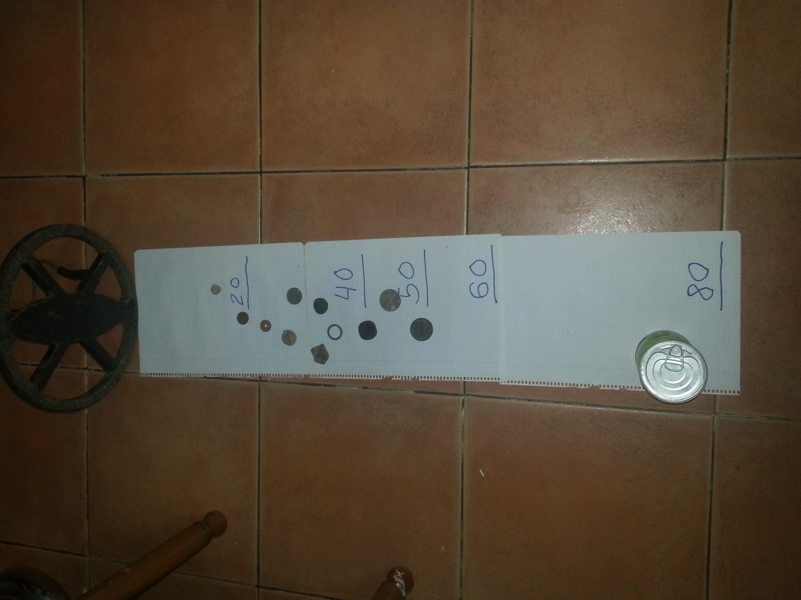

      • Help ! WATER registers only to 20cm, the greater the distance, no. Because, can you give me some reći.Koristim probe VhiteÅ¡ 950 Eclipse. Thank you very much !
        • Originally posted by paun019 View Post
          Help ! WATER registers only to 20cm, the greater the distance, no. Because, can you give me some reći.Koristim probe Vhiteš 950 Eclipse. Thank you very much !
          Try to play with TX - RX capacitor combinations, also check phase. Pin 6 on U1 is for nulling coil, get less than 100mv on that pin.
          Probaj da se igras sa kondenzatorima na Tx i Rx, i proveri fazu. Pin 6 na U1 je za nulovanje sonde, probaj da dobijes manje od 100 mv.
          • I set U1 pin 6 to 80 m and is a good tomato, 1 per 40cm, discrimination is good or VDI displayed euro to 20 cm, and still does not, when uključim RAW VIW: ON in this case, up to 40 cm or goes to -135, -148 and so a show and mineral stones +8. I do not know what the problem is. I tried to connect 2 tons and in that mode occurs as a mineral or iron is far less range. I do not have to set the parameters of the points but I see most here in the forum have a problem with IDX. VDI.

                I replaced LM393 in VDI and discrimination is now working well you know why I say ferrite rod that can not totally eliminesem.
ID:	345726 .papel iron aluminum is discriminated. what can be done for those cans
                  • Originally posted by onuba View Post
                    [ATTACH]36168[/ATTACH] .papel iron aluminum is discriminated. what can be done for those cans
                    Nothing as far as I know.
                    Same with my Tesoro also. In air tests
                      well done on sorting it out
                      Don't go too close to the coil with the ferrite 2" is enough. If you are running out of adjustment its normally the coil at fault.
