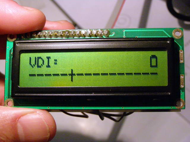

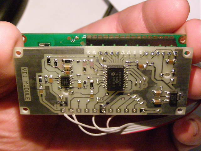

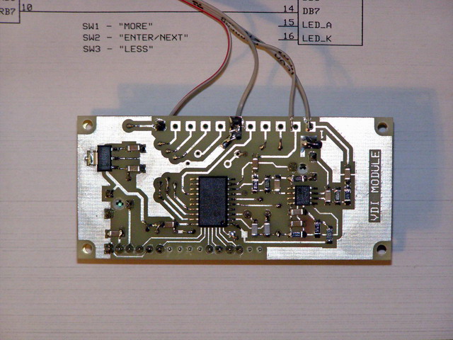

              • Some pictures of VDI version p690...

                        • Originally posted by holyuser View Post
                          As I promised, I did recompile the VDI using PIC16F690, specially by request of our friend reza2195 from Iran.
                          dear friend,thank you very much for your hard and good job.
